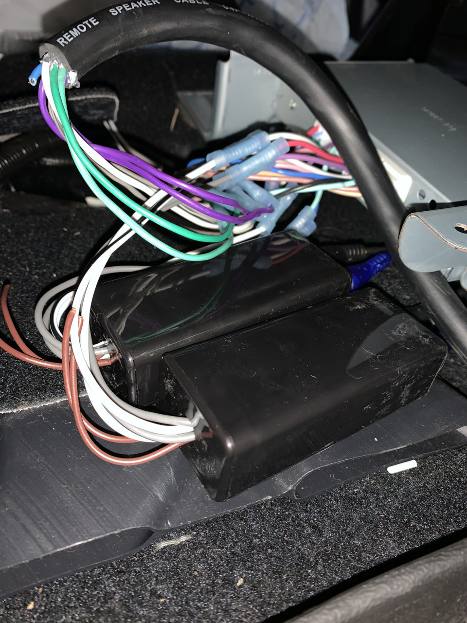

    Doesn’t sound right. Has a loud hiss at 0 volume. Front 6x9s have no midbass to them and sound muddy.
    The back door speakers are way louder than the front also. They actually sound decent.
    He ran the line out converters from the FACTORY amp signal it looks like.
    When I unplug the factory amp harnesses, only center dash speaker works.
    That tells me he took the signal from the head unit, to the factory amp, to my aftermarket amp.
    He told me to come back and he’ll fix whatever but I’m just looking for advice on what to tell him where he screwed up.
    The factory amp shouldn’t even be still hooked up right?!
    This is on a 17’ crew max non jbl

    No offense, but that looks like some serious amateur ghetto wiring there. And those "line out converters" do not look secured.
    Anyway, the OEM dash speakers run directly off the OEM head unit and are not wired to the OEM amp. So that would explain hearing dash audio even though you may have the amp unhooked. Is it possible that your stereo guy only hooked up the new amp to the rear speakers and the OEM amp remained hooked up the to fronts? That would explain the volume disparity between the front and the rear.
    I'm not sure why you would even want to use the factory amp for ANYTHING, if you are going to use an aftermarket amp instead. The "line out converters" could, and SHOULD be hooked up directly to the OEM h/u. And if that were my system, I would go with an better audio processor like a AudioControl or something of that nature. Those line out converters are manufactured by who?
    Anyway, without a wiring diagram, I certainly cannot make heads or tails of what is going on from your pictures. If I were you, I would remove the OEM amp outright. Matter of fact, I would gut the entire damned system and start over. The OEM door speakers are utter shit. And the hiss: does it get louder with higher RPM's? If so, then you probably have a "ground loop". Looking at that wiring job, I wouldn't be at all surprised if the appropriate gauge wiring was not used or properly grounded.

    • Factory amp front outputs will only send lows/mids to the doors, so if he's tapped the *output* side of the factory amp for the high-low converter, that's all you'll be hearing, rears send full range (IIRC)
    • For the rears being louder, that should just be a gain adjustment on the aftermarket amp
    • The center dash speaker (and corner dash speakers) are wired together, and are powered directly from the headunit
    • I would suggest switching the amp for the door speakers to one that can accept speaker-level inputs, instead of dealing with high-low converters
    • It bothers me more than I can describe that he has the wires from the speedwire wrapping around the inputs to the high-low converters. I understand this is purely aesthetics
    • Personally, if you paid someone to do it, this is abysmal

    wow. If you can get your money back I would. This person claims to be a car audio professional? That is a hack job and a half.

    I appreciate that man! Basically the guy wasnt going to give me my money back without charging an arm and leg to take it out.
    Told me that you HAVE to run the signal off the factory amp cause the signal wasn’t strong enough to run it to the amp by the head unit alone.... yeah, lesson learned. Next time I’m doing everything myself.

    Run rca's from the head unit to the amp, installer probably set it up using the factory speaker wires so you'll be done with it.
    Take a pic of the jl amp and how it's wired.

    The round black speed wire in the pic is what is coming off the amp now. I gotta figure out how to bypass the factory amp now when I put the head unit in

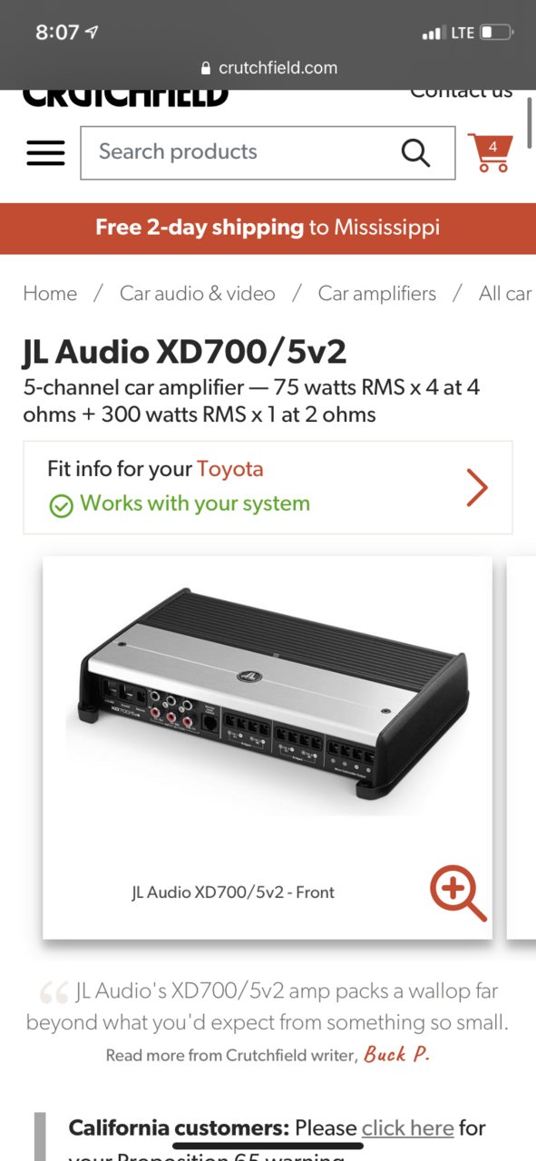

    What model amp is it?

    That's a good amp, so you've got that.
