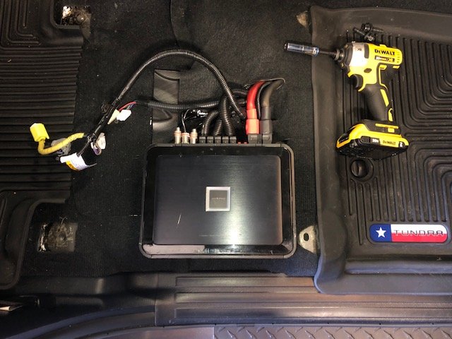

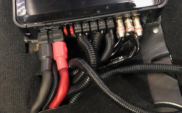

    This is what your under seat amp set up should look like.
    Although I guess you have a distribution block somewhere for your sub amp.
    The factory amp should be gone and every connection be plug and play, meaning you can put the stock stuff back in the truck if you trade or sell it.
    It would take me a couple hours or so, but I can return my truck to stock audio if I every got rid of it.

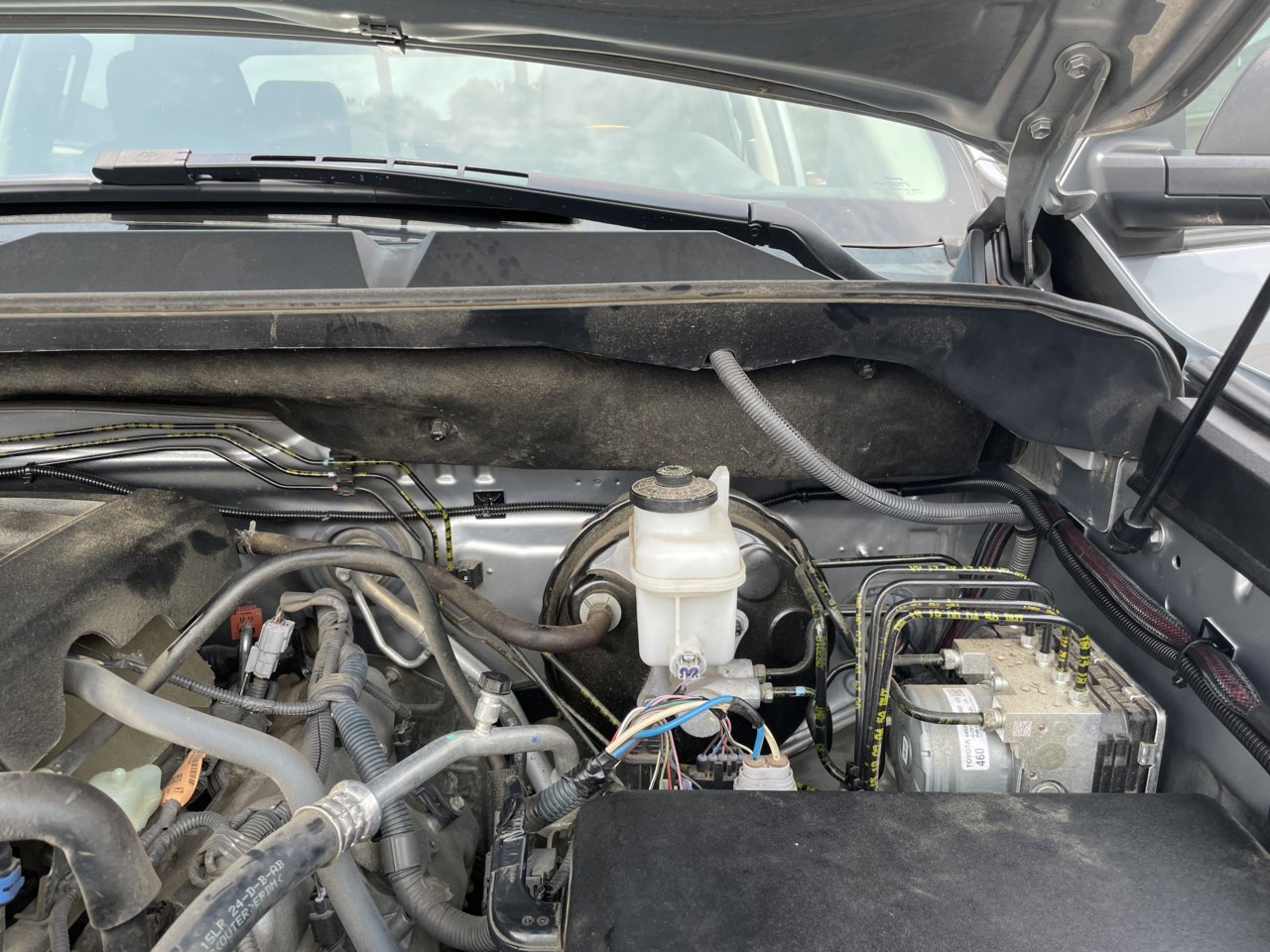

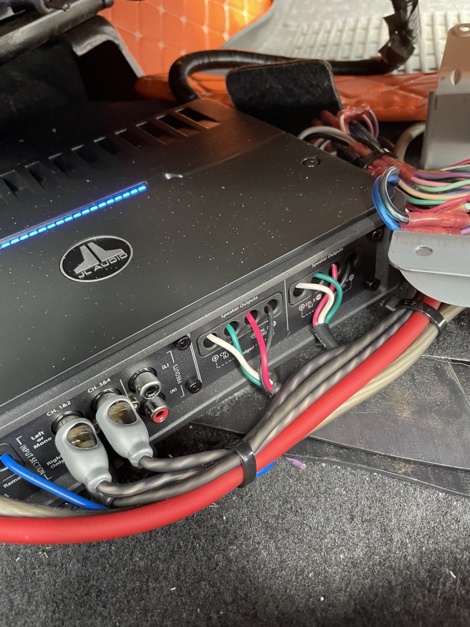

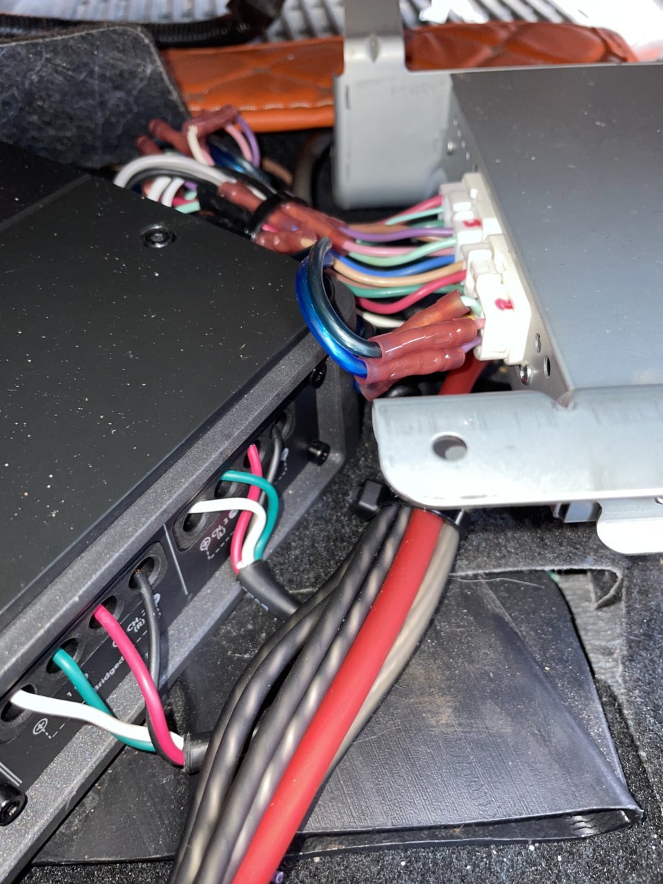

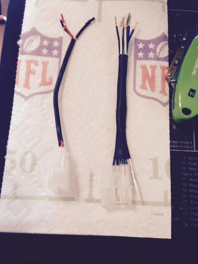

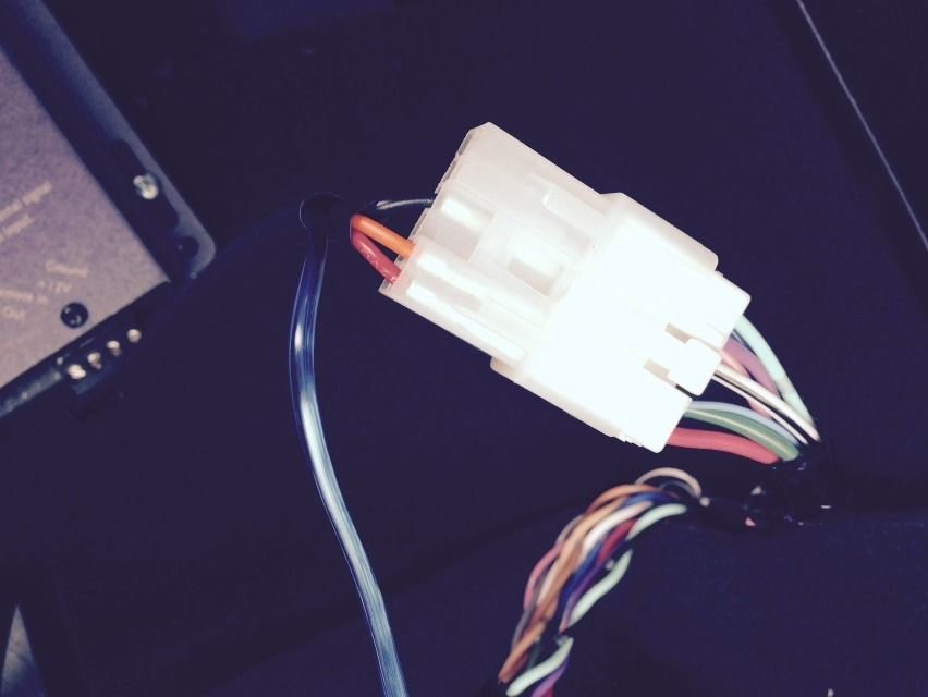

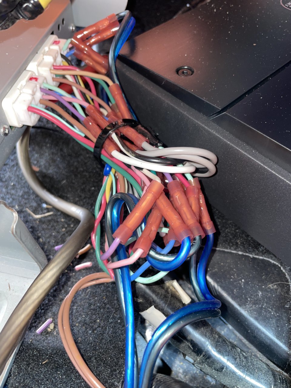

    Here is some pics of what they did under the seat. They also disconnect the dash speakers from the hu and connected to amp. And disconnect my center dash speaker.
  11. Jul 28, 2022 at 10:25 AM
    #41
    Danimal86
    Aug 29, 2017
    #9321
    4,999
    Daniel
    Sacramento, CA
    2017 White Tundra SR5
    Once you add an amplifier, you need to disconnect the dash speakers. The dash speakers as mentioned earlier are powered by the head unit itself, so you will have a volume miss-match between the door speakers and the dash speakers.
    In all honesty, i've seen worse installs than this (just talking the install, not the fact that it sounds like crap). If it sounded good and they would have just made an amp rack so that it wasn't sitting all crooked, it probably would have been fine.
    Its kinda hard to track whats going on here with the factory wiring going into the factory amp. It looks like they clipped some of the wires pretty close to the plug.....fuckers!
    Ideally they would have used a wiring harness like this (i got mine from Tech12volt) to utilize the factory wiring without chopping it up.
    c9bie0Mxy9HOq7aFea7Zvq3XYPSxsj1NVAoafkpN_9963c95b5e4563d2a548af49b7a189cdaf94c819.jpg
    In reality, probably not going down this route anymore, it will be pretty difficult to try to get those short wires back to the harness.
    It depends on what your comfortable with doing, we can help walk you through it as much as we can, but if you aren't comfortable with it, then find a shop to fix it. Everything that they've done can be undone pretty easily.

    Looking at those pics literally pisses me off. :mad:
    What a bunch of hack a-holes.

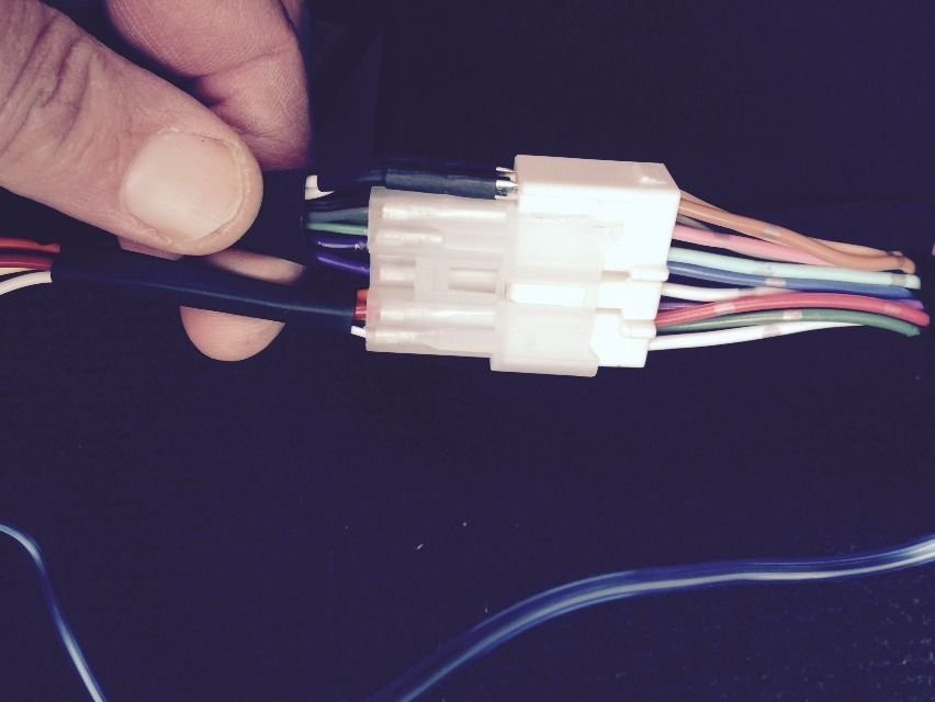

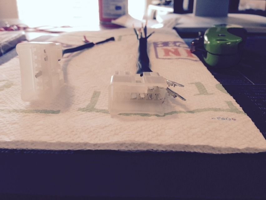

    All they needed to do is use this adapter and not cut a single OEM wire.
    These connect to the plugs that go into the factory amp, bypassing it.
    Gives you loose wires on the other end to attach to whatever you need.
    AutoHarnessHouse
    Back in the day we had to MAKE our own adapters..:D

    They left all the striped ends in there and didn’t even clean it up. Why did they cut it so damn closed to the plug? Hacked job.

    Honestly it would of been easier, faster , and less work if they had got a harness and did it right.

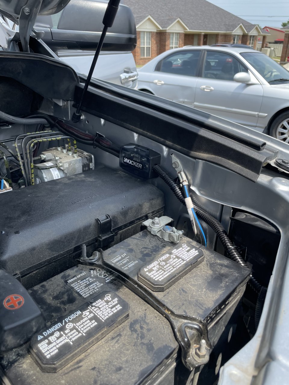

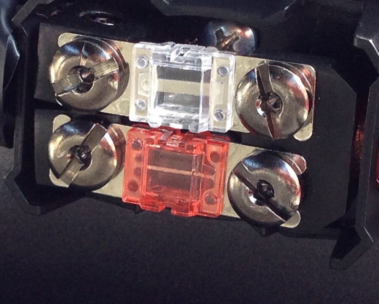

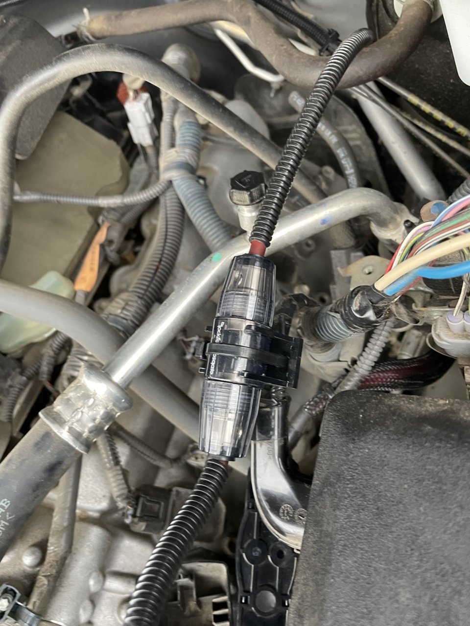

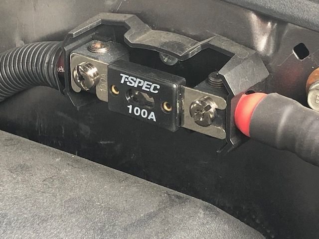

    how about attaching the fuse block to 4 wires coming from a harness and on the other side of the block attached to a single 16 or 18 gauge wire. Flopping around with every bump. What could go wrong.
  25. Jul 31, 2022 at 6:36 PM
    #55
    1lowlife
    1lowlife New Member
    May 4, 2016
    #3296
    11,253
    DADA
    THE GREAT STATE OF TEXAS
    2014 MGM DC SR5

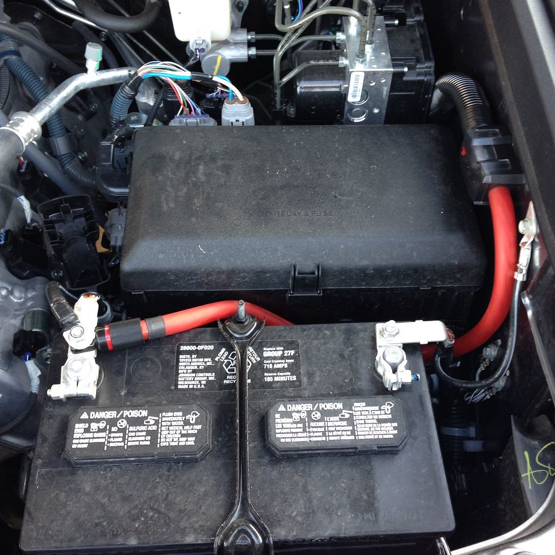

    That looks like your amp power line fuse.
    It should have been mounted to the side of the firewall to the right of the fuse box.
    It should look more like this..
    At first, I had 2 4 gauge lines from the battery, the 2 fuses..
    27FC8FDD-7327-4855-B1B4-161405B057F4_zps_d21cbd839e95242b7cca801bd4f6d24c40ebf406.jpg E56AC200-362A-4566-8FDF-EBCE9FDE0AD3_zps_685dceb9da4e5805734377cd61a96b6de14e0398.jpg
    I now have 1 0 gauge line to my 5 channel amp with the 1 fuse..
    I also did a 0 gauge ground from the battery to the chassis.

    That shop really is a big hack business.
    What they did was a lazy install all the way around.
    They had no idea of what they were doing as far as Tundra (Toyota) installs.
    If you are on Facebook, you need to plaster these pics and your story all over it and let people know what a shit job they did.
    You can post it on Yelp as well.
    The job they did is truly unacceptable.:(

    You cant be serious? How is it remotely possible that you go to them and ask for a new system and the supposed experts do this to your truck AND ITS YOUR FAULT !!!!!
    You all see this - Is there anyone close to him that is experienced with audio installs, that can go visit the manager at this shop and spell out what they will do to make this right, OR ELSE !!!
    I really hope you can get all this corrected with the help of the fine folks here on this forum. Reading your post just makes me ill. I cannot image what you are dealing with.
    But be assured, this will be corrected and you will be in a better place. The folks here are absolutely the best....

    I redid it myself today. It just really blows my mind. I had a little extra money and didn’t want to deal with it this time. This is the first and only time I’m paying a (professional) to do something I can do. I’ll just go behind the and sweep up their messes.

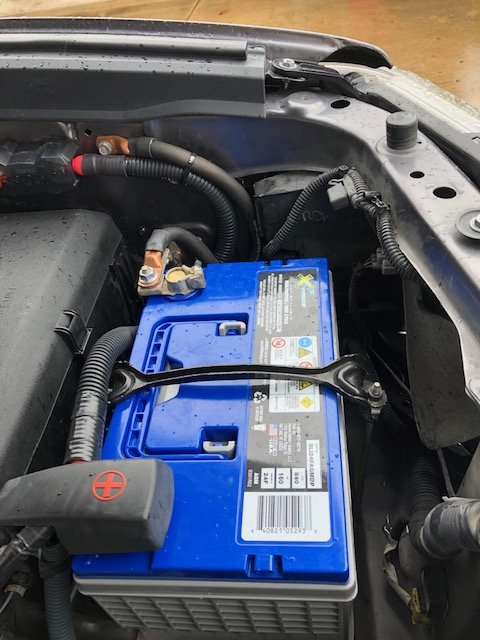

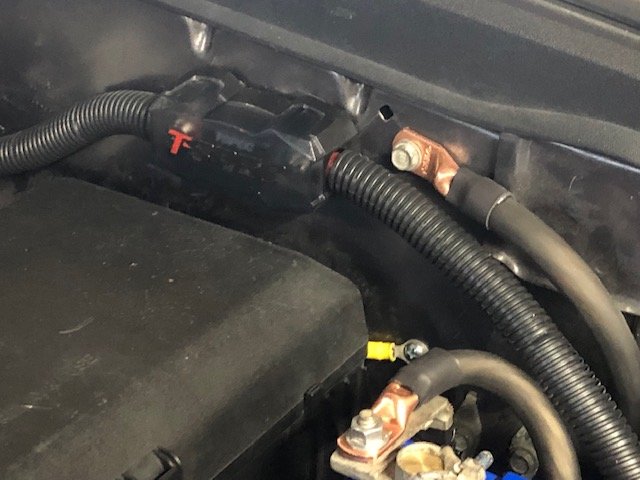

    73F0B09A-BE8D-43C8-80DC-EA2318F60500.jpg CBB1AA26-8A9B-4CEC-9373-452A6AE6B3E7.jpg
    1lowlife[QUOTED] likes this.
  29. Aug 2, 2022 at 7:46 AM
    #59
    Danimal86
    Aug 29, 2017
    #9321
    4,999
    Daniel
    Sacramento, CA
    So much better!
