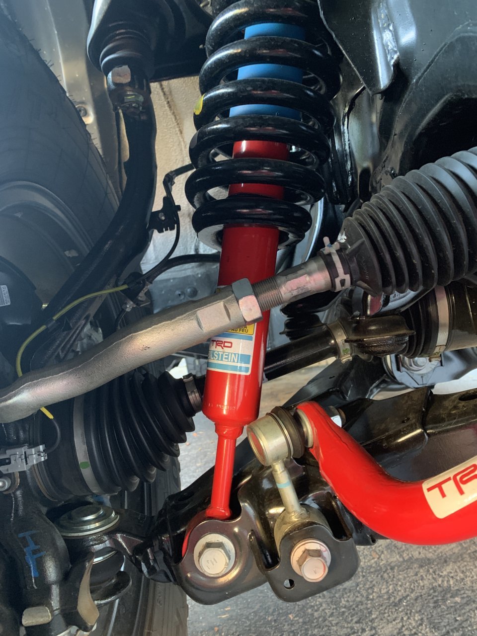

    image.jpg would this suffice

  6. Sep 28, 2019 at 5:03 PM
    #36
    Rica25
    Dec 6, 2017
    #11380
    5,553
    Ricardo
    Tulare
    What about upper part of the shock
    OR18TRD and SoCalTundy like this.

    Tulare

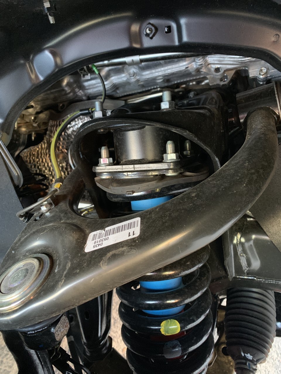

    OR18TRD and Rica25[QUOTED] like this.
  12. Sep 28, 2019 at 5:07 PM
    #42
    Rubberdown
    Rubberdown Spilling my guts here.
    Jan 23, 2019
    #24972
    1,231
    Although that’s a fancy trd sway bar.
    Yeah that looks like a 3 inches. You will be maxed out on your adjustability. So... to resolve you either remove the lift, or buy some upper control arms. The dealership is obviously going to keep screwing it up. Find a good independent shop to do the alignment.

    So they went the cheaper route with 3 inch spacer

    Just have them remove the spacer and do the lift the better way with coilovers and shackles

    Yup. Cheapest lift possible. Spacers on top and stock UCA. I suppose those shocks can handle the spacers on top for a while. I did spacers on mine and my shocks died after 10k miles. I ended up swapping out my suspension with quality lift shocks and got rid of the spacers. For now, you most likely need the UCA or have the dealer put it back to stock. Gonna cost you $500-$1100 installed depending on which UCA you go with.

    Zero worries. Every answer here is or will be helpful. Every answer so far is more accurate information than your dealer has given you yet and it’s been twenty minutes on the forum versus days with the dealer.
    We will get your lemon fixed. The answer is already here. Upper Control Arms are necessary at three inches on the Tundra.

    That looks like the ReadyLift kit. Spacers kits are common and good for onroad use, but don't do any type of heavy offroading with them. They are commonly purchased for leveling and clearance for bigger tires. I currently have the Readylift in mine. Maybe Santa will get me some coilovers and shackles.

    I respectfully disagree with you here. Nobody is being dramatic just helpful. At 3 inches, he will need UCAs, no way around it. You might get close but you’ll still have issues with alignment and uneven tire wear.
