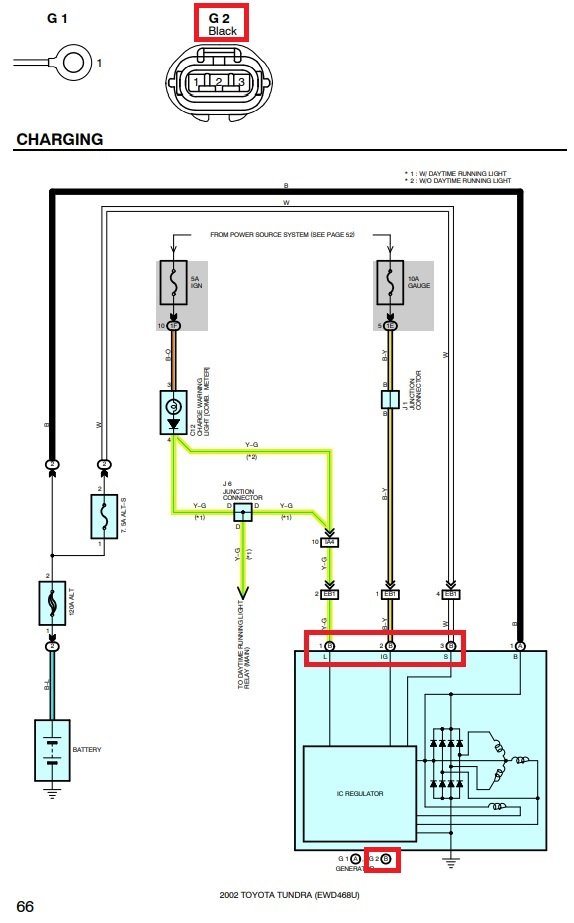

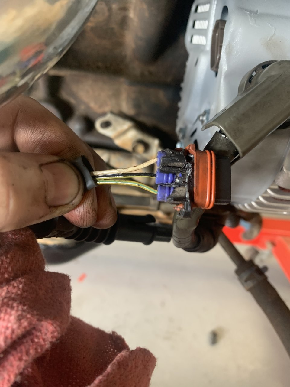

  25. Jul 25, 2022 at 5:25 AM
    #205
    Brynden29
    Brynden29 [OP] Just a guy who works on cars
    May 16, 2020
    #46632
    355
    Brynden
    Bellville, TX
    1999 Mustang GT
    I am pretty sure that this is the way the connector plugged into the alternator.
  26. Jul 25, 2022 at 5:34 AM
    #206
    dbittle
    dbittle Middle Age Member
    Aug 10, 2020
    #50632
    244
    Huntsville AL
    2006 V8 RCLB 2WD
    I just thought of another possibility to check, which is throttle position sensor. As it slowly fails, it will create an intermittent misfire that appears and disappears and drives the owner insane. If one bank is a little leaner/richer than the other, maybe the TPS fault could manifest on the one side preferentially. On my little civic, it drove me nuts for months before it finally set a code and bailed me out.
    Brynden29[OP] likes this.
  27. Jul 25, 2022 at 6:33 AM
    #207
    BubbaW
    Aug 19, 2019
    #34845
    3,755
    Bubba
    Where Eagles Nest
    04 DC LTD 4X4 4.7 V8
    T150 Lover
    According to the 2002 EWD, it appears to be correct if that flat side of connector in your hand goes downward in the plug I see on the Alienator/Generator.
    FrenchToasty likes this.
  28. Jul 25, 2022 at 6:53 AM
    #208
    FrenchToasty
    Sep 15, 2019
    #36156
    18,344
    Mo
    The SoAz….. big surprise
    Bone stock
    Usually the rubber grommets are recessed into what should be the plug, maybe it’s not fully seated on the pins when it’s connected
    BubbaW[QUOTED] likes this.
  29. Jul 25, 2022 at 7:47 AM
    #209
    Brynden29
    May 16, 2020
    #46632
    355
    Brynden
    Bellville, TX
    1999 Mustang GT
    I guess it is an easy test, just unplug the alternator and start it up. Of course if the ECU is damaged it won't matter.

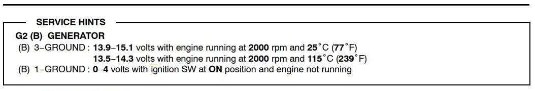

  30. Jul 25, 2022 at 8:14 AM
    #210
    BubbaW
    Aug 19, 2019
    #34845
    3,755
    Bubba
    Where Eagles Nest
    T150 Lover
    You could check the voltages at harness connector pins 1(Yel-Grn) & 3(Wh) to GND according to below checks.
    Side Note: if you have it unplugged and turn IGN ON/ENG OFF, you should see the battery indicator light lit on Instrument Cluster signifying a Charge Warning.
