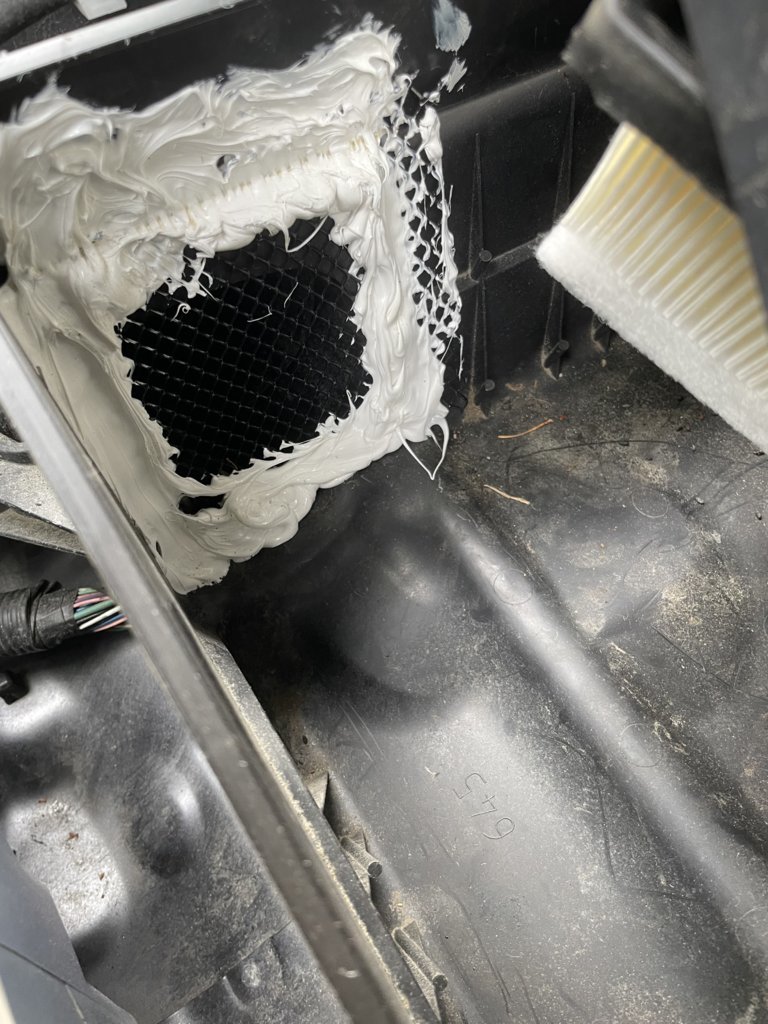

    I've had a plug-in ultrasonic mouse repeller on the garage counter for a few years and thought I was protected. The other day I started seeing some droppings on the counter so I put out a trap. Sure enough, it caught a mouse right next to the repeller.
    Plus, I've had some chip and dog treat bags in the truck eaten by mice with the truck in the garage.
    After reading this thread I went ahead and blocked off the air inlet with Multi-purpose Galvanized metal lathe from Home Depot. I didn't block off the holes you other guys did, though. I formed the metal lathe to fit right inside the air inlet above the cabin air filter. I held the front in place with a couple screws and then glued down the sides of the lathe so it wouldn't rattle. On second thought, I should have used 2-sided molding tape to hold it down.
    A couple questions I have: is this the only place the mice would be getting in to the cabin? Is there a way for them to get past the cabin air filter? Like, have I solved the problem or do I still need to block off all the holes you other guys did?

    I blocked all the holes, and have been mouse free. Leaving my door open for the night even seemed to have worked in letting the previous tenant escape without smelling the truck out.

    The mice will still be able to get into your cabin if you don't block all the other holes in the firewall. Don't forget about the one on the D/S behind the wiper motor, that one seems to get missed sometimes. Good luck.

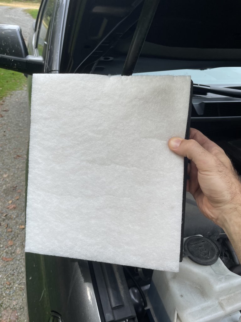

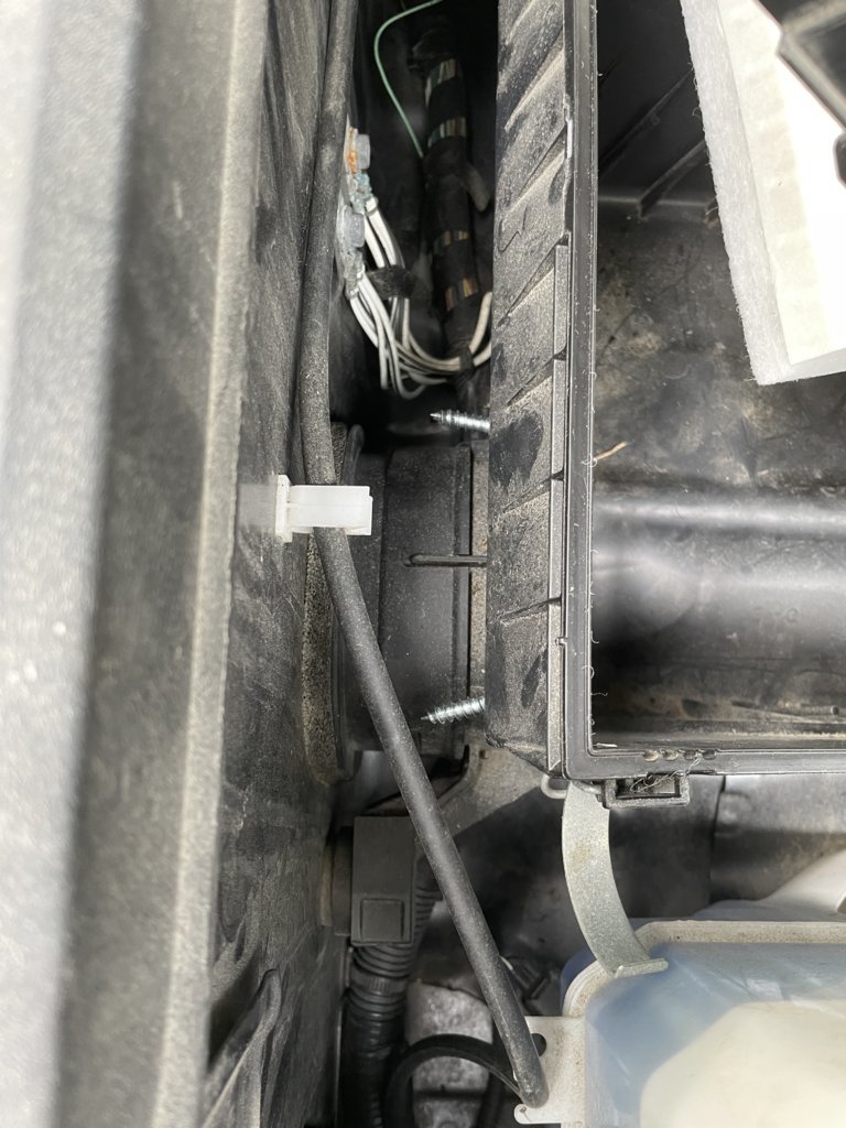

    After blocking off the cabin air inlet, as above in post #76, I got to the cabin air filter. It was dirty and may have had the odd turd but it was intact. There were no hairs or signs of a nest either.
    I don't understand how a mouse would have gotten into the cab of the truck through there if the filter is intact. Is there a way around the filter?
    I cleaned everything out of the truck and there were turds all over the floor and behind the plastic panel behind the back seat, where the spare tire tool kit and jack are stored. There was a small nest in there made of the same grey insulation I see in that area. From what I can see that is a sealed area- there are no holes or perforations of any kind in that whole panel for a mouse to get into or out of. I checked the air vents on the outside back of the cab and they appear to be intact as well.
    WTF? How is a mouse getting into the cab &/or behind that panel? Any thoughts?

    I just saw your reply. So there are ways into the cab other than the cabin air vent, eh? I'll block off those those other holes then. Thanks.
