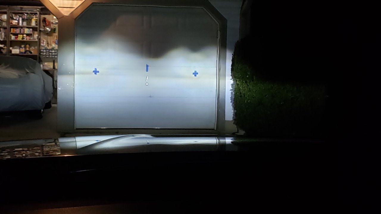

    Thanks, Brandon. This is what it looks like.

    Looking good. Look like u got the driver's side spot on. Just need to raise the passenger side. You dont need the side to side adjustment. The hotspot is in centered of your mark on the garage.
    Depends on what you prefer, the staggered cutoff or straight 1 line cutoff. You raise the passenger side top cutoff line to be even with driver's top cutoff line. This will give you a straight line cutoff or single cutoff appearance

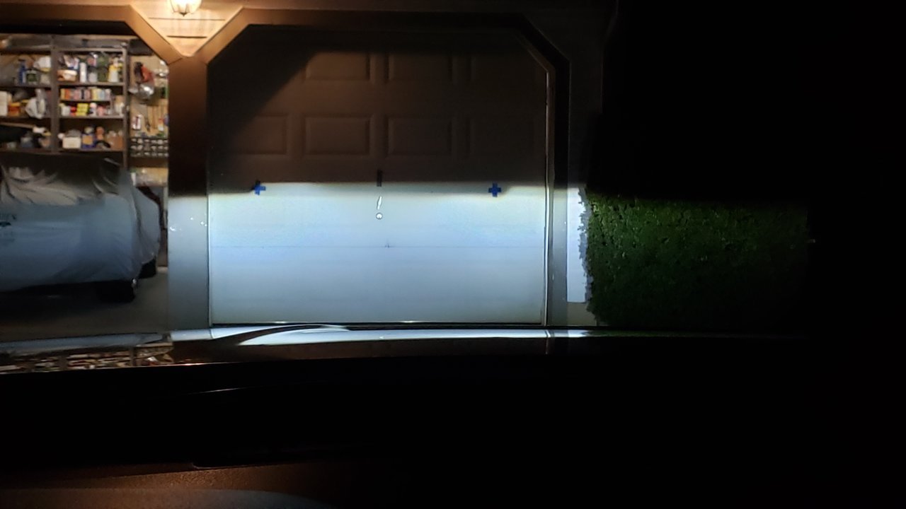

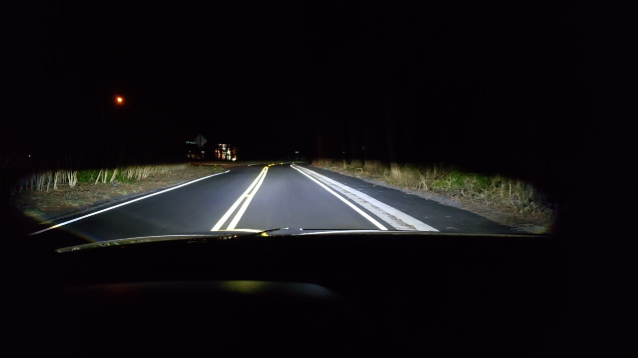

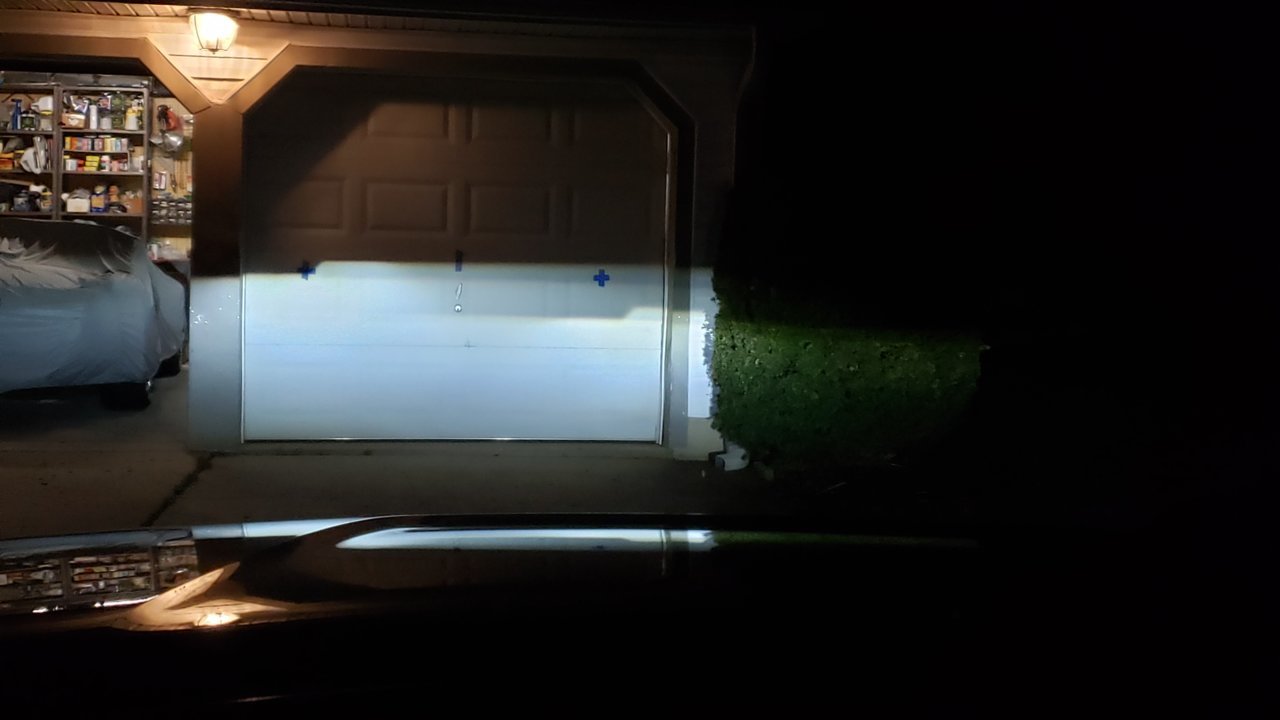

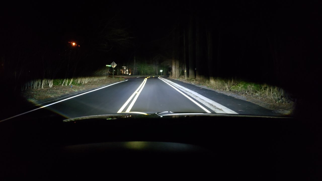

    Here is the final result. I am pleased, even after a month of frustration. Thanks @Tundra234 and @BrandonL812 for your help. Morimoto fog lights get installed tomorrow.
    Low beam
    High beam
    Low beam
    High beam
