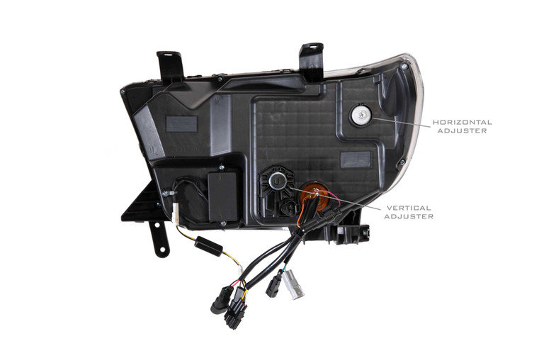

    Is there a way to adjust the headlight beam left or right? Mine seem to be pointing towards the right side of the truck...

    There is a horizontal adjustment on them.

    Morimota must've change the design. I have the '13 Sequoia that uses the the Tundra lights and it does not have the horizontal adjustments. It's fixed based on the factory settings.
