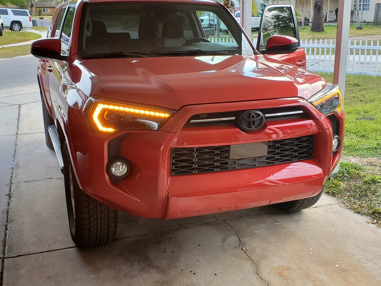

    Well said! I had XB's on my 13, and now I have them on my 2020. Just put a set on the wife's 4R as well.

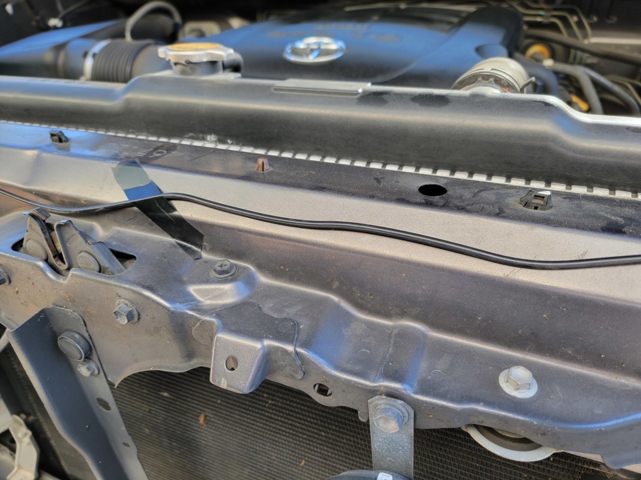

    Where has everyone layed the DRL wire that goes to the passenger light. Need to clean mine up

    There is a harness on the underside of that support where you have it taped to. I ziptied mine to that harness.

    Perfect, thank you.
