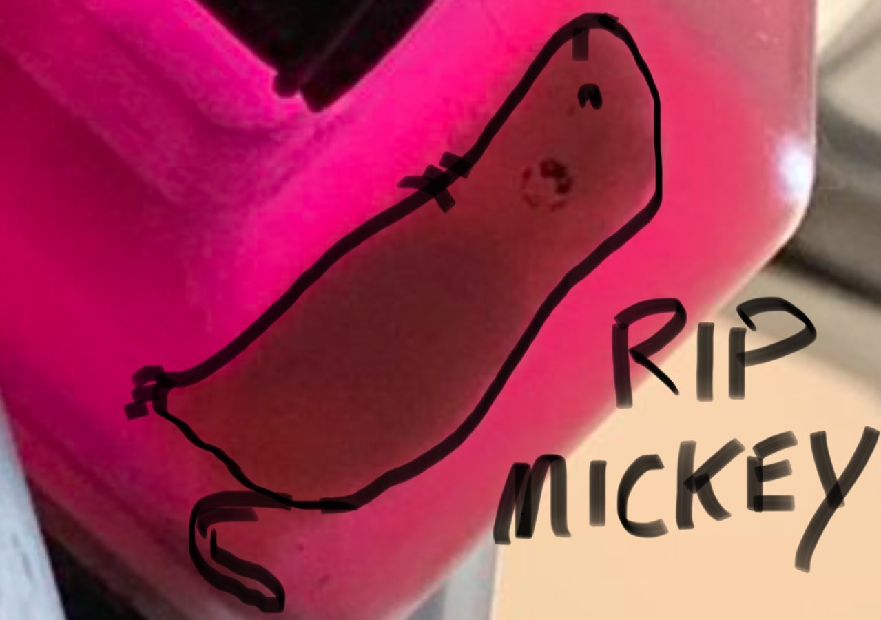

    upload_2020-8-25_19-43-49.jpgupload_2020-8-25_19-43-49.jpg Any idea guys if this is engine oil. My oil is clean

    That's a dead mouse homie.

    No maus should go so thirsty as to desperately leap into a coolant recovery tank for refreshment.
    In all seriousosity... flush and fill your cooling circuit, yo. Oil floats.

    Mickey got fat. You guys stills think it is normal or crapped out head gasket. This pic was at normal engine temp. upload_2020-8-26_14-29-15.jpg

    Whoa! Thats gnar gnar.
    I’ll link you over to the Turd Gen Section so maybe they can help. Our 1st Gens never have problems like the newer trucks have. We have to create problems with our trucks around here. :rofl:

    Drive it on the highway then check. If it's gone it's normal

    UPDATE.
    After flushing this is what came out. Felt like rust Or sand consistency.

    It dis not go away after driving. I hav not ever flushed the coolant system. This was first time. Now it is much clearer looking coolant , of course pink but more Transparent.

    Normal Engine Grit from aged coolant. I had some of this in my reservoir tank that coated inside. It didn’t mouse up or bloat like your pics. It was a grainy speckled texture when I flushed the system. Good job on flush and refresh.
