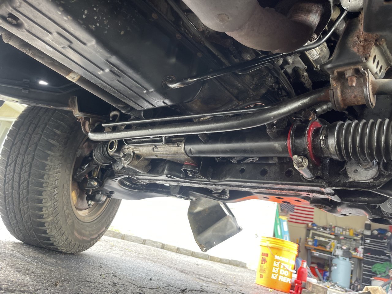

    UCA went on easy enough. Had to move break lines for bolt to come out.
    LCA. We’re a pain. But came off. I DID NOT MARK the adjustment. And that’s the one thing I wish I did before replacing cam bolts/sleeves.
    Steering rack. Was definitely difficult. Make sure to move small screw holding line down. Absolutely no room for top bolt. You have to loosen a little with wratchet. Then use a fact get wrench. Bushings went on good. The one closer to passenger side. Make sure opening is facing down. I actually used the cam bolt sleeve to get bushings out. Bushing near drivers side. Don’t forget washer. It would also have helped if I put the damn bolts in zip lock bag and tagged them!!
    Passenger side axle wouldn’t come out. I ended using the cam bolt sleeve as well. Worked well for me due to the wide flat spot to hit.

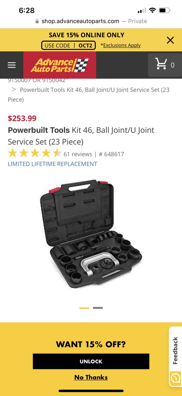

    I used a press from advance auto. I needed it to get upper ball joints out and did not need it for lower. This is the correct kit with all attachments. You pay deposit. And get it for free for up to 30 days. #648617

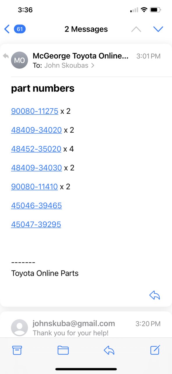

    Picture attached with parts numbers. For all cam bolts/sleeves,eccentrics. Besides the 2 smaller cam bolts I listed above

    @Mhagha For future reference, this is what you need for that top bolt on the rack. Also great to have for removing the upstream O2 sensors with the right socket.

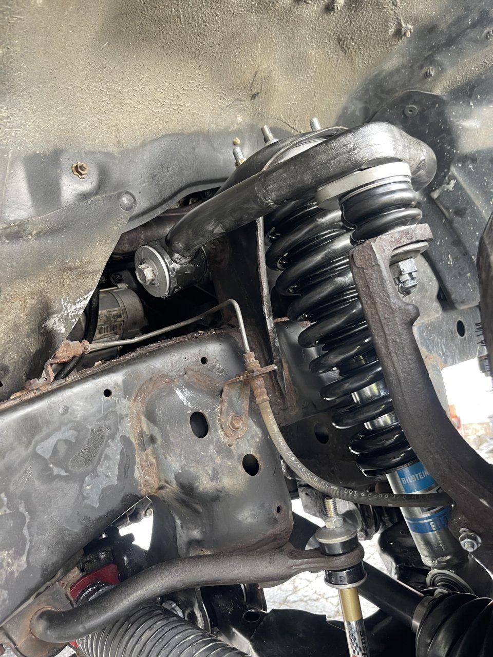

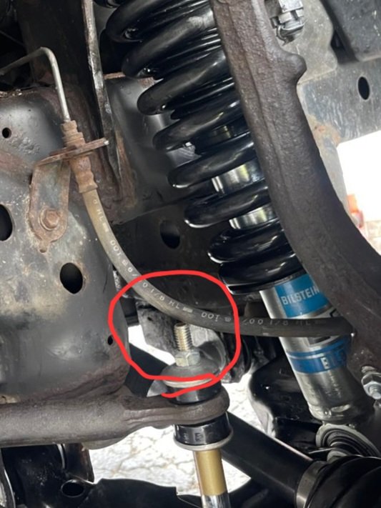

    Be sure and watch for rubbing right here if it's as close as it looks in the pic. I had one of mine almost rub all the way through. Replaced the soft line and now it sits in a better spot out of the way.

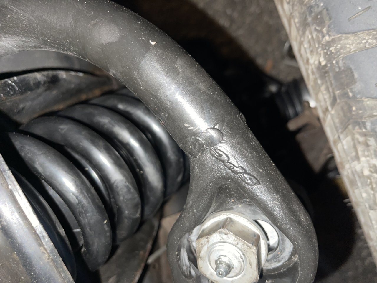

    I was able to drop off truck for alignment. They just called me and told me upper ball joints are installed wrong!

    Looking at the pictures... it "appears" that the rectangle plate isn't in the slot in the arm like it's supposed to be, but I might be wrong because I'm not there with eyes on it in person

    In the instructions, they explain how to "clock" the upper BJs in order to achieve the camber offset you'll need, IIRC.
    It's important not only to clock them correctly, but also to ensure all is fastened down as recommended. Local retailer actually tried to sway me away from SPC because they're convinced the SPC BJ is capable of "jumping" to a new setting, though I don't see how it's possible.
    Anyway, the shop may be correct. Only you would know. That's the only part of the SPC install I think may be more difficult than expected, and that's actually clocking the BJ appropriately. It's not a like a uniball or delta where "one position fits all".

    Jack. Yes that would have helped but I saw videos on bolt removal steering rack on a V8 and it looks like there was a lot more room. On the v6, could be wrong, But I’m telling you there was barely any room… Even if I had that type of ratchet. I’m curious if anyone else had this problem
    Anyways. Got my wheel alignment done. Guy did great job. Ball joints were correct. I think lady that called me had her info wrong. But. I have never done this before. And it cost me extra money because of that hex plate. I basically just put it on there and bolted everything up. So if you’re doing this. Yeahhh pay attention to what needs to be done with that plate
    Alignment guy also stated. I did something wrong with 1 bolt for camber adjustment. He said he couldn’t adjust because I installed wrong. They close early, so I couldn't really talk to him.

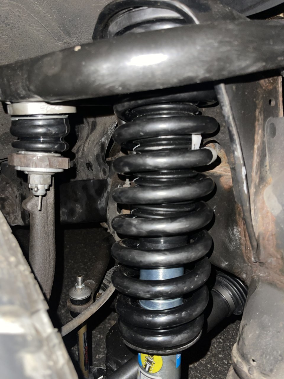

    I will attach few pics of ball joint. In case anyone wants to see.

    Still drives fine but visible inspection the boots and bushings are beat.
    Everything is still pretty stock.
    Put Billstien 5100's on it 3 years ago.
    I noticed the front lower bushings look pretty bad on the billsteins. Kind of surprised. Arizona and only 3 years.

    Well if you don’t have too many miles on the Bilsteins you can always replace the bushings. $20/each from what i recall. Just gotta find a shop that will press the old ones out and the new ones in. I think i paid $50 total for a shop to do it for me on both shocks.

    Yeah i'll take a closer look when I take it apart. Only 15k +- miles on the Bilsteins.
