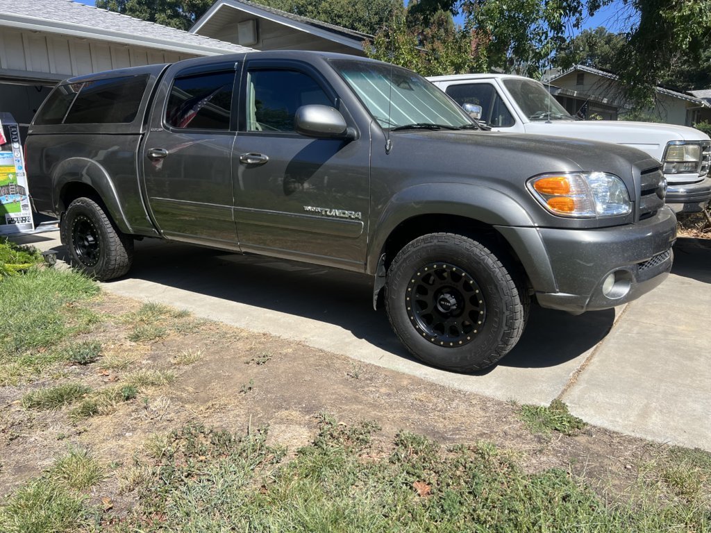

    Last year I bought my first Tundra (2004 Tundra Limited DC 4x4). Upon buying it, I bought some Method 305NV wheels, in which were installed with some Cooper Discoverer AT3 255/70R17 tires that had been on the stock wheels prior. After installing them, the installer mentioned that they are hubcentric wheels. He stated for me to drive the truck and if there is vibration, then to give him a call and he will get some hubcentric rings ordered. Since then, there has been some vibration while driving that I have noticed. Do you guys know if the installer was correct and that I need hubcentic rings, or was he incorrect and I have other issues going on with my rig? Thanks in advance for any help!
