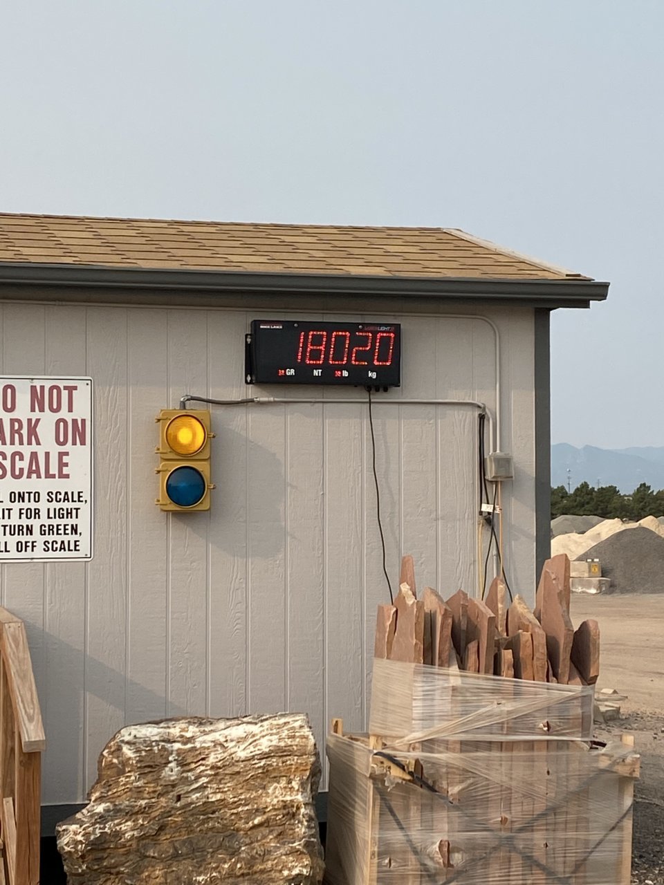

    This week in fact I had to pull materials off my trailer. My neighbor needed some supplies and the estimated weight was not even in the ballpark. I scaled just over 18k lbs with the trailer axles and truck rear axle. I had them pull off 2500 lbs in stone since I was so close to my 23200 lbs GCWR. 5DC95185-D707-4F9A-A3AC-5BC8A93E86E0.jpg
    My neighbor didn’t understand what all these numbers meant. We had a short class on the way home.

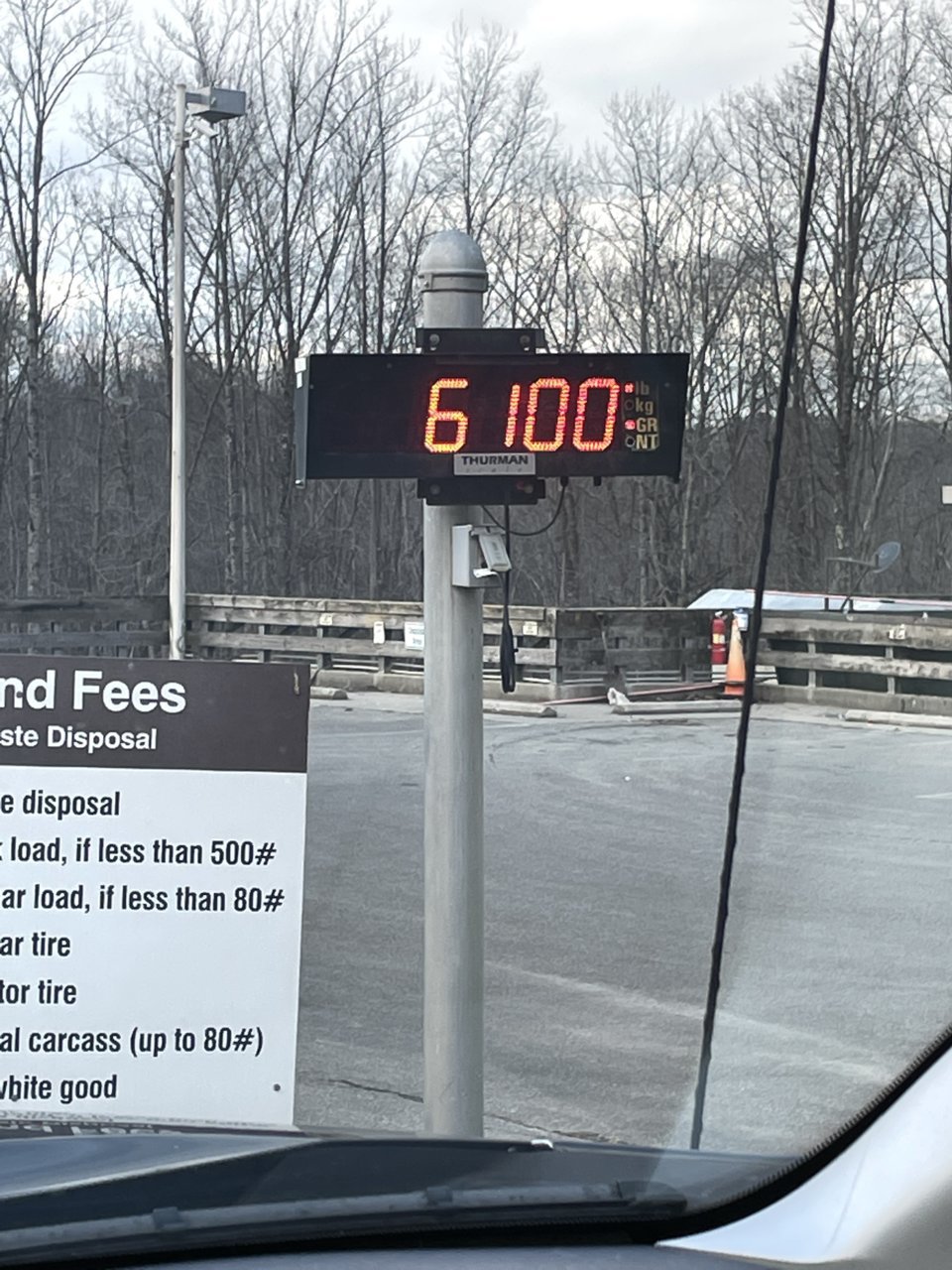

    I think a lot of folks would be surprised how much their unloaded Tundras actually weigh. I weighed mine after going to the dump and was surprised…6,100 lbs with just me and half a tank of gas. I have AT tires and a few other mods that apparently ate up 200 lbs of payload.

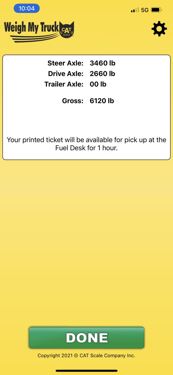

  19. Jul 14, 2021 at 7:58 AM
    #49
    wsutundra
    wsutundra [OP] 2021 Smoked Mesquite 1794
    Mar 30, 2021
    #61151
    119
    This is my tundra stock with me In it and a half tank of gas. It has the factory Bedliner, a light weight tonneau cover, and some tube steps. That’s it. It’s a heavy truck.
