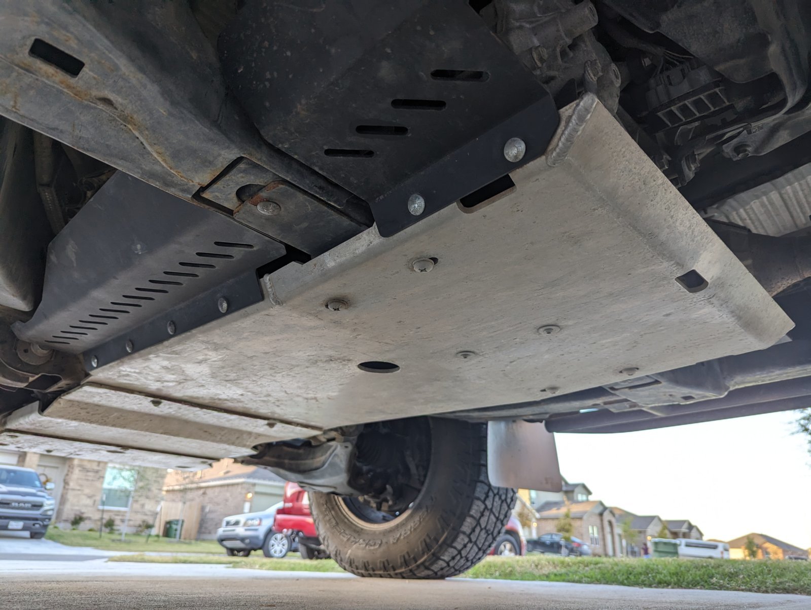

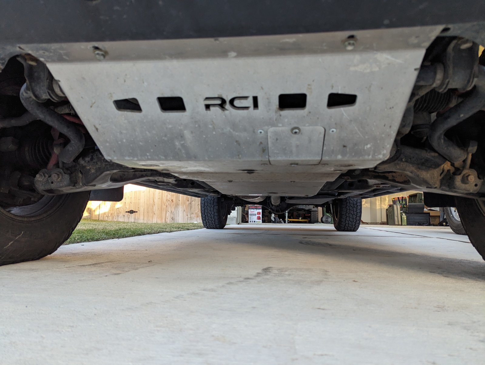

    Here's a couple. They're 3 or so years old and have been in OR and AZ, so zero road salt exposure. A couple Baja trips, beaches desert, and mostly PNW woods. I'm happy with how they're holding up. You'll see I don't go searching for rocks.

    I'm in MD and although we don't get a lot of snow, MDOT likes to salt the everliving shit out of the roads with the new brine they've been using over the past several years. It's why my old one is off and the bolts rusted and broke off when removing for the first oil change (I think that's how it happened).
    Are the plates on the side for cat protection?

    They are, they almost fully protect the primary cats and would make the 2nds super hard to get out.

    Are they also RCI? I don't see any listed on their site. TIA

    They should be listed as an option somewhere. Mine was old enough I had to drill holes for them, all the new ones are pre-drilled.

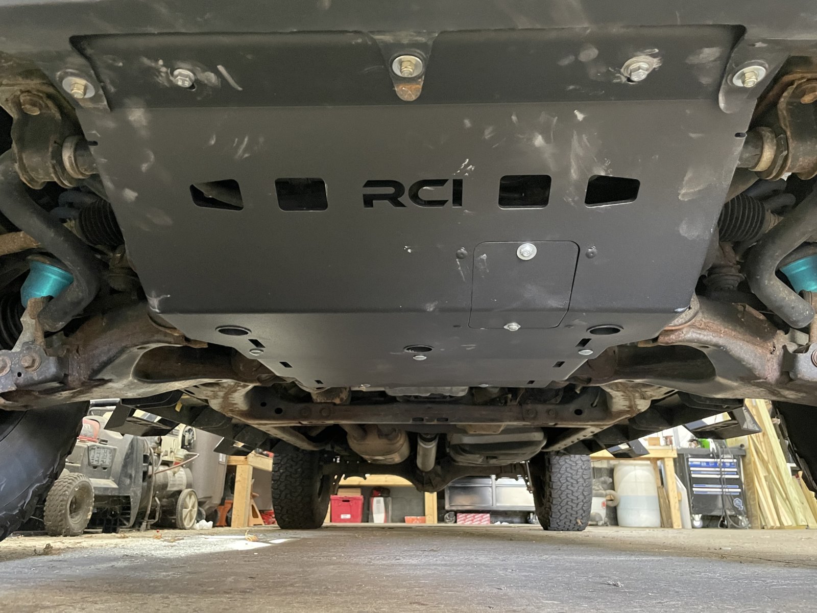

    I drilled out the snapped off bolts from my OEM skid plate and tapped the frame for the new rci skid bolts. Came out well. Got anti seize on everything lol happy with how it looks. Ordered the trans cover just now.
