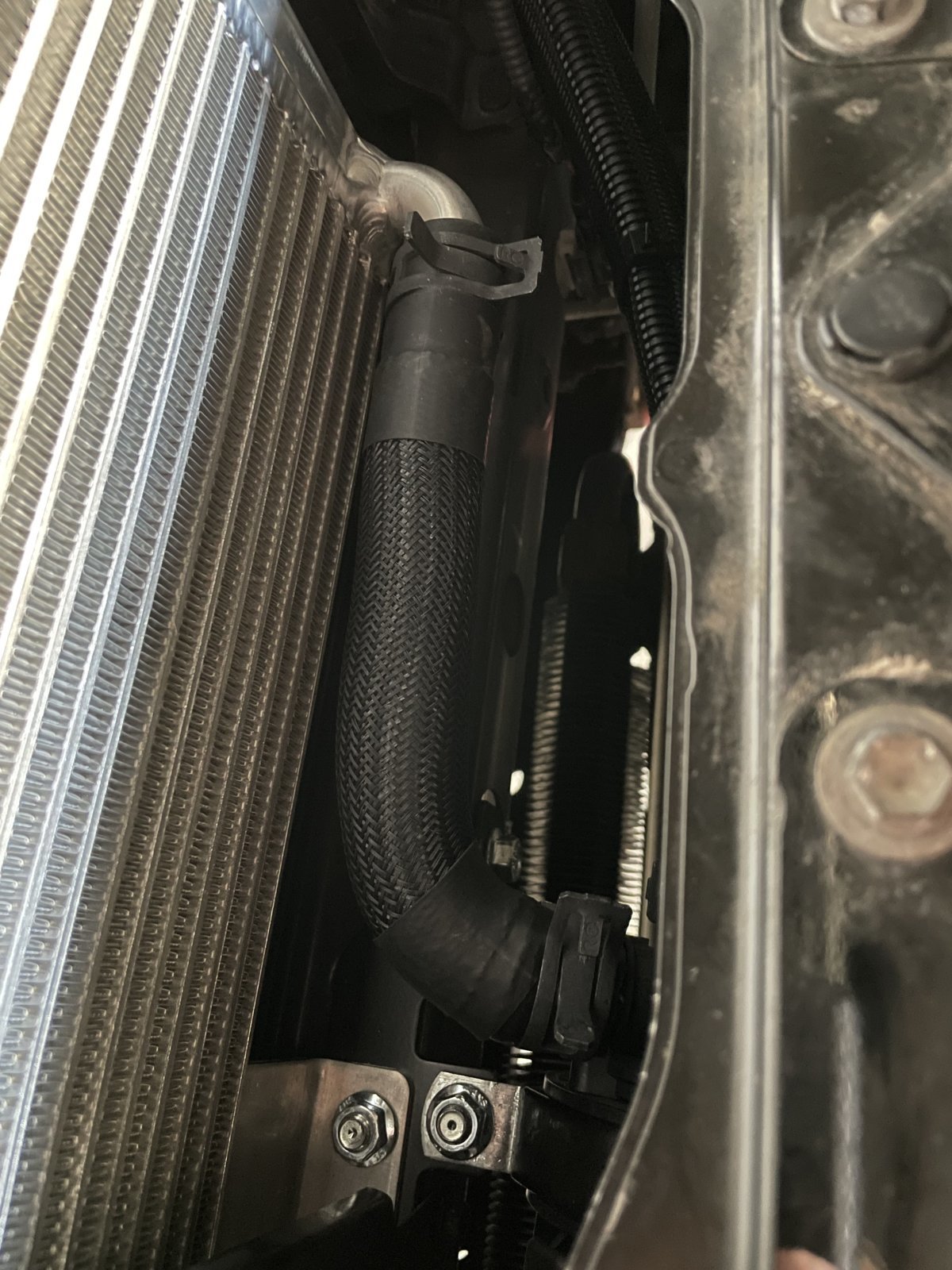

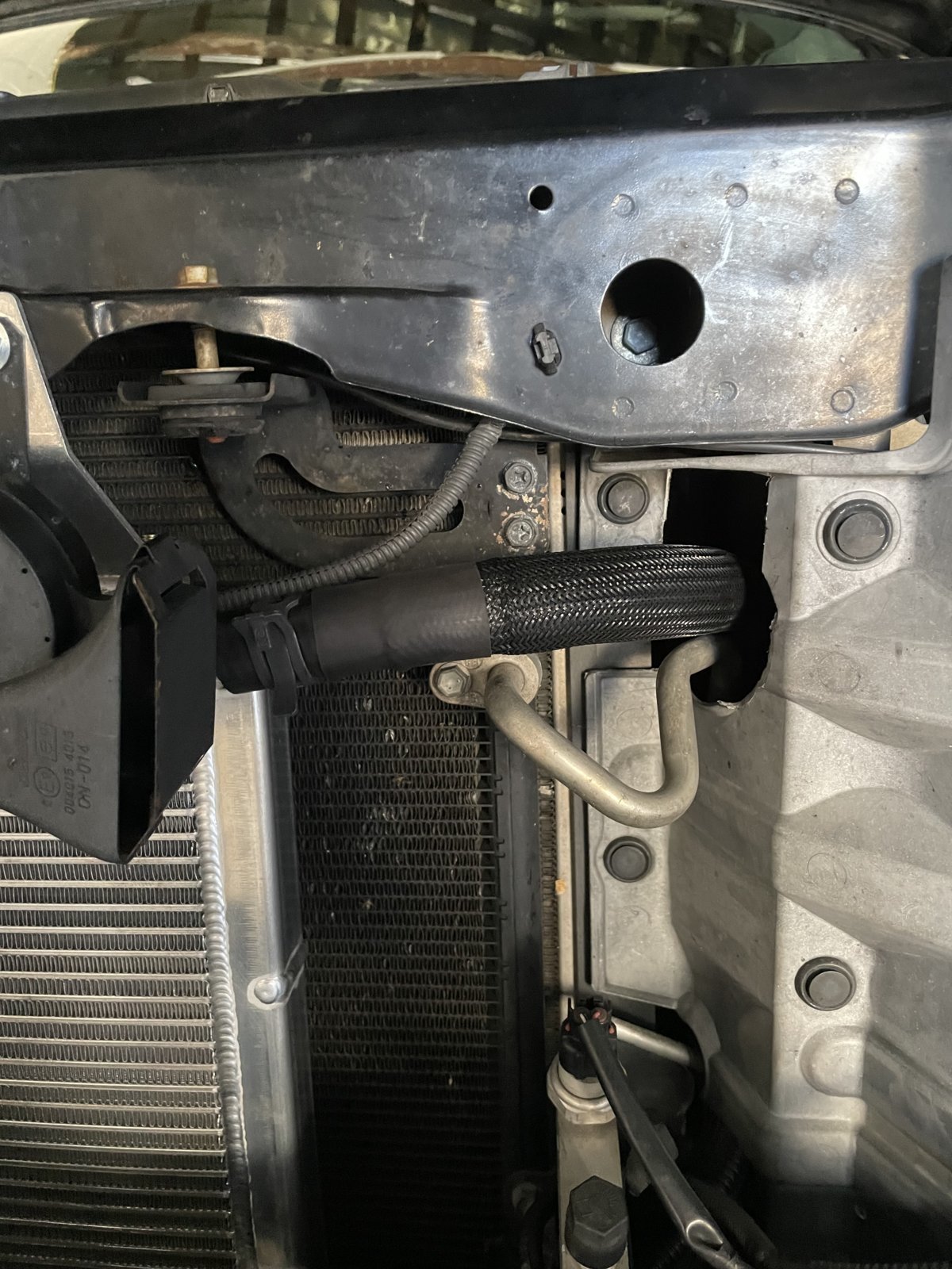

    Magnuson 2650 w/76mm pulley, ADS suspension, 35's, misc overlanding bro-trophies
    Awesome. Any more pics of the heat exchanger and hose routing with the grill off?

    I can snag a few and post.
    I followed directions for the most part but ended up routing a little diff to make it cleaner.

    2015 DC 4x4
    Thanks! I have a winch and power steering cooler on mine and I'm trying to get an idea of how much relocating i'd need to do to fit it.

    Eastern Shore MD
    2013 Black Tundra Platinum
    let me know if you need more specific or different pics
