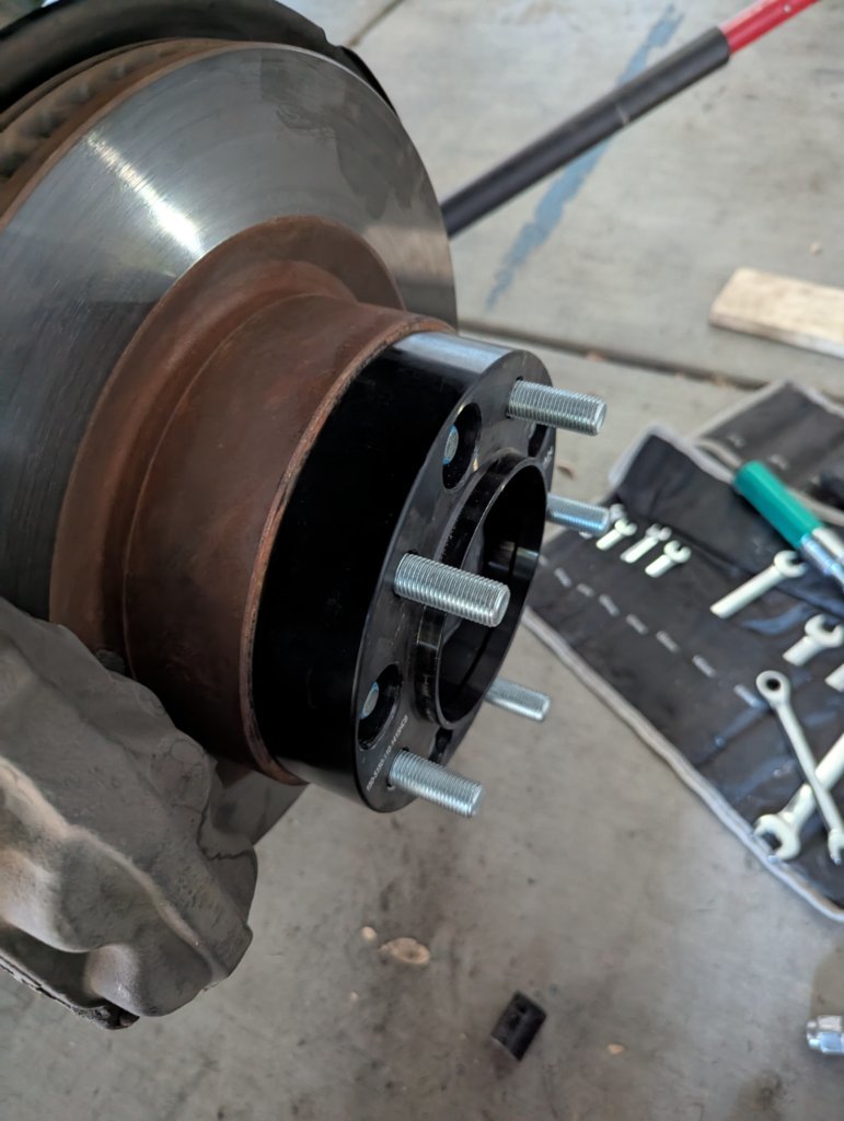

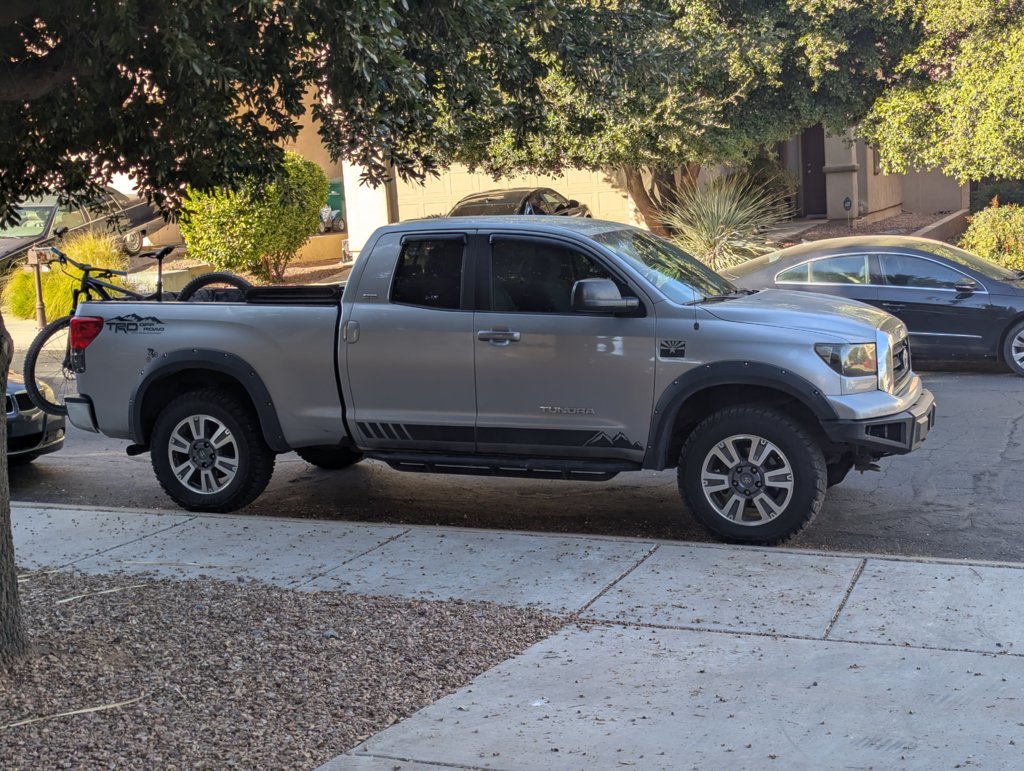

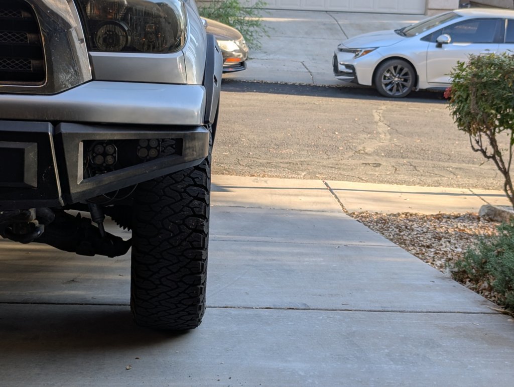

    Late last year, installed Bilstein 5100s at middle setting and got 34" BFG AT KO3 installed. (275/65R20). First choice was wildpeak at4ws but they were on back order everywhere.
    Ride is worse but they look awesome.
    Without any offset they just barely touch the sway bar at full lock but not enough to notice, and they would rub the skid plate if not trimmed or bent out of the way. (I've since fixed the skid plate that I had bent out of the way in the photo lol)

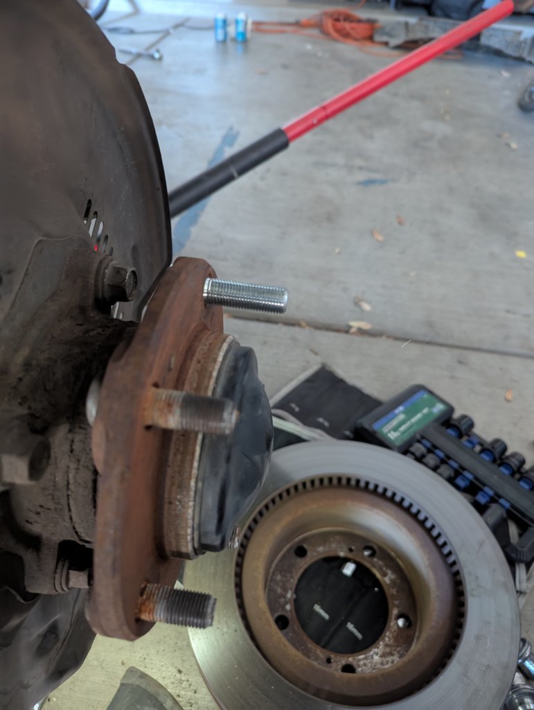

    There was a little Amazon tool which combined with my torque wrench and some cheap pass-through lug nuts off amazon, putting a nut on, hammering the stud out, and using a different lug nut to zip the stud in and seat it, was easy.
    The result is great. Subtle but the tires sit in a more natural spot now.

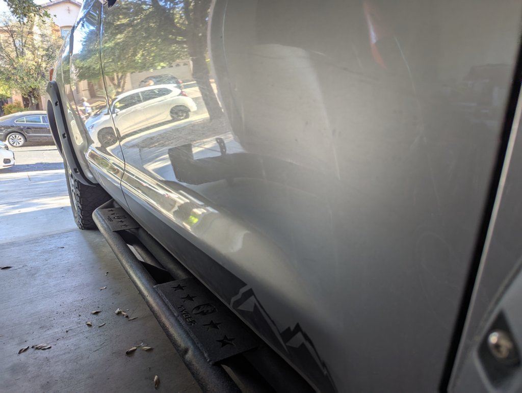

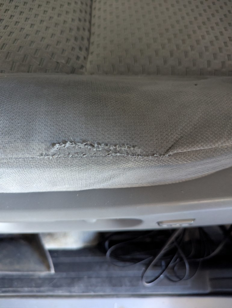

    And some cleaning. Attempted to field repair the drivers seat.

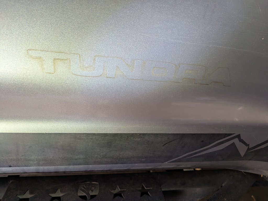

    Debadged. 200K miles of ghosting was able to come out surprisingly well with an auto store drill mounted buffer kit!
    I have a newer grille, some more decals, and a hooke road rear bumper all ready to go on
