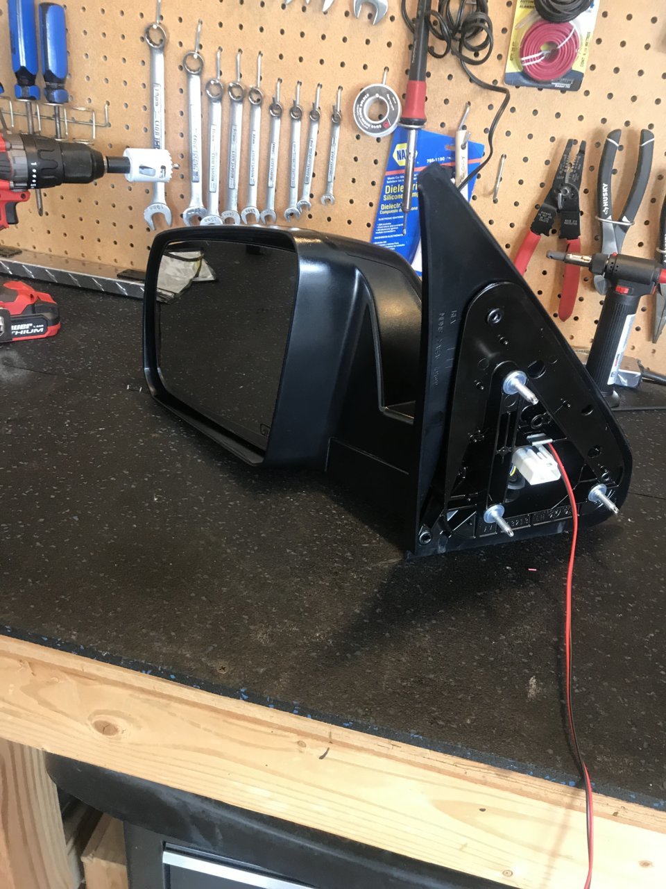

    I searched and couldn’t find a thread that covers this helpful and inexpensive mod. I have an SR5 with heated mirrors but no puddle lights.
    @VTYOTA has a GREAT tutorial thread on installing VLED universal puddle lights to a set of tow mirrors that includes product links and very good install tips:
    https://www.tundras.com/threads/diy-tow-mirror-puddle-lights.42359/
    This one is specifically about fitting the lights to a factory mirror.
    Once removed, the mirror has a couple of items that make install easier.
    Near the hinge joint of the mirror, there is an access panel that snaps out using a small flat blade. In the middle of the mirror bottom there is a positioning mark for the puddle light.
    You’ll need to remove the mirror from the housing. There is a YouTube video, but you just angle the mirror as if looking down at the ground; the top of the mirror will be projecting out of the housing, the bottom of the mirror will be recessed in to the housing as far as possible. Using a wide plastic trim tool, get under the mirror and lever it up while holding the housing stationary. It’ll take several tries, but it will eventually pop up. I marked one defroster terminal and the corresponding wire with a sharpie. Then unplug the defrost wire. Set the mirror aside so it’s safe. At this point, I wiped the whole mirror housing clean with microfiber and cleaner. Now, pop the bottom access cover off.
    Turn the housing over and with a lamp, look into the housing where the wires for the defrost wires head. You’ll want to run your wire along the defrost wires. At this point, I used steel wire and electrical tape to fish the new wire through the housing. It was not hard.
    As you bring the wire out of the mirror mount, you’ll see the defrost wires emerging from a grommet. Using some needle nose pliers, pull that grommet out. Pop a small hole in that grommet and run your wire through. Then press the grommet back in.
    Time for the commitment- the 1.5” hole needed to mount the VLED puddle light.
    Drill a small pilot hole in the center of the positioning mark (the cast circle) on the bottom of the mirror. Follow that with a 1.5” hole saw. Sand and debur.
    Use the alcohol wipe to really clean around this new hole. Remove the 3M tape backing and mount the light.
    Replace the mirror in the reverse of removal; plug the defrost wires back in, line the clips on the housing mount up with the receiver castings on the back of the mirror, and then use the wide plastic trim tool to lever the mirror down. You’ll feel it click into place. Your mirror should be ready to reinstall.
    VTYOTA’s tutorial does a great job describing how to route the wires so I won’t recreate it. The VLEDS are quite bright, and the positioning mark on the factory mirror takes the guesswork out of the install. Hope this helps!
