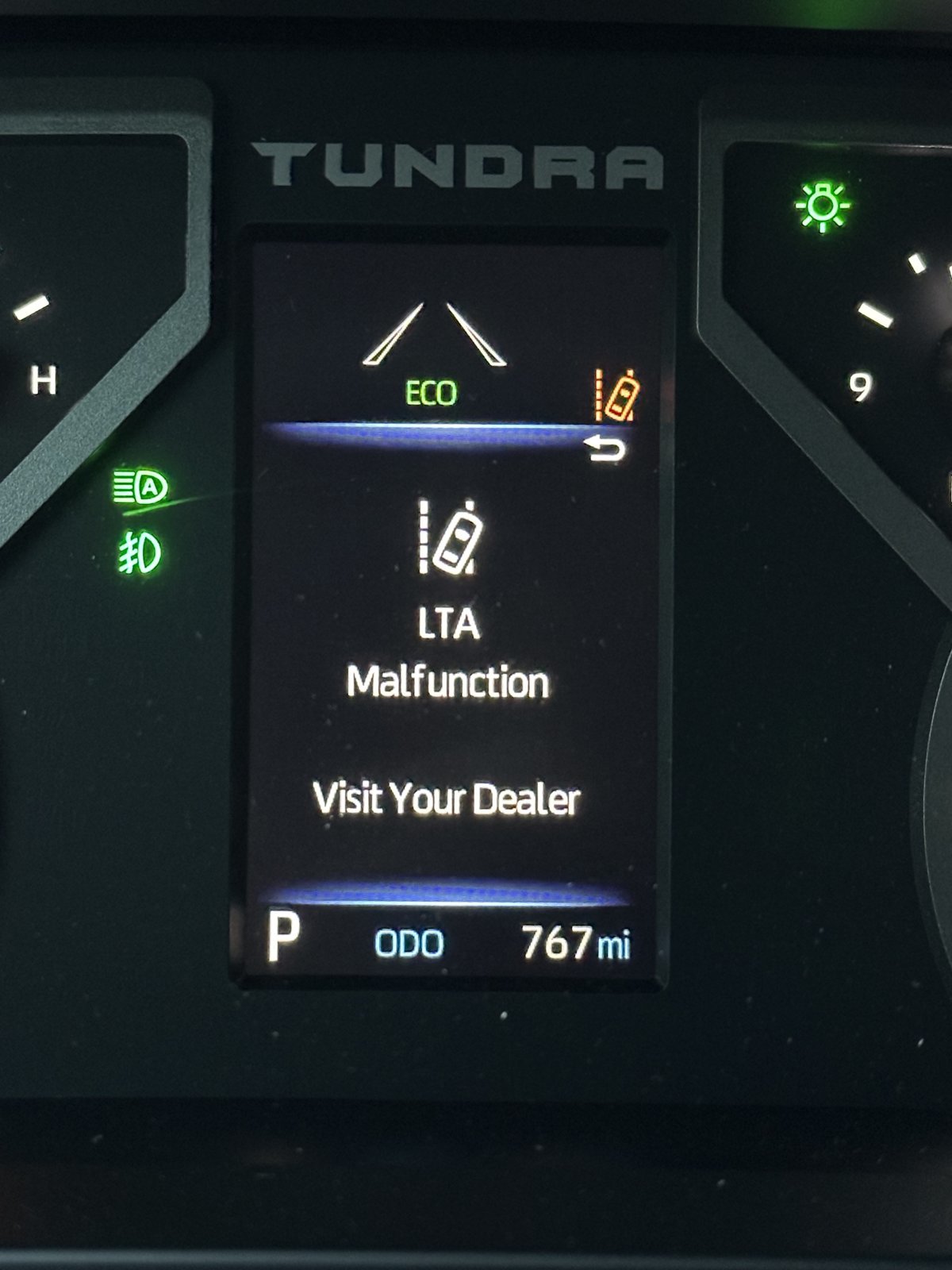

    Just happened on my brand spanking new 2024 4x4 Crewmax Sport. CarPlay wouldn’t connect, as other indicated. I reset the radio by holding the power button down, then got the below message. Contacting the dealer tomorrow. I’ve had it for less than a month at this point and it’s already more buggy than my 2021 RAV4 that I traded in for it.
