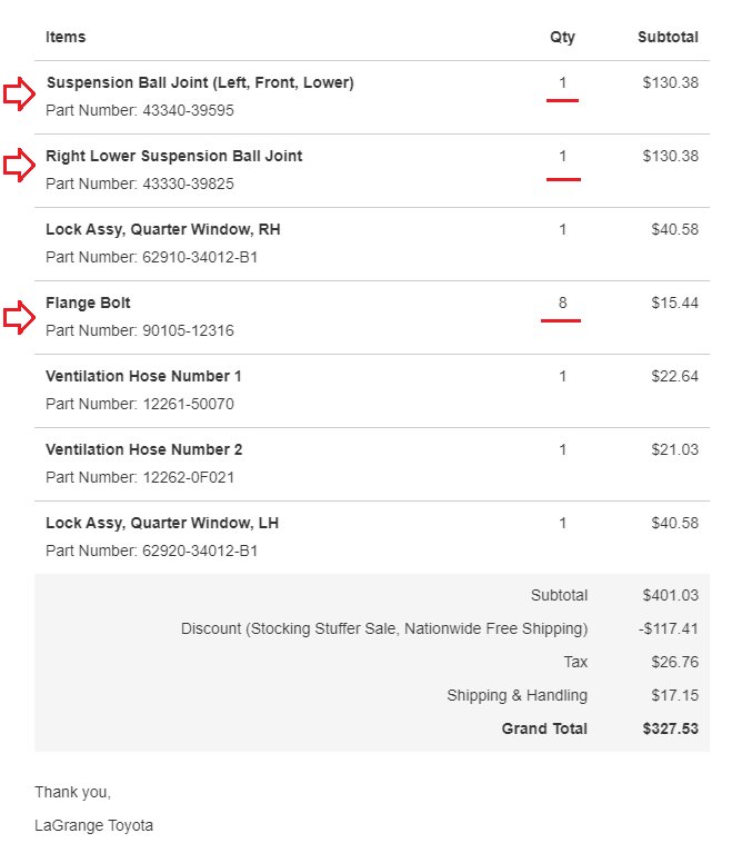

    Going to the dealer for these parts is usually just a good way to throw money out the window because they are usually charging you more for the same thing. Ordering from one of the online store fronts is the way to do it.
    Is this the part number they are looking for?
    9010512316

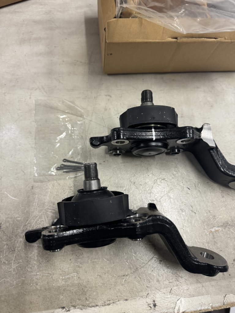

    I ordered the LBJ kit from Ourisman on Sunday and parts shipped today, Tuesday, so I'll also post photos of what arrives in that kit.

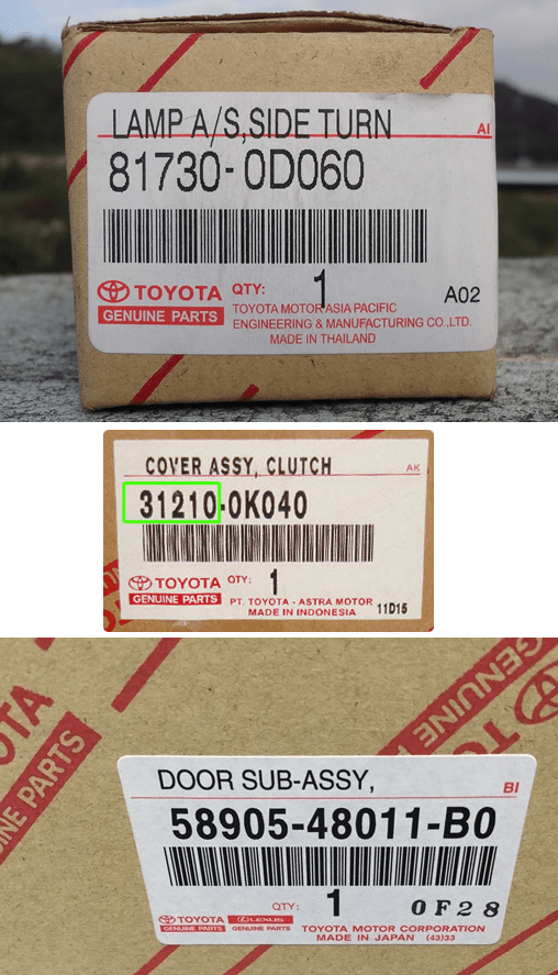

    I'd love to see the label. Toyota lists the origin on all authentic parts, here are a few examples. Note the very bottom of the label.
    They do have more-generic labels that allow the origin to be printed ....

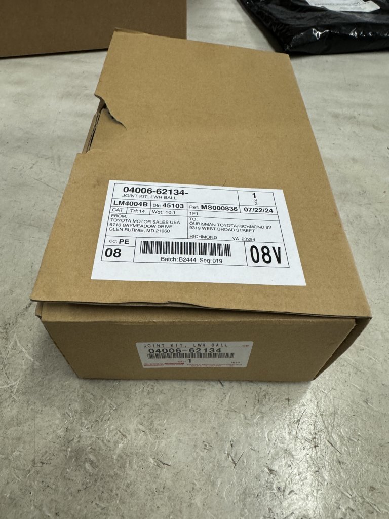

    This was my kit from there. I feel like they sell so many of these kits they are very consistent.
    this box was custom made for they two ball joints to fit into it. Where other parts o feel they just but in random boxes or bags and add a sticker
    there is a batch and seq number on the box also

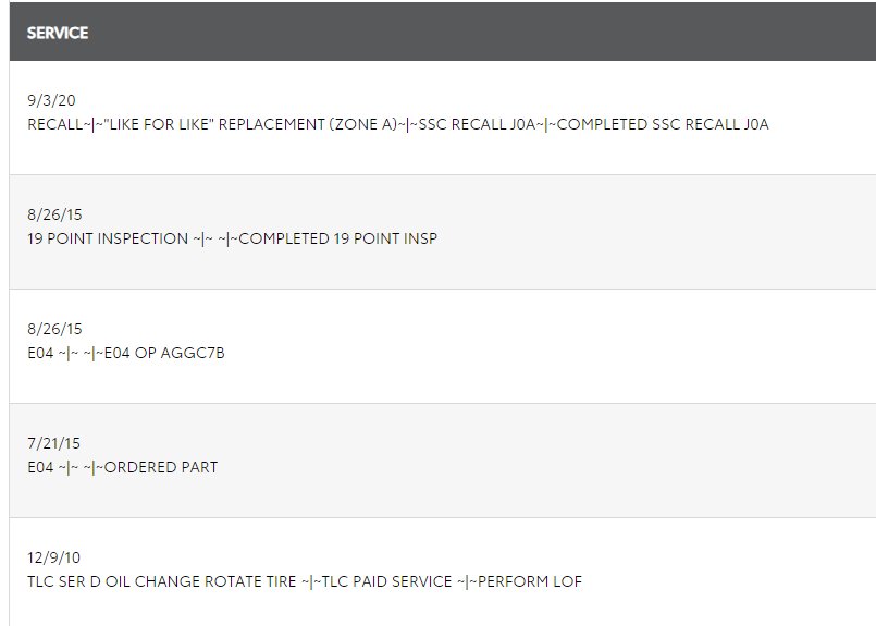

    Maybe a dumb question (especially since I already ordered my parts) but is the actual "recall" still valid? Meaning could I have called up a dealer and requested they check records to see if it had ever been performed on my truck and got it done for free if it had not been?
    I know some safety recalls exist and last the life of the vehicle (airbags, etc) but not sure if this would be the case here - I'm guessing not given the number of people having to do this themselves, but curious all the same.
  22. Oct 2, 2024 at 9:09 AM
    #262
    shifty`
    Jun 20, 2020
    #48239
    31,524
    ATL
    '06 AC Limited V8/4WD
    You can actually check yourself pretty easily. I take it you're registered at the Toyota Owners site already, and have added your Tundra VIN to your account there? You can look up service records/recalls to confirm the work was performed. It'll probably be listed as an SSC (special service campaign). Most people had theirs done by 2007-2009 era.

    I am registered but hadn't thought to go look. Interesting, it is not listed in the service history (I've owned the truck since 2011 and only recall performed was the airbag recall J0A which I had done in 2020) but it also shows "No recalls." I guess I'll call a dealer just for fun.
    I'd also be shocked if it wasn't done since I bought it (again, in 2011) from a Toyota dealer. Maybe the service history on Toyota Owners only shows history since I've owned it?

    Look closely. Sometimes it's listed as a "sub item" under another service. It may not say "LOWER BALL JOINT" in clear print. It may only show "SSC" with a number or some obscure other info. We've seen that before, and we've also seen members from The Great White North who can't pull any info on the Owners site for some reason. We've also seen confused people with a 2000 truck, which I don't think the recall applied to. Only 2001+
  30. Oct 2, 2024 at 10:51 AM
    #270
    Auburn02
    Auburn02 New Member
    Jan 26, 2022
    #73719
    84
    AL
    2006 DC 4.7 2WD
    Gotcha - the only "SSC" item is recall J0A (airbags), but there are only 5 service records that show up in total from 2010 to 2020. The 2010 entry is before I bought it, the 2020 entry is the airbag recall, the 2015 entries might be that one time I ever used a coupon and let the dealer change the oil, can't even think of what else that would have been.
