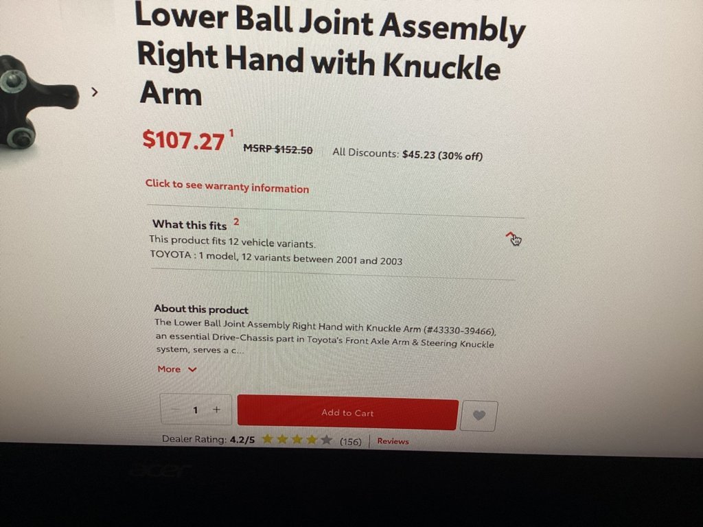

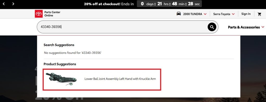

    Anyone know if these part numbers changed or are no longer available?
    I have a 2000 with 92,000 miles on it on original ball joints
    When I type in these part numbers on toyota website I get "No suggestions found for '43340-39356' "
    I'd like to replace both sides, just due to age
    Any help is appreciated

    I plugged in part number you listed, and got this.
    May be your internet.
    Websites been acting weird all weekend.
    I been looking for parts today, and had to reload a few times. Thought my cart was even erased once. Had to sign out and log back in to get cart to register/repopulate.

    I don't know what is going on, maybe the dealer I'm trying to buy from is Out of stock on it -- I can find it thru a duck duck go search but not on the dealer black mamba linked in Alabama
    Strange
    Orisman in richmond has it as it pops right up...
    Serra toyota gives me the no item found thing
    Edit -
    I'll be calling serra in the morning -- Their discounts are too good to pass up
    I have no idea why I can't find the lower ball joints in their system.
    Parts show up at orisman but they want to charge shipping and sales tax...

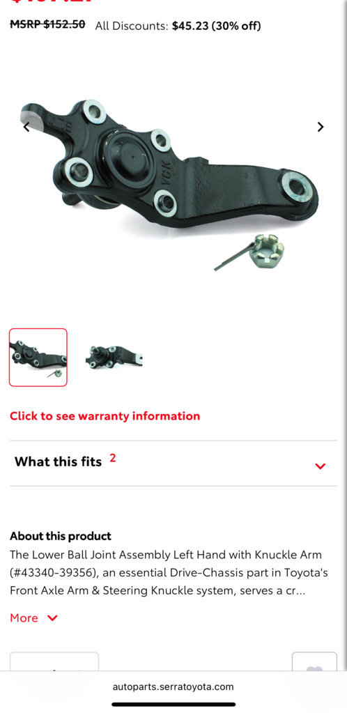

    Agree but if you select "Product Suggestions" it takes you to the 43340-39356 page @Redoak is showing and you can place your order.

    Works this morning, last night the product suggestions took me to a different ball joint. The 39356 was nowhere to be found. Same with the 39466.
    I do not have my vin loaded into Serra this morning. “What this fits” is 2001 to 2003 on the website right now.
    Edit
    called and spoke to a very pleasant parts rep -- Ordered, along with a high mount stop light assembly

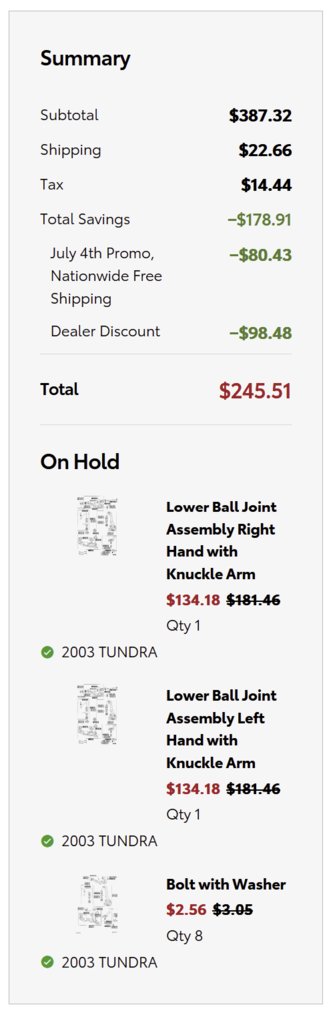

    Pretty good deal ($245) and shipped free to my house. About $100 cheaper than the quote I got in person at a different dealership in the Boston area. Checked all of them and Woburn had the biggest discounts. Got a power steering rack from them too. Although, it was defective out of the box... that's another story, but less a reflection on them and more Toyota. They swapped it out for me and paid me for extra labor my mechanic did. Had to fight for it hard tho lol
    https://autoparts.woburntoyota.com/
    I went with the "black" bolts. They were the ones the dealership recommended as well. 2003 AC 4x4 3.4L.
    Part # for 2003 AC 4x4 3.4L. Haven't installed them yet, but VIN fitment was good.
      • RH 43330-39605
      • LH 43340-39485
      • (x8) 90119-10933

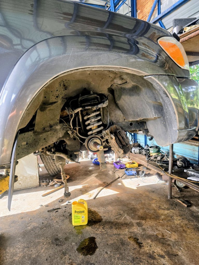

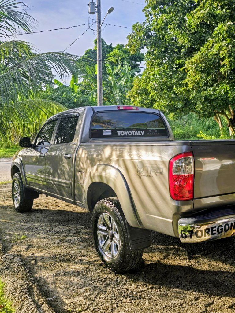

    Installing MevoTech front end kit. Will just have to try em out on how long they will last. Sigh ! Its difficult getting parts all the way out here in the Pacific Islands. Some part suppliers don't ship to P.O. box addresses.

  11. Jul 22, 2025 at 6:01 PM
    #431
    shifty`
    shifty` You can call 1 (800) PP5-1-DooDoo
    Jun 20, 2020
    #48239
    30,852
    ATL
    '06 AC Limited V8/4WD
    Brother, Toyota ships to all 50 states.
    You picked one of the absolute cheapest, worst brands you could've possibly picked for LBJ, although nothing aftermarket will last, Mevotech is the worst possible brand. Someone just posted their Mevotech Supremes where the ball completely popped out of the casting.
    Here is 20 pages worth of people who decided, "oh well, fuck it, I'm not gonna listen to you guys about OEM lower ball joints", with pictures of what you can expect: https://www.tundras.com/threads/first-gen-lower-ball-joint-lbj-failures.141860/
    Don't do it, man. There's literally no excuse that justifies the risk of this, which was caused by a LBJ fail on the interstate - and this person *IS* a forum member, it's not a random shot:
    The Black Mamba and Filthyphil like this.

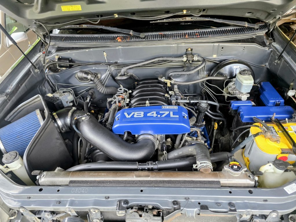

  12. Jul 22, 2025 at 6:13 PM
    #432
    shifty`
    Jun 20, 2020
    #48239
    30,852
    ATL
    PS-
    You REALLY need to replace that radiator.
    The plastics are browning. That's a sign of imminent failure. This is the last guy from Hawaii who failed to replace the radiator when it changed colors. He probably permanently damaged his transmission, but at least was able to get back up and running again. Maybe he caught the coolant/transmission fluid leak quick enough.
    If you're not aware of the radiator problem, maybe you also need to hear this. Your engine needs its timing belt, tensioner, water pump, and pulleys done every 10yrs or 100k (it's an interference engine), and best practice is to do the radiator at the same time.
    Rusty frames, non-OEM lower ball joints, old radiators, and timing belt are the top killers of these trucks, and will have your truck (or you) in the boneyard sooner than anyone wants to see.
    TOYOTALY 670[QUOTED] likes this.

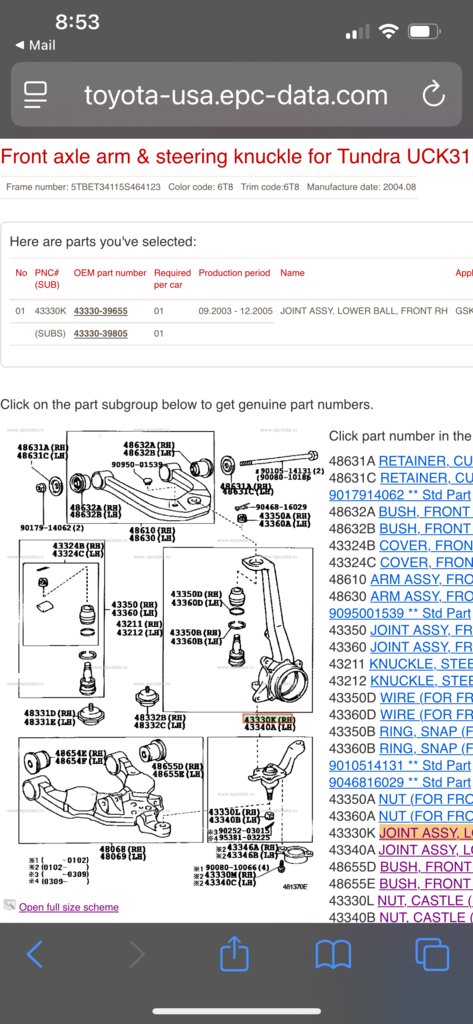

    Can someone please direct me to the right OEM LBJ part and the correct replacement bolts for an 2005 DC RWD. Also any other supporting parts I may need so I can give everything I need to my mechanic as a complete package for replacement, thanks!
  16. Aug 7, 2025 at 2:19 PM

    EDIT: Actually, I'm glad you texted your VIN over because I got the same numbers you did. PM'ing you with more info.
    Filthyphil likes this.

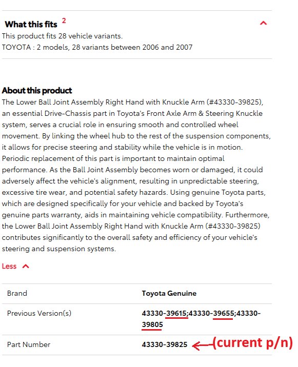

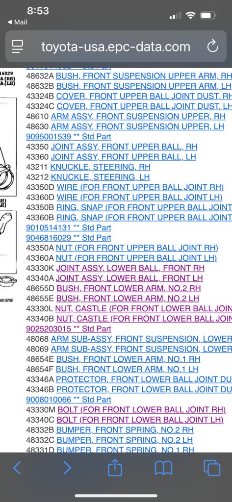

    Thank you. Glad I asked because I was getting different part numbers (pic attached) when looking up in the epc site, probably operator error though.

    Those are the numbers it gave you with your VIN?
    Do you mind private messaging me your VIN so I can run it thru the parts system to confirm your numbers?

    Ran your VIN thru EPC. It pulled 43340-39595 for the driver side, 43330-39825 for the passenger side, and 90080-12316 for the bolt.
    Worth noting that the RH (passenger side), while EPC shows an older base part number and alternate part number, Toyota has updated the part. This is visible in the Toyota Parts website. EDIT: Example here -- it's important to always flip down that little info section, it'll tell you prior part numbers. You can see Toyota changed the p/n a few times, and all of these part numbers have a match in EPC.

    I recently bought LBJs from Sera during the 25% off sale. What Shifty says is correct. A couple adds about Sera:
    1. They sometimes put a hold and it may take 10 days to get your parts
    2. Shipping is free over $75.00
    3. Small orders they charge like $20 for shipping whether you buy one clip or multiple items so don’t make small orders if you can avoid it.
