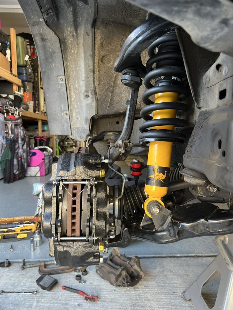

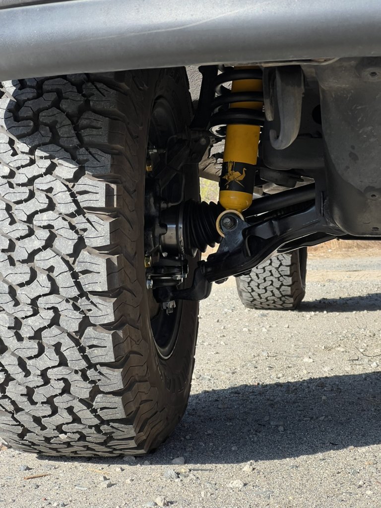

    Finished up my front end on Saturday. Pretty happy with it. A little bouncy but hoping that goes away once they break in.
    OEM lower ball joints
    OME 93004 Front shocks with 4004 Front coils
    NAPA CV axle
    NAPA Adaptive One S13WL Calipers
    Energy suspension sway bar link bushings

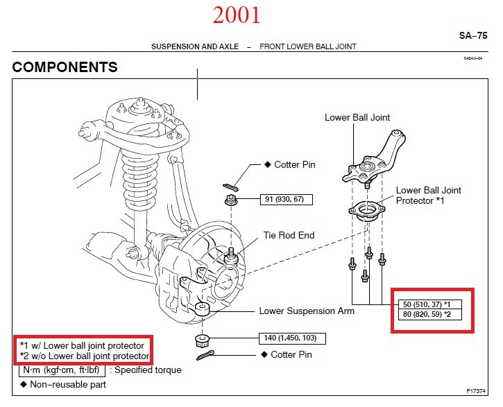

    Got my parts from Serra. Seen some folks asking about and posting where theirs were made and mine say made in Japan.
    I don't recall seeing torq specs in this thread apart from recalling 59 lbs for the 4 bolts for the LBJ.
    I do not have a FSM for my year of truck(2001), I was only able to find a digital version for the 2003 and hope all details are the same.
    The specs I see on page 1786, section SA-64 call out the following:
    Castle nut = 103 lbs
    4 bolts for LBJ = 59 lbs
    Tie rod connection to LBJ = 67 lbs
    Does that all sound right?
    Anyone have a link to a 2001 FSM, by chance?
  18. Feb 27, 2025 at 3:12 AM
    BubbaW
    Aug 19, 2019
    #34845
    4,130
    Bubba
    Where Eagles Nest
    04 DC LTD 4X4 4.7 V8
    T150 Lover
    The 4 LBJ bolts torque is according to note in below from the 2001 FSM.
    shifty` likes this.
