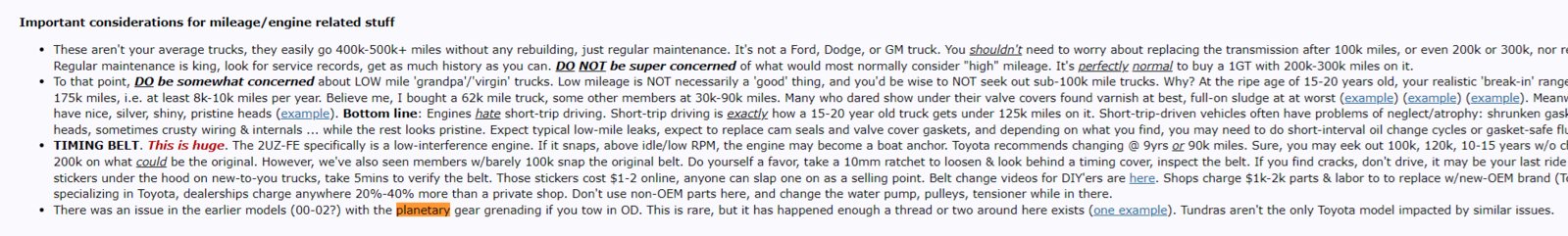

    Is it the A340 transmission - if so starting in '01 they began having OD bearing issue that don't show up until 200-400K. And yes it is destroyed - not even the TC will come out now. Ask me how I know.

    Planetary gears were a known weakness in early FGTs. If I were you, I would search for a good used transmission from a wrecking yard.

    I thought the grenading planetary was an '00-'01 thing, but wasn't sure. I guess I need to update THE MEGATHREAD!!!, eh?
