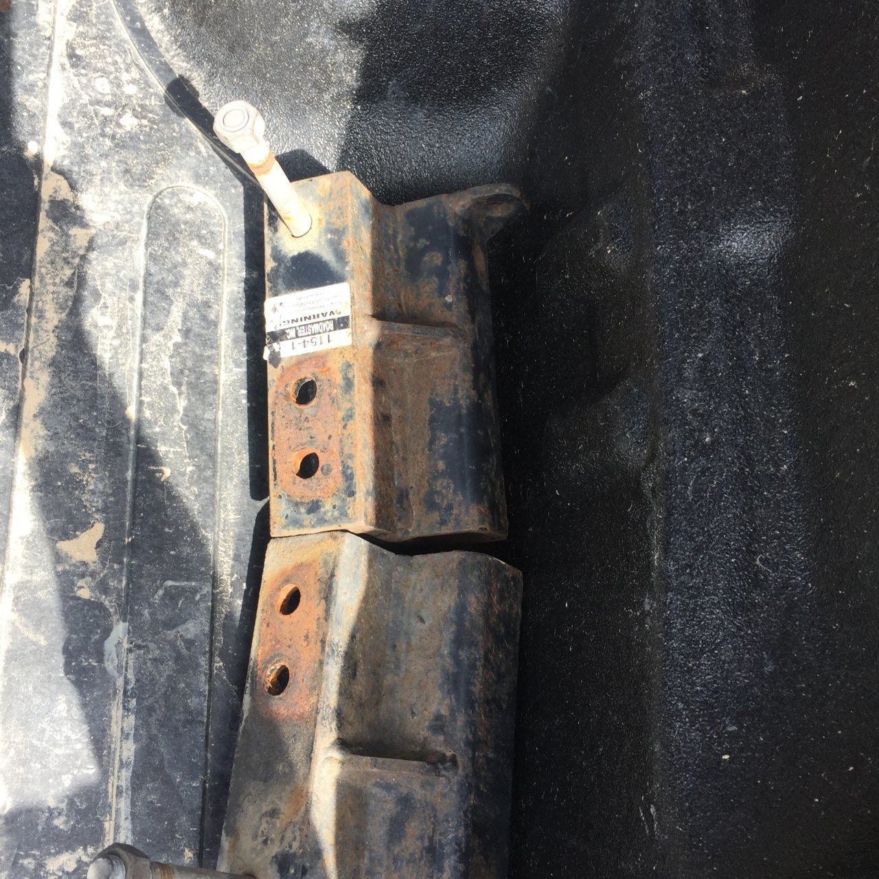

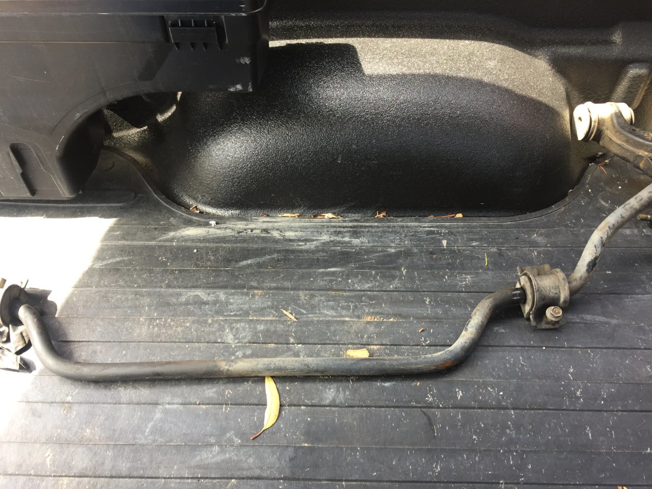

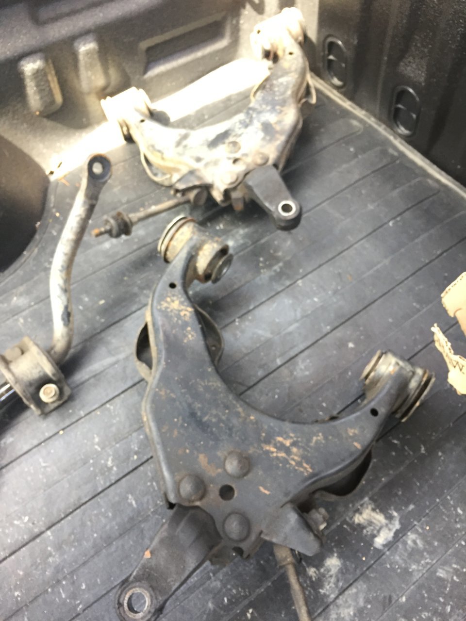

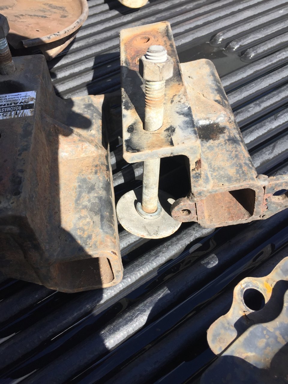

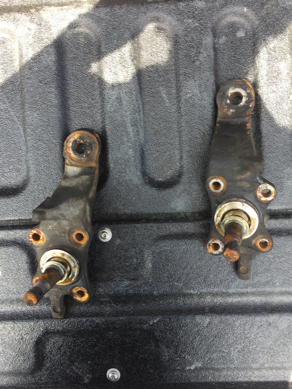

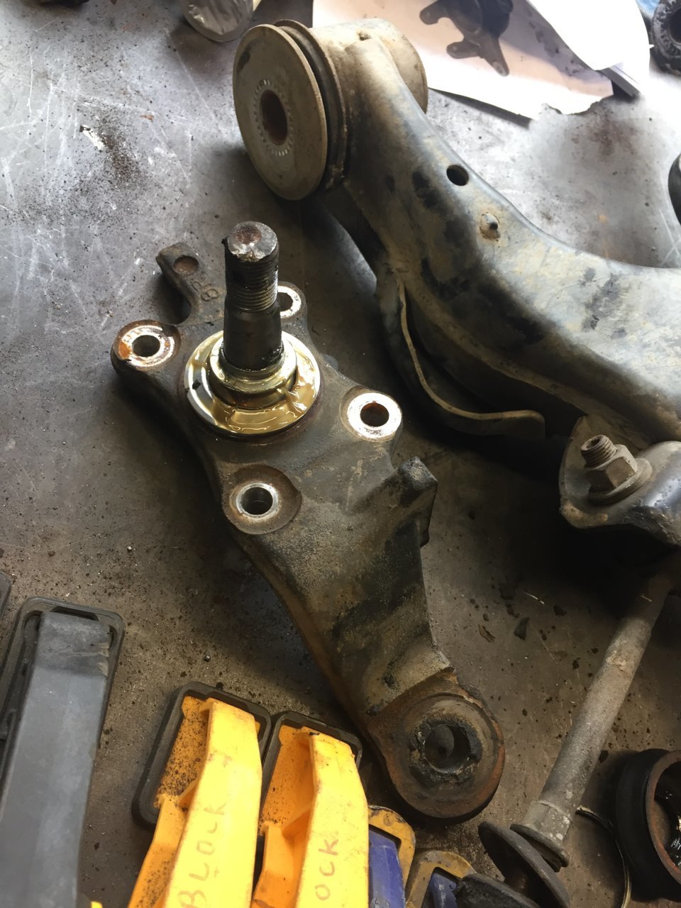

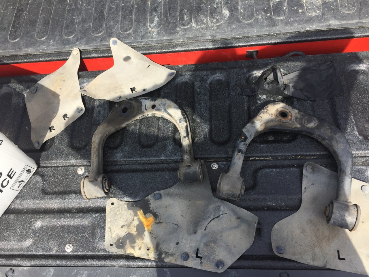

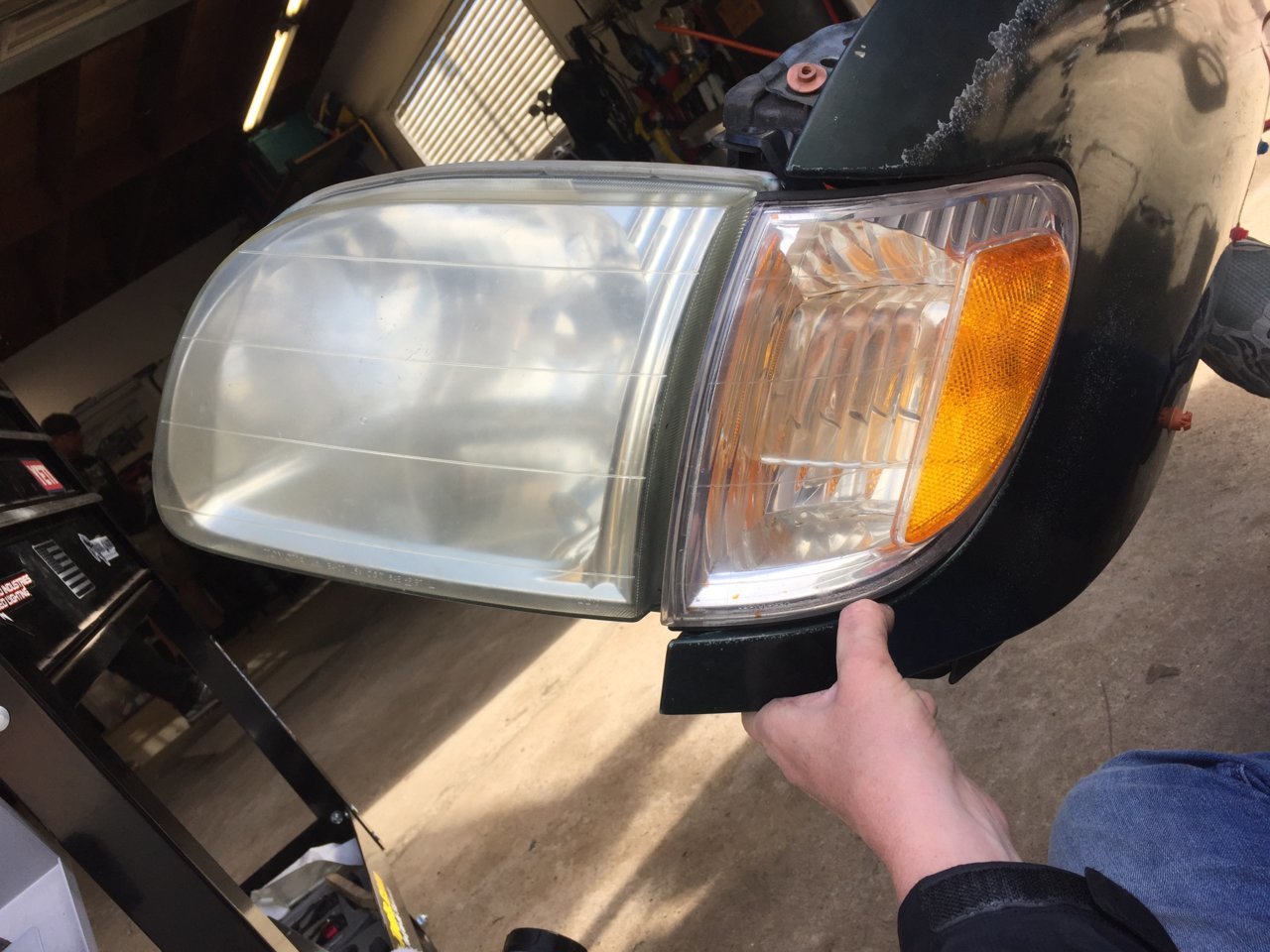

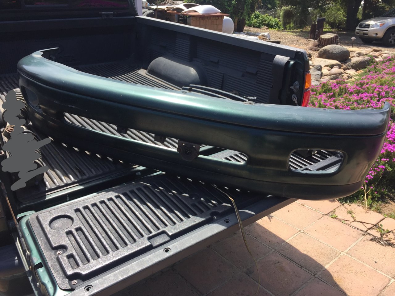

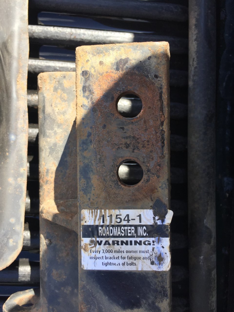

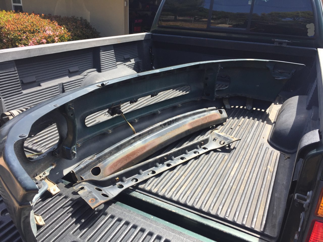

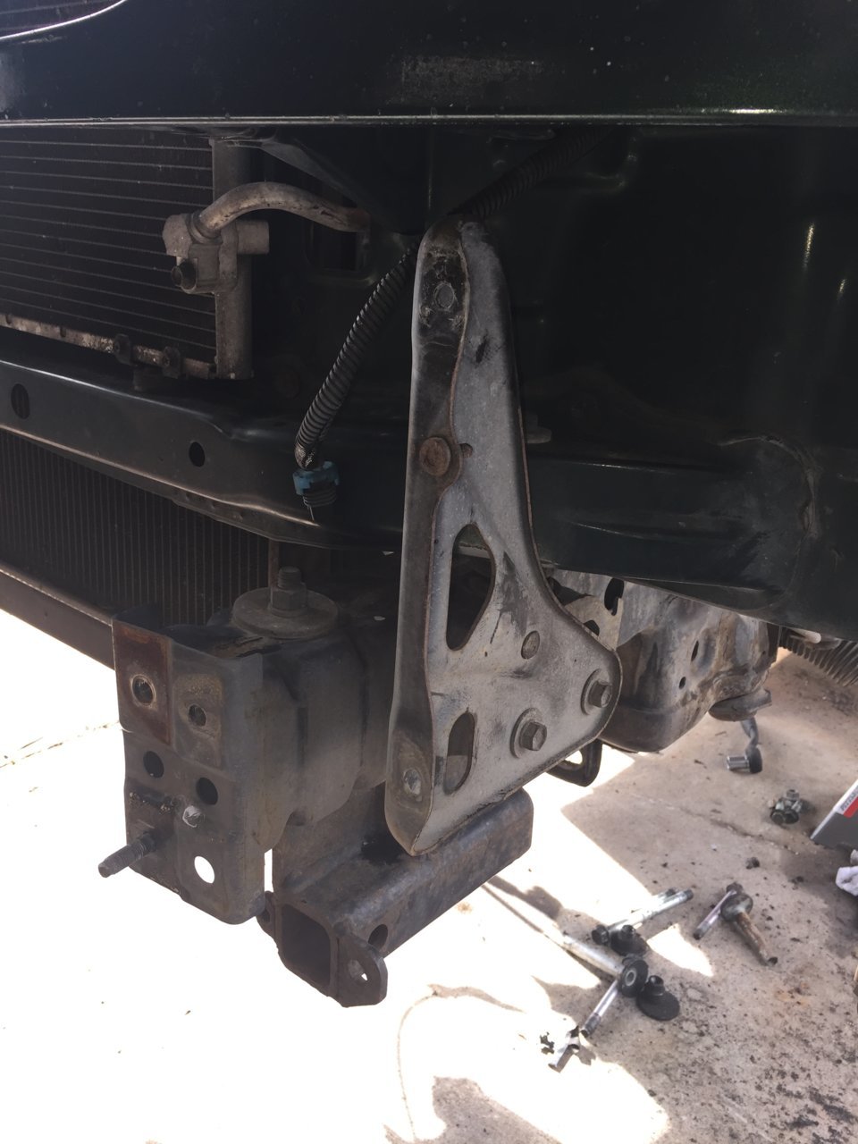

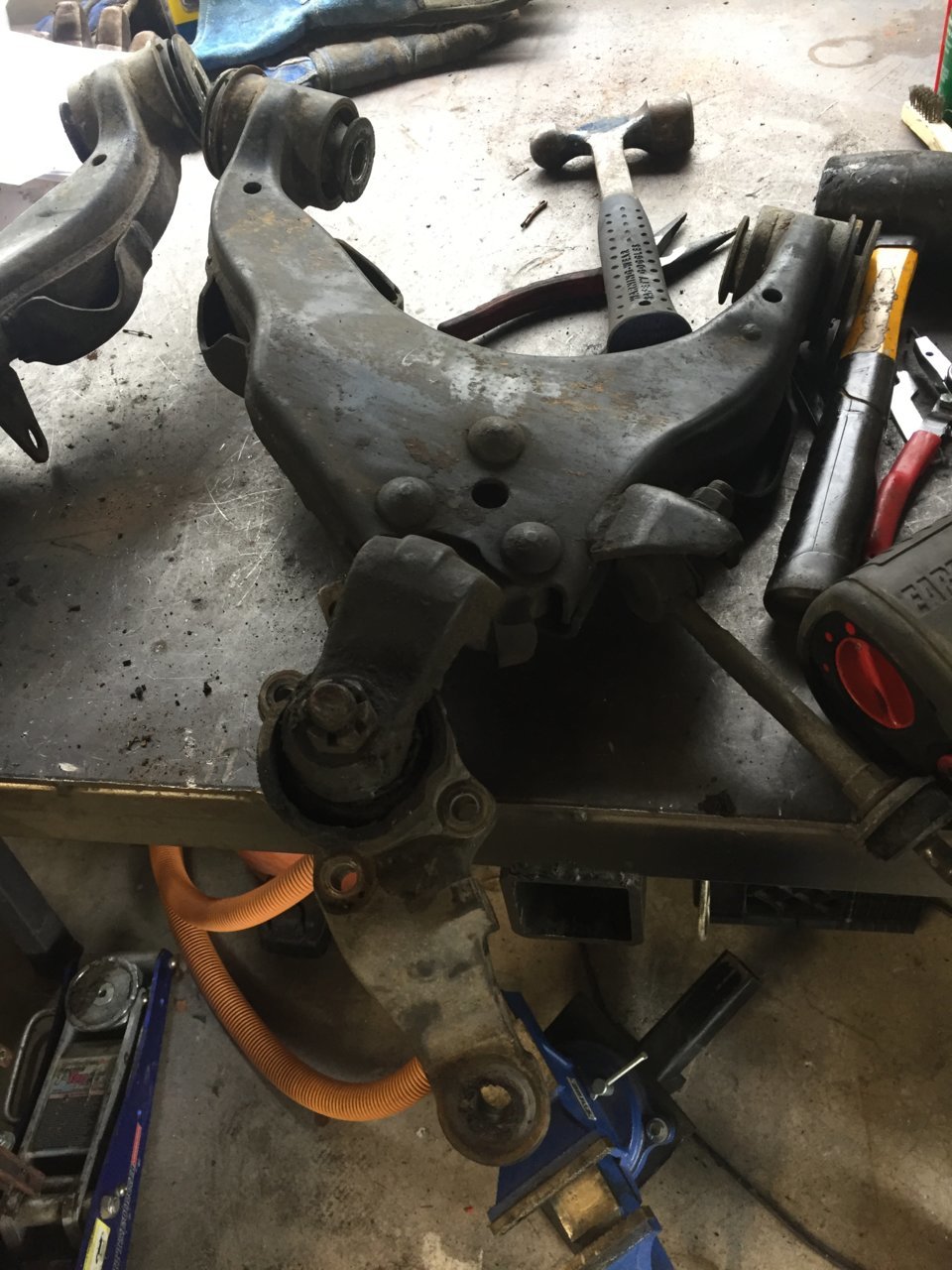

    Banner/ HulkSmash, Chapter IV: Naked & Afraid
    I’d watched Bruce install mid-travel on a 3rd gen Tundra just before we started tearing down this 1st gen so I thought I had an idea about what was entailed—wrong! Here’s how much was removed from the 3rd gen before the new suspension parts were added:
    Here’s what was removed in preparation for long travel (front):
    IMG_6219.jpg IMG_6223.jpg IMG_6224.jpg IMG_6225.jpg IMG_6227.jpg IMG_6228.jpg IMG_6229.jpg IMG_6230.jpg
    Note the adequate for street but not for SGU Shenanigans coil bucket:
    Yeah... DON'T worry!
    Removing steering rack:IMG_6265.jpg IMG_6268.jpg
    Test fitting with upper control arms for new heavy-duty coil buckets:
    IMG_6277.jpg IMG_6294.jpg IMG_6296.jpg IMG_6297.jpg IMG_6298.jpg IMG_6299.jpg IMG_6302.jpg IMG_6303.jpg IMG_6305.jpg IMG_6307.jpg IMG_6319.jpg

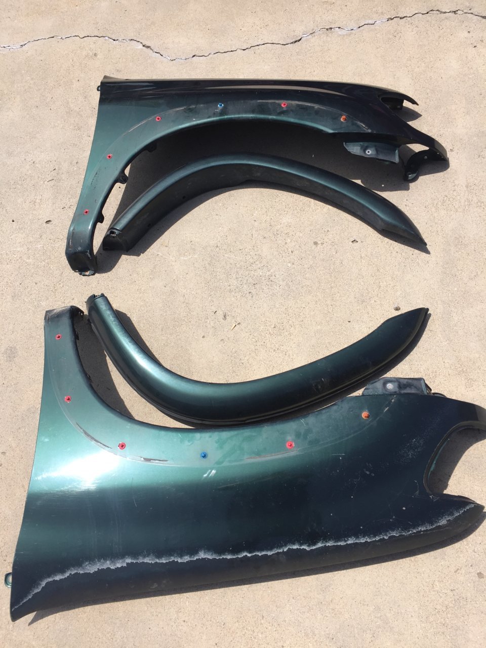

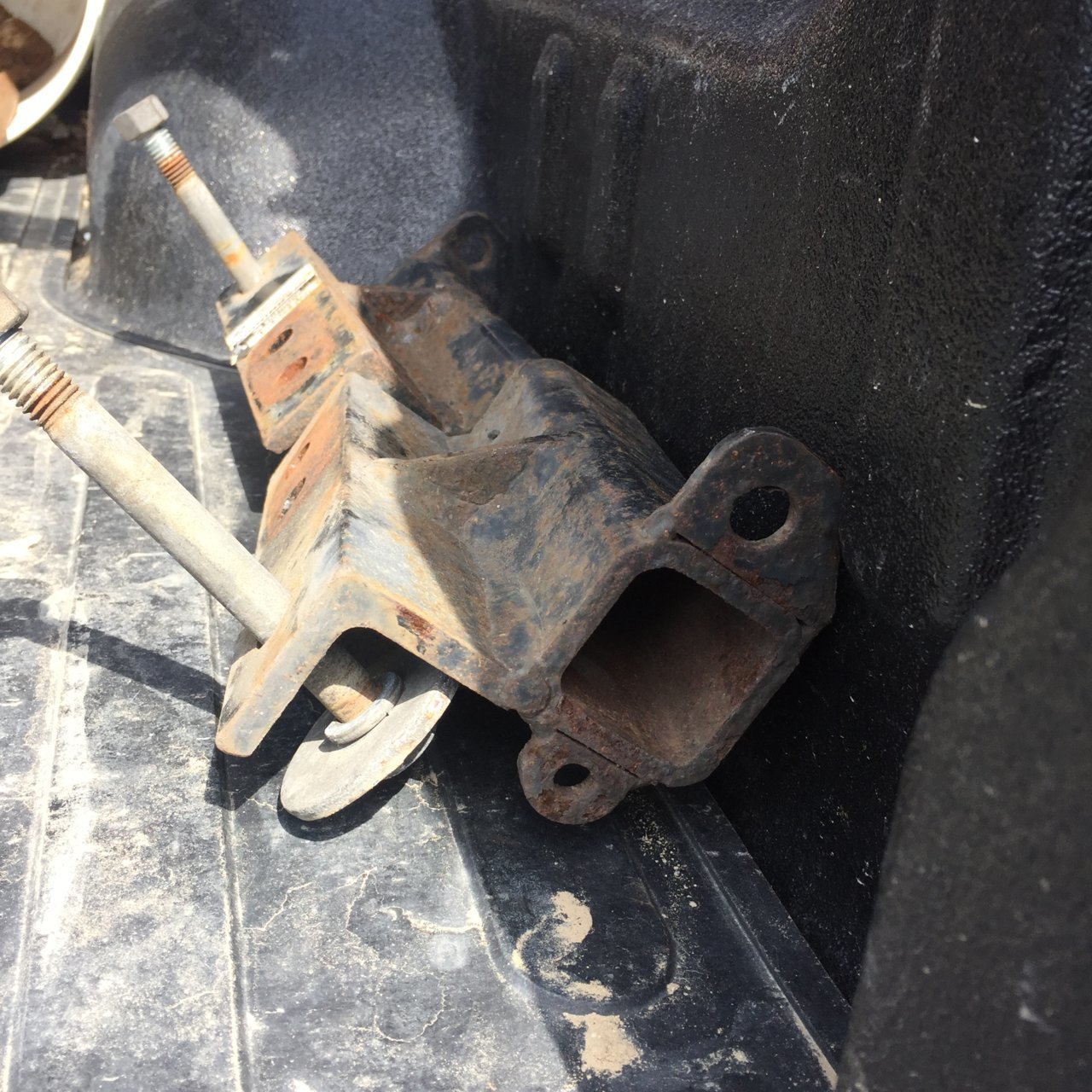

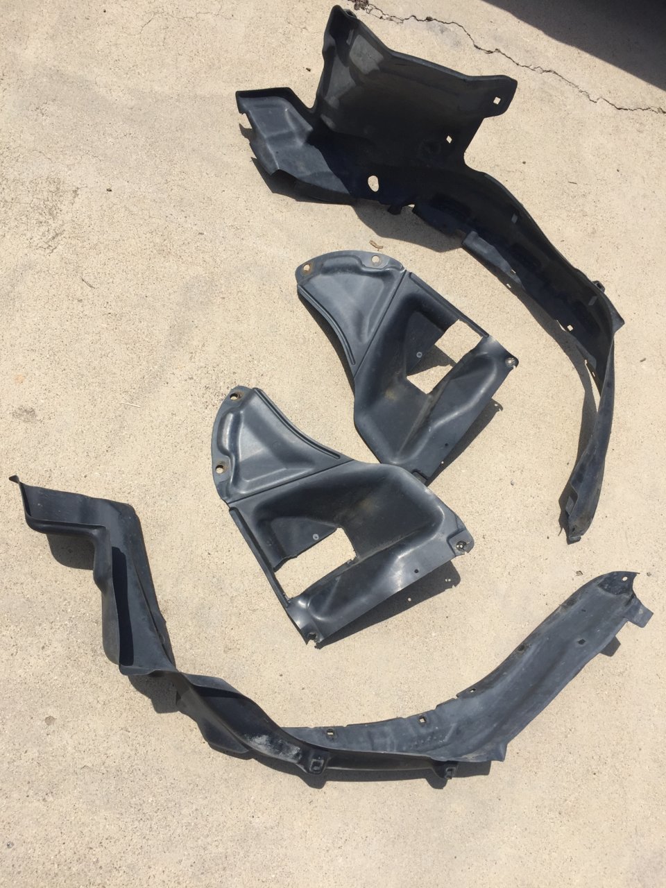

    Chapter 5: Growing Commitment-- Saying Goodbye to the Exes (Free Take-Offs):
    Anyone in SoCal need free take-off from a 2002 Tundra? PM me and I'll respond after T2S. No written descriptions until I return from T2S (no time), but that means the bots won't tell non-members. Here's pics of what appears usable:
    Edit:
    I donated everything that wasn't claimed to local parts yard near me. Didn't care about money, just wanted to minimize waste.
    I may re designate this post... or to keep the chapter title, I may post up future trade-outs. I have OEM wheels to sell....
