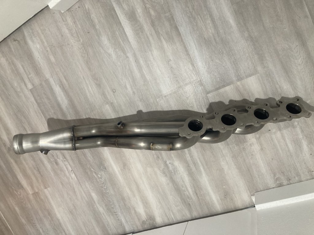

  14. May 12, 2025 at 5:38 PM
    #44
    Mdl
    Mdl Hey there...
    Jun 14, 2023
    #98638
    4,765
    PNW, WA
    2007 TRD SC'd
    JBA 1 7/8 Longtubes, Snivs 1.88 SC pulley, ASP crank overdrive pulley 6.71 in, DD Full 3inch dual exhaust, IPT Trans/valve body, 4.5inch intake with 10x2 SABM, FIC 880/930cc injectors, 450 Walbro, Direct Port W/M injection, GM 95mm TB, DW fuel regulator, E-fan, Remote engine air/oil cooler, Camburg UCA, Icon shocks, Speedmaster LSD, Motive 5.29 Gears, Mickey Thompson Baja Legend EXP 35's, Solid Offroad engine and transmission mounts, DIY Traction Bars, Tuning by Snivspeedshop.com
    Any more headway on the jba style headers?
  15. May 12, 2025 at 7:08 PM
    #45
    Cfincke
    Cfincke Mall Crawler but capable
    Jul 7, 2016
    #3797
    1,855
    San Antonio
    2014 Tundra 1794 CM 5.7 4x4 sunset bronze
    5.29s, Auburn LSD, 37x12.50R18, Icon coilovers and shocks, SPC UCA's, Tech 12 Volts sound system, Enve Grill
    ARH or Stainless works?
    Have your TRD replacement exhaust with turn down dumps before the rear axle.
  16. May 12, 2025 at 7:20 PM
    #46
    Mdl
    Mdl Hey there...
    Jun 14, 2023
    #98638
    4,765
    PNW, WA
    2007 TRD SC'd
    One nice design on the ARH headers is the single air tube for the aip system. Makes it for a little bit easier install.
    Cfincke[QUOTED] likes this.
  17. May 12, 2025 at 9:03 PM
    #47
    dirtydeeds
    dirtydeeds Exhaust Fabricator Vendor
    Dec 19, 2015
    #2282
    3,373
    Keith
    USA
    2003, 2006, 2013, and 2023 tundra
    more than I can list here
    Real close to getting a set over to my header guy. We have been in the middle of reproducing S&S headers for first gen. Should have 20 sets in my hands this week or next. Then 2gen is up!!
    ZPhilip and Mdl[QUOTED] like this.
