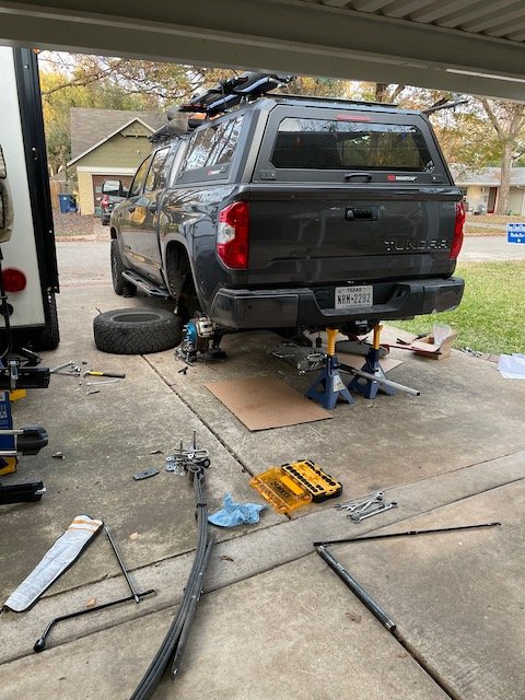

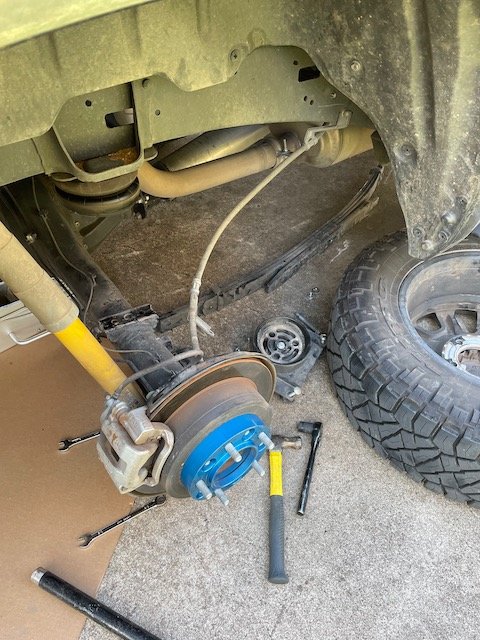

    I got them installed last night, by myself. Ran out of light before final inspection and torque down so I'll be doing that here in a bit. 4 jackstands, 2 jacks, 2 prybars, and a heavy rubber mallet were crucial. I picked a terrible month to not drink.
    I feel like I wrestled Andre the Giant.

    Trying to remember my phone conversation, but between my 800lb springs and 1" Coachbuilder shackles, I was expecting a 1-2" lift. My rake looks so ridiculous right now. It's pretty comical. Hoping it will settle a bit over a month then I'll make some front suspension changes to level it.

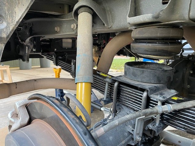

    Yeah, I was looking for the smallest lift I could get. Between my SmartCap, Roadshower, bike slide, hundreds of pounds of camping/riding gear, bike rack, and yes, travel trailer, I've been hangin' ass for a while.
    Oh, and those are my Firestone airbags. Alcan folks said they work great with this setup so I'll give them a try. They get me out of so many situations when towing.

    I can’t imagine that Alcan would say those are functioning properly after only 20k. Curious what they say when you reach out to them.

    So, as it stands, the 800lb Alcan leaf springs and +1 Coachbuilder shackles raised me up 2.25". I'm going to give it a few weeks and level the front. I would love for it to settle a hair but damn it rides so much better.
