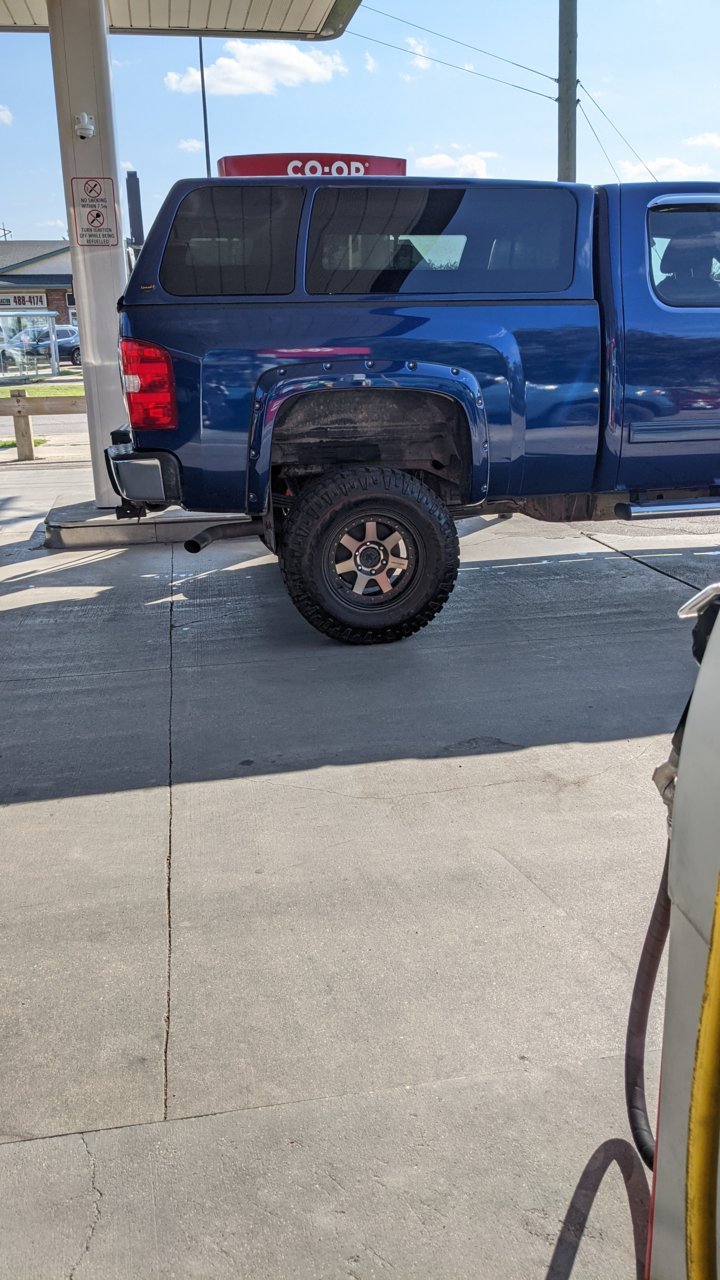

    badmotofing3r To be so civilized, one must tell civil lies
    Oct 31, 2020
    #54296
    259
    Zach
    Wyoming
    Hot Tamale
    Toytec lift and the works
    Not my garage.... I wish

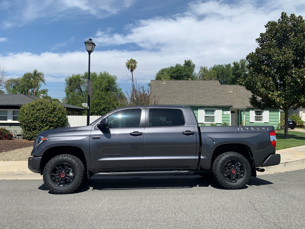

    2021 Tundra TRD Pro Crew Max
    275/70/18 BFGs, TRD Cold Air Intake, BRShine LED light swap, FRAC front camera, ESP Under Seat Storage, Rocky Mounts bike holder, tinted front driver and passenger.
    275/70/18 BFG KO2s on stock TRD Pro.
    Noticed a slight power loss, but after ten minutes of driving you forget what you had. Have thought about adding the Westcott Designs 1.5" front and 1" rear to it as it's touted as not impacting the ride quality and keeps factory geometry. Anyone have a 3.5" lift with 275/70/18's?

    Mdjamesd
    Mdjamesd New Member
    Feb 20, 2018
    #13027
    126
    2015 Silver Sky Crewmax
    I think a 3-3.5" lift with 275/70's would look like your truck missed leg day

    BravoDeltaRomeo
    BravoDeltaRomeo Old Man Little Blue Finger
    Sep 3, 2019
    #35569
    3,748
    Bruce
    MB Canada
    2019 Cavalry Blue Tundra CM
    Like this guy I snapped a pic to show our son. :militarypress:
    Front was the same.
    D4x4TRD likes this.

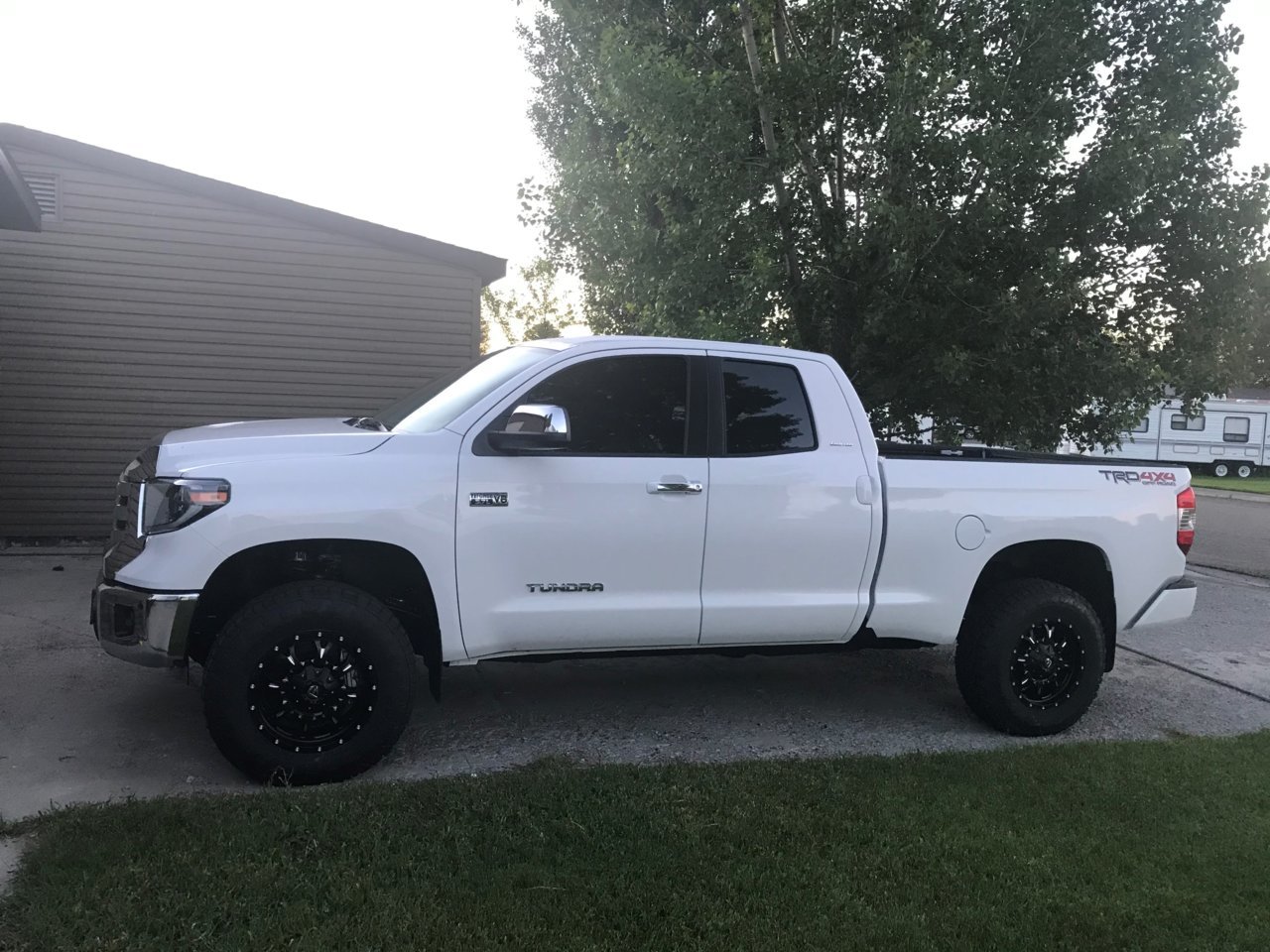

    Rebel Toy
    Rebel Toy New Member
    Jan 26, 2022
    #73716
    28
    2020 Tundra Limited
    3-1 Low Range lift, Bilstein 5100, 285/70/18 Nitto Ridge Grappler, Fuel Quake Wheels Flowmaster 40 exhaust
    2020-2.jpg275/71/18 K02 Fuel Kranks
