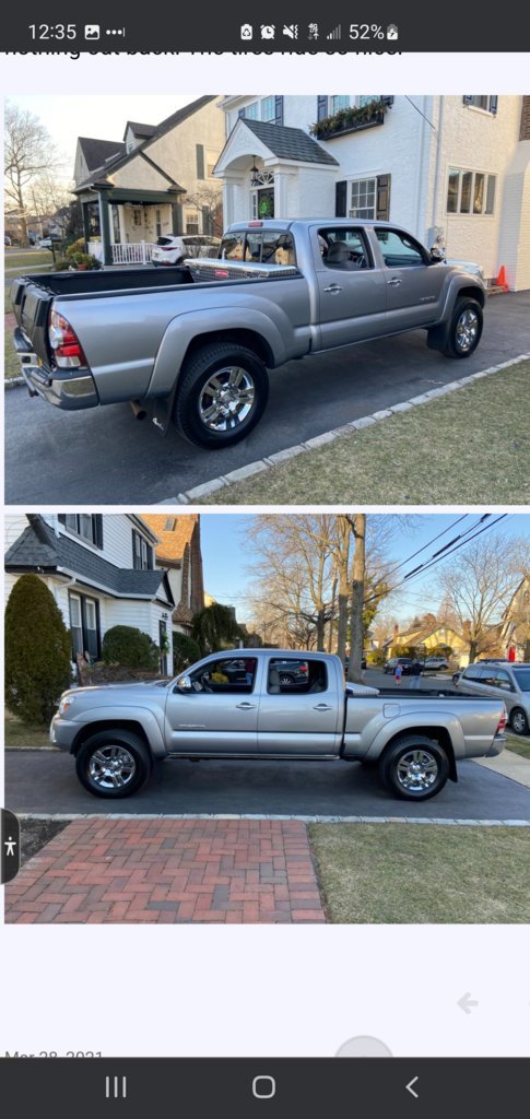

  13. Oct 21, 2024 at 11:26 PM
    #1033
    Tlar25
    Tlar25 New Member
    Mar 28, 2023
    #94598
    221
    2006 DC SR5 4x4

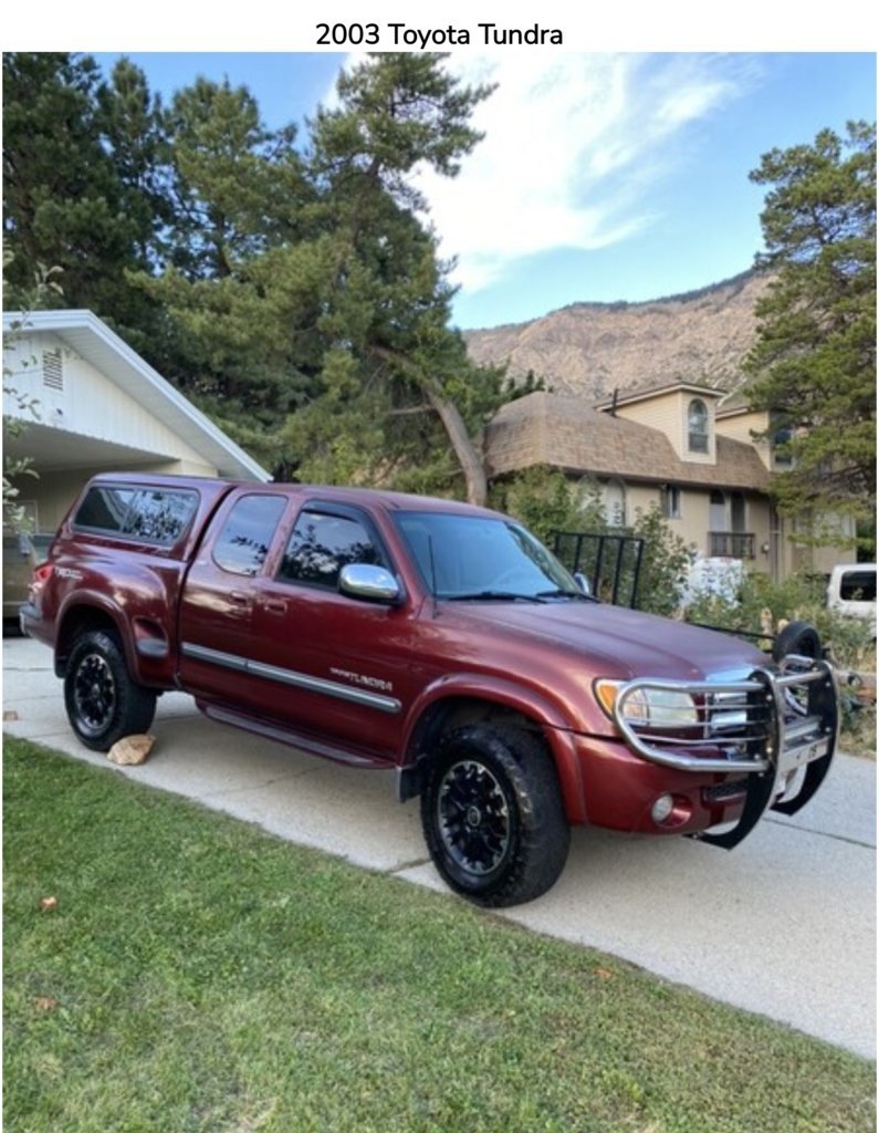

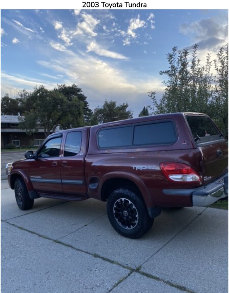

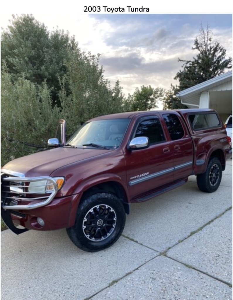

    These are turd Gen Tundra 18's. Not too bad looking either, my brother is running the same ones on his 1st Gen Sequoia with adapters.

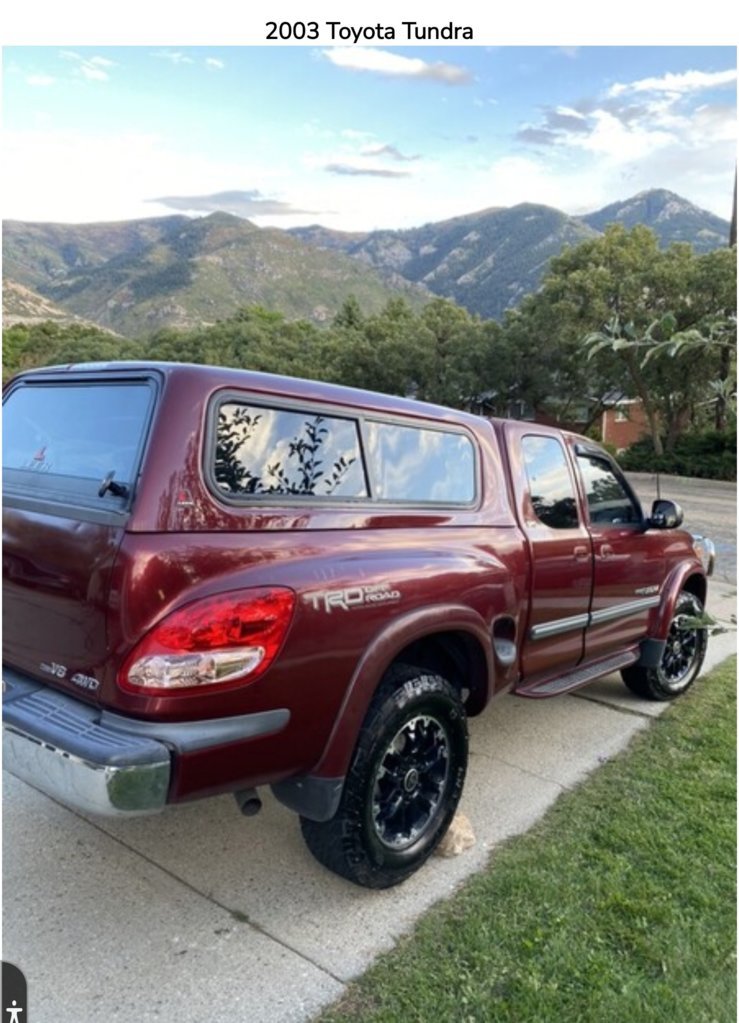

  14. Oct 21, 2024 at 11:30 PM
    #1034
    Tlar25
    Tlar25 New Member
    Mar 28, 2023
    #94598
    221
    2006 DC SR5 4x4
    A few more random pictures I've saved whilst browsing the internets. Sweet 80 series 16's on the last one. Saved from that one thread on here about tubbing for 35's.
    G_unit3000 likes this.

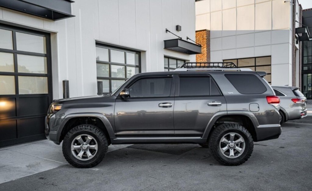

    I still think the 4th Gen 4runner 18's are the best looking option

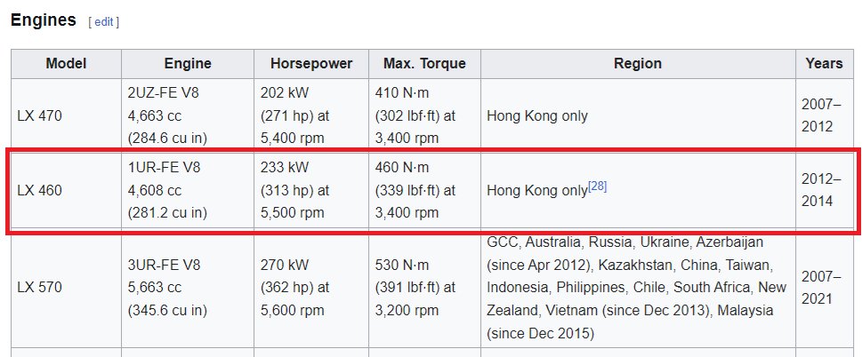

  22. Oct 22, 2024 at 7:42 AM
    #1042
    Tlar25
    Tlar25 New Member
    Mar 28, 2023
    #94598
    221
    2006 DC SR5 4x4

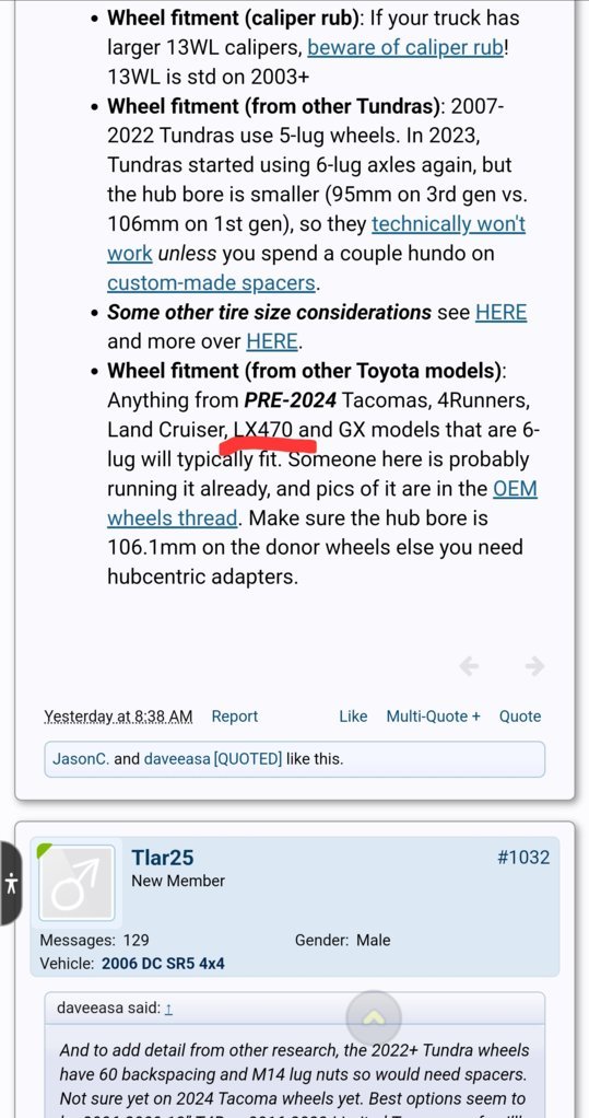

    This is a 5 lug wheel is what I'm saying. I could've sworn I read lx460 on one of these comments but I must have just misread. My mistake.
  23. Oct 22, 2024 at 7:57 AM
    #1043
    shifty`
    shifty` Inside his chest they found ten thousand pencils
    Jun 20, 2020
    #48239
    30,664
    ATL
    '06 AC Limited V8/4WD
    Wasn't me. I haven't edited the megathread in several days, and didn't edit my comment above. I see above where @badass03taco says "LX460" but ... to be factually (akkkktually :rofl: ) correct, looks like there technically was an LX 460, but it was China market only. See below.
    I could be wrong, but I'm fairly certain all GX with 6-lug wheels from 2002-2022 are same lug pattern and hub bore. Always interested in exceptions to the rule.
    Would it read more true for you if I included a comma after the "470" in the image you showed? Don't want to confuse anyone, and if it read funny to you, it probably will read funny to others. Being genuine here, access to clear information is important.
    Tlar25[QUOTED] likes this.

    Ah! Dang those Chinese :rant::rofl: that's funny though now I'm curious to learn more about that. But yeah as far as I know as well, all US market Lexus GX's up until the new 550 which changed with the tgnaf platform or whatever it's called, should be the same 6 lug pattern and hub bore. Maybe different on foreign market Prado 120's and 150's but I've never seen anything different on those either.
    I would just change lx470 to lx450 if it were me, and specify 80 series Landcruiser. It probably doesn't really matter, if you buy 5 lug wheels for your 6 lug vehicle, that's on you lol.

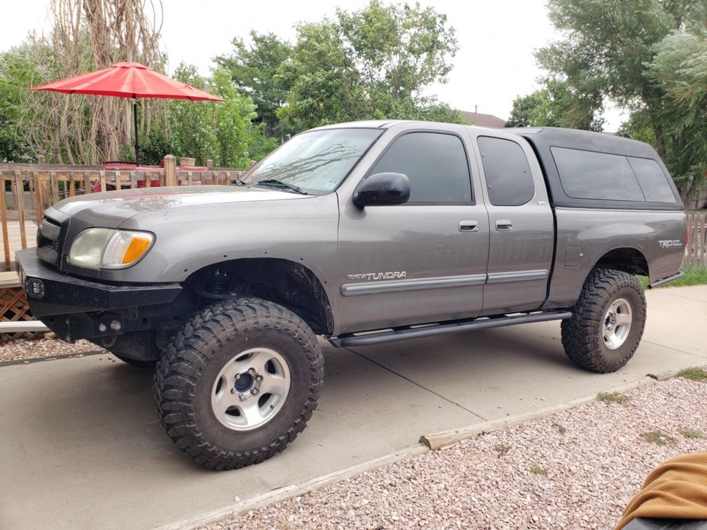

    I tried a set of 80 series wheels just like those a couple years after getting my 2000. Rubbed on the calipers in the front. Good spacers weren't available back then. Does look good.

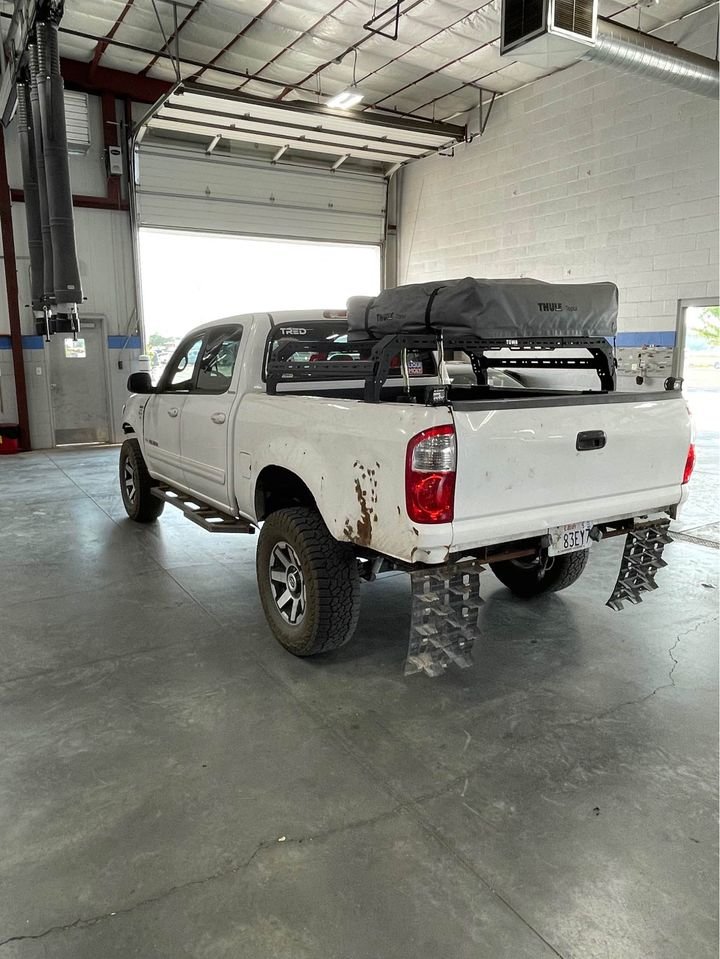

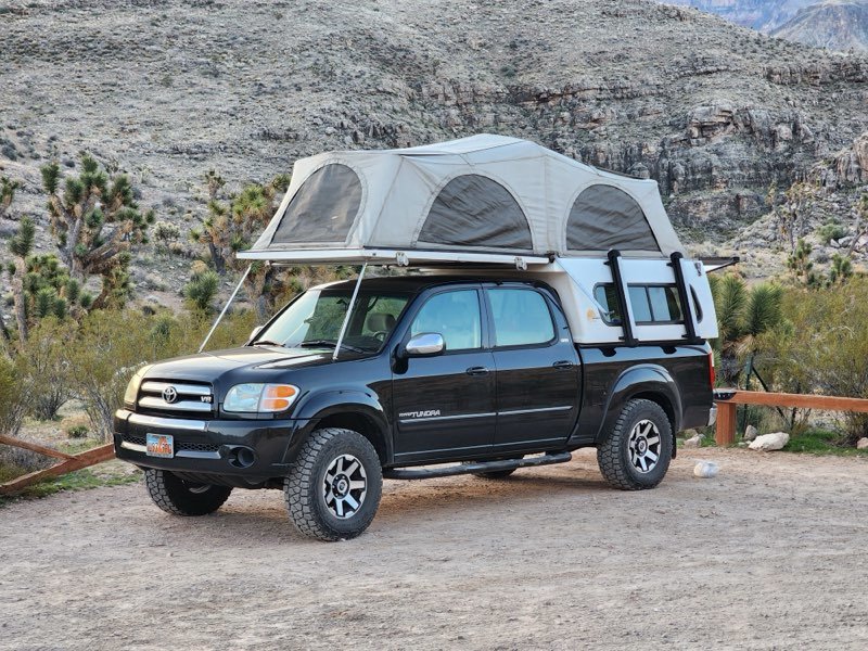

    Aluma Series, JBA UCA, Wheelers add a leaf

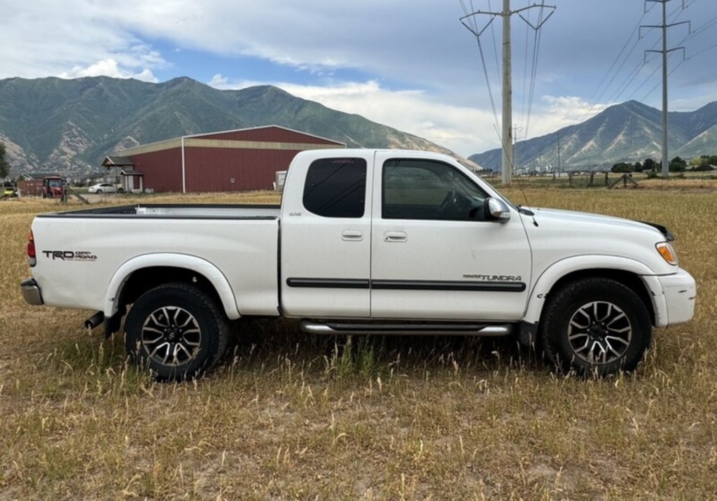

    These and Ivan’s are the ones
