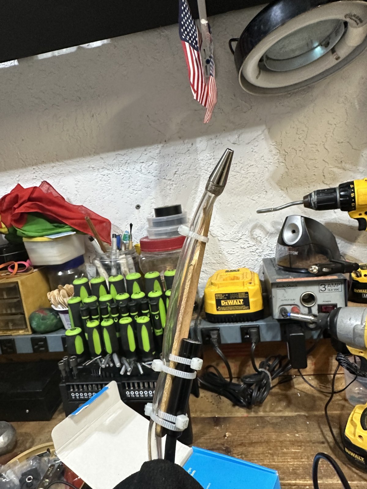

    The top of the seat area is the hardest to get at. See picture in my original post. So I built a rig. I used the end of a pen, where the actual writing bit comes out. Attached that to fish tank tubing. Packed pen part with silicone based grease. Tyraped it to a popsicle stick. Tyraped the other end of popsicle stick to endoscope so I could see when pen part was directly at point which I wanted to lube. Then I blew through tubing to force grease at desired point. No seat disassembly was required. Seat has been completely quiet for six months and 5000 miles. upload_2023-10-27_12-15-53.jpg

    That is so cool! I wish you were my neighbor…we would get along great!
