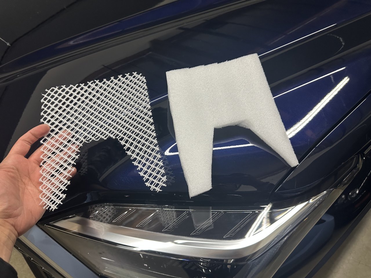

    sungzilla
    sungzilla New Member
    May 9, 2023
    #96773
    5

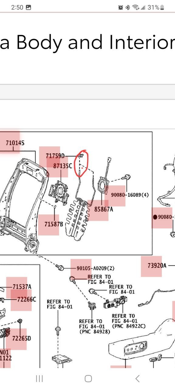

    Well I had 2 different noises.
    this was one of them.
    Yes so those mesh looking materials are sticking to foam padding.
    I cut some packaging material replaced and it’s been a month. No sounds.
    RickyBobbysTundra likes this.
  2. May 10, 2023 at 11:01 AM
    #62
    sungzilla
    May 9, 2023
    #96773
    5
    ok that’s another noise i had. you need to put padding between verticle springs on the very top. Need to unzip the seat.

    I actually had 2 noises and even dealer couldn’t figure it out so I decided to unzip the back
    if this doesn’t solve the issue. Let me know. I could guide you how to fix the other creaking noise when you are pushing the seat against it.

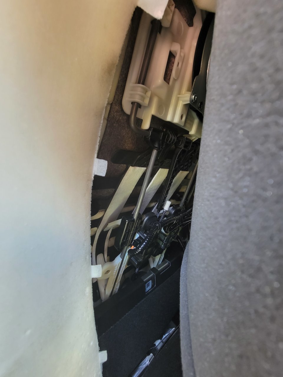

  13. May 31, 2023 at 2:32 PM
    #73
    LouALouA
    LouALouA New Member
    Feb 5, 2023
    #91492
    122
    Lou
    Central Florida
    2023 1794 Blueprint 4x4

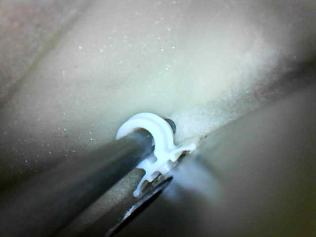

    I have a 2023 1794 and also have the seat creaking issue. It's coming from the drivers seat back, between my shoulders. I unzipped the seat back. I tried spritzing some WD in the locations pictured but it didn't quiet the creaking. I also tried tightening the plastic clips that those metal bars mount to, using tyraps. Didn't work either. While in the seat back I pulled on the seat fan assembly and could hear the creaking and feel the vibration which I believe is causing the creaking. Following the vibration with my finger tips as I pulled on the fan assembly. The vibration feels greatest from the top of those two metal bars. I can't get to the top mounting point for those bars without disassembling the seat. The Tundra is still under warranty and this is as far as I'm willing to go. I'm convinced the creaking emanates from where those two rods connect at the top of the seat. I don't see where they connect in the parts diagram. Item 9. But that's my two cents.
    batman900 and RickyBobbysTundra like this.

  16. Jun 3, 2023 at 1:24 PM
    #76
    LouALouA
    LouALouA New Member
    Feb 5, 2023
    #91492
    122
    Lou
    Central Florida
    I went back and wiped the WD off and instead lubed the metal rails with a clear silicon based grease. I moved the lumbar support up and down to work it in. I was able to move the fan slightly up and down with my hand. Used the grease from my automatic espresso machine. Takes heat and won't harm plastic. Some very sharp edges on the seat frame. I couldn't reach the very top of the rail mounts with my hand. I believe most of the creaking is coming from them rubbing with their mounts (717590). I offered a blood sacrifice, still no go. So I built a contraption in order to grease the rails above and below those mounts. I couldn't get grease inside the mount but maybe over time it will work its way there. Much quieter but not silent. Don't have time to take it to the dealer before my 1200 mile trip next week.
    [​IMG].
    *Update: Grease must have made it into the upper mounts. Completely silent now. Going on a seven state 1200 mile drive next week. Will see if fix holds up.

    Supposedly they fixed it. Here is what they did.
