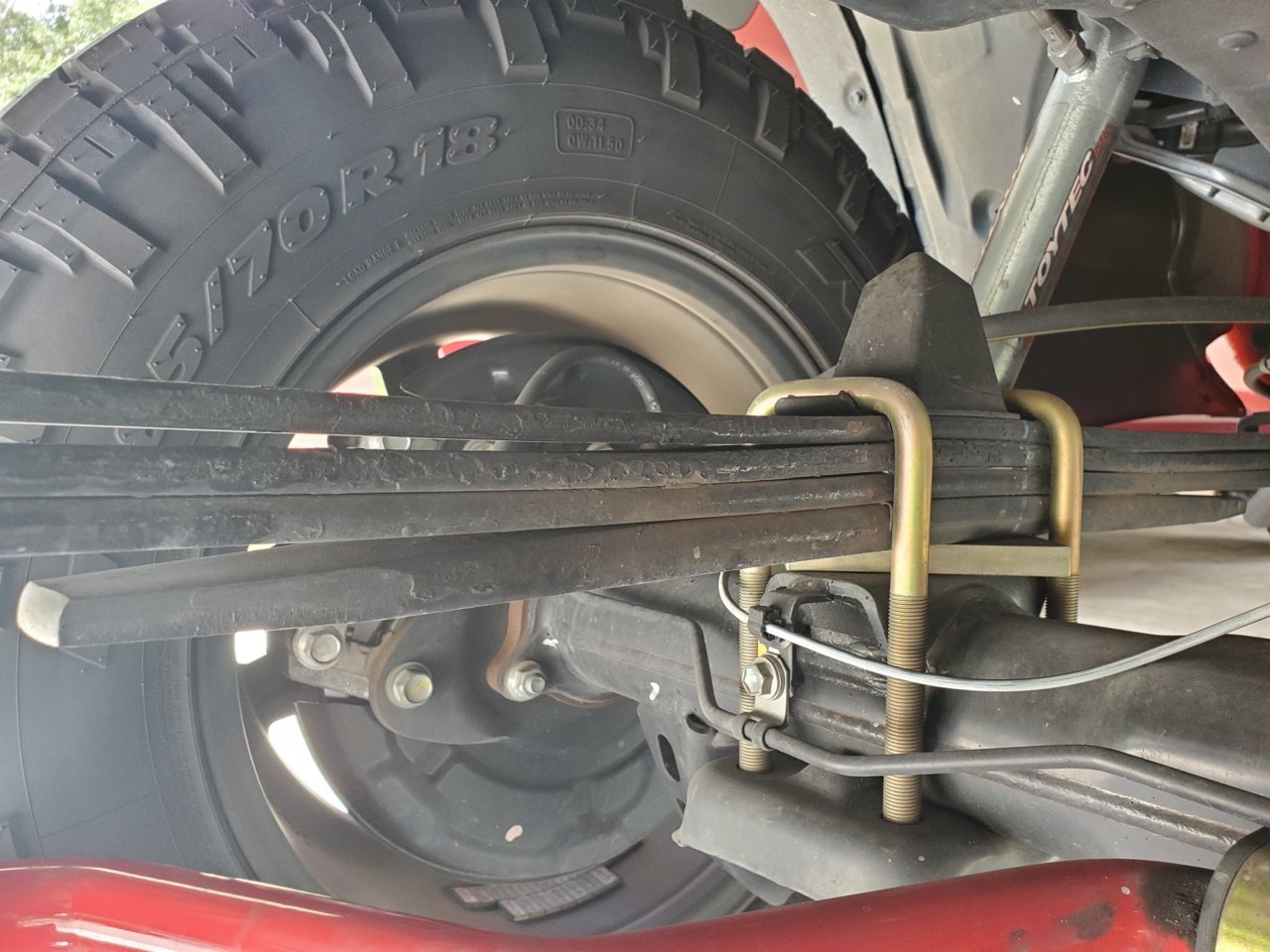

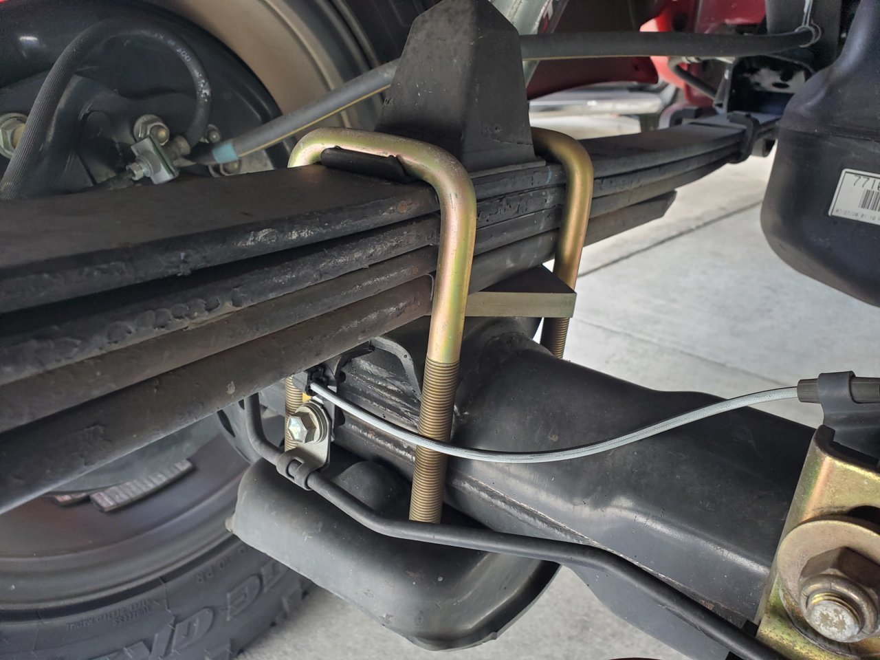

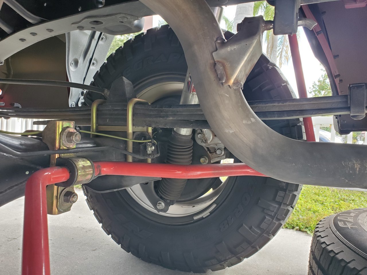

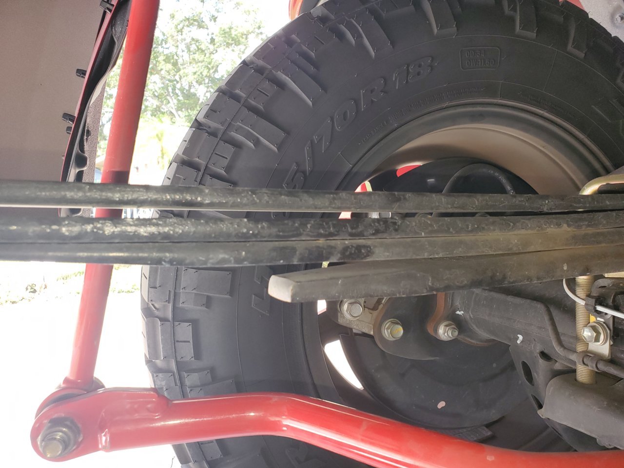

    So I have this annoying creaking noise pulling in and out of the driveway. I found where it was coming from, now I'm at a loss on the fix. The rear 1/2 block walked out of position so I will have to fix that and retorque the ubolts. As far as for the leaf spring, it has a gap that is about 1/4 inch or so between the leafs. Here are pictures of the passenger side, and then the driver's side.

    Springs look worn, with negative arch. You could replace with stock take offs for super cheap. Or maybe an add a leaf (remove the block) will tighten it up. Or, aftermarket 2 inch lifted leafs but those can get pricey.

    I really think those blocks caused warp. I would be looking at new leaf packs, no blocks, that give you the height and load capacity you want.

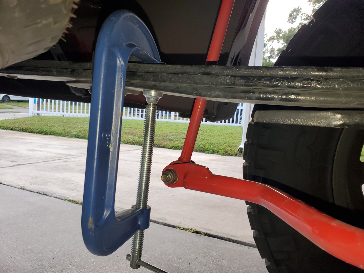

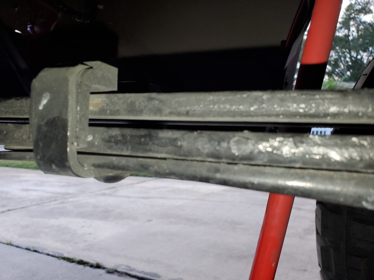

    So I went out and messed with it again. I put a c-clamp on the spring just forward of the rear retainer, and no more creaking. I see online that there are leaf spring clamp kits, but I would assume that something like that would only be temporary.

    Load those gaps up with grease and see if it stops creaking?

    A few of us (myself included) in the first gen world have messed around with leaf spring clamps, I bought mine at Autozone. Most notably they helped with axle wrap and keeping the rear wheels planted. I've had mine on for about a year - you're right, they're more of a band-aid but they were an improvement for me.
    They were cheap enough and easily available it might be worth trying in your situation. I do agree that your leafs look a little flat though.

    You can't put grease in a 1/4 gap.
