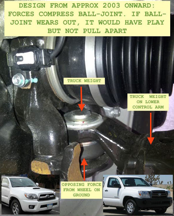

    I guess the thread dedicated to this topic is a bit much to read...But it'd answer your question.
    It's design flaw. One that was fixed in the next generation of Tundra/Tacoma/4Runners. Adding cheap, weak aftermarket parts to an area with a design flaw just compounds the issue. The best option is to go OEM, and replace at the recommended intervals.
    Only way to truly avoid this issue is to buy the next generation Tundra.

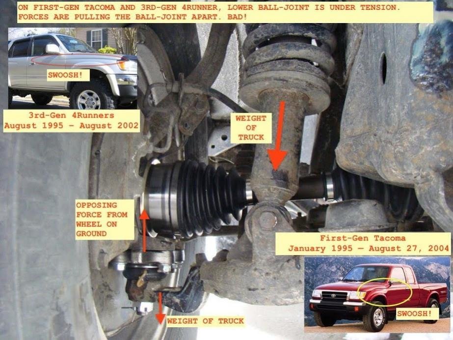

    The flaw isn't in the material or build quality of Toyota's lower ball joints. Its inherent to the design itself, and the orientation of the ball joints. The joint is always trying to pull itself out of the knuckle.
    If you look at 2nd Gen+ Tundras, 4th Gen+ 4runners, 2nd Gen+ Tacomas, 2nd Gen+ Sequoias, they all completely flipped the orientation of the lower ball joints. On these newer models the lower ball joint rests on the steering knuckle, versus the steering knuckle resting on the lower ball joint (this makes all the difference in failure potential).
    So knowing the design is flawed, the best way forward (if keeping the vehicle) is to replace the lower ball joints proactively with the best available option on the market, and that is OEM Toyota.
