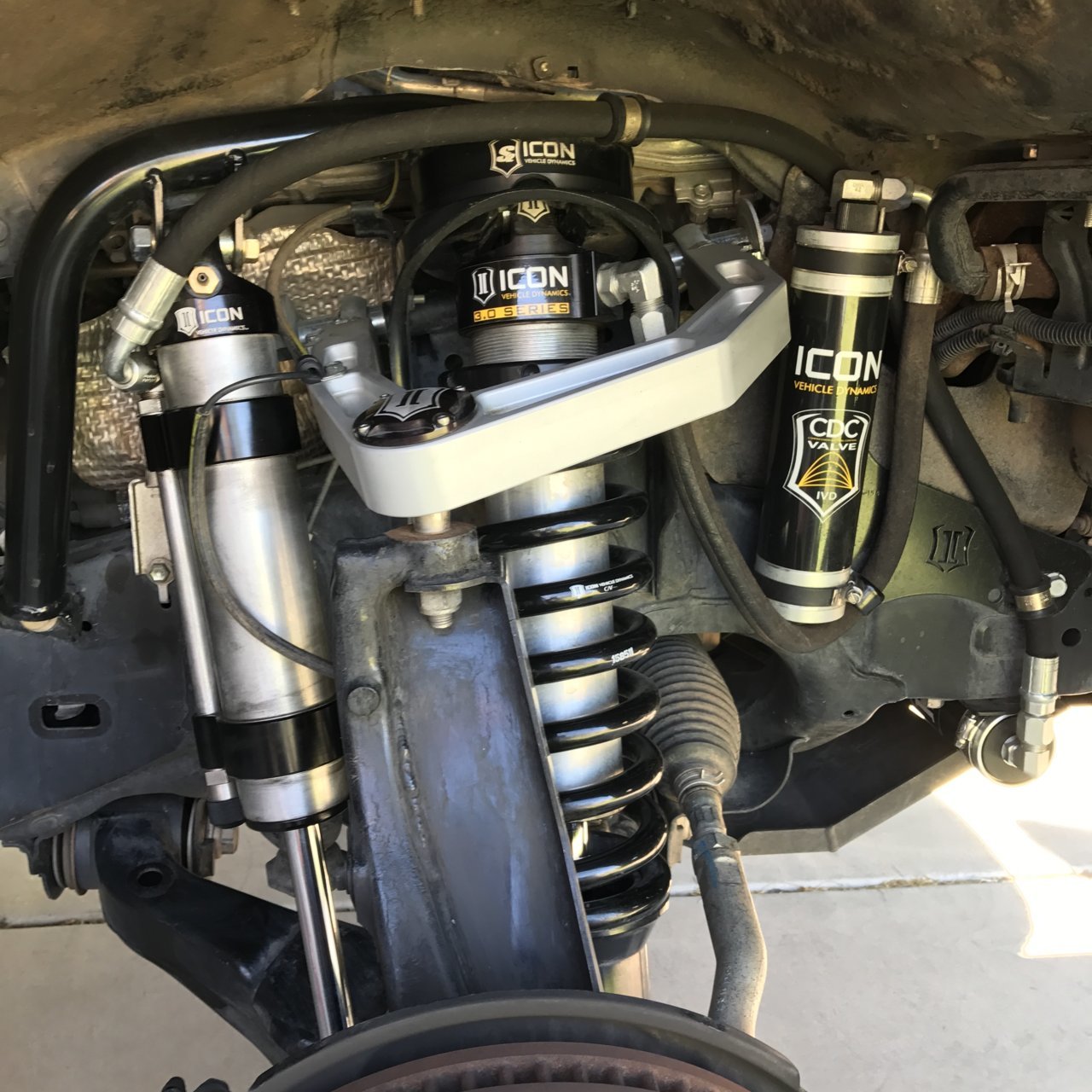

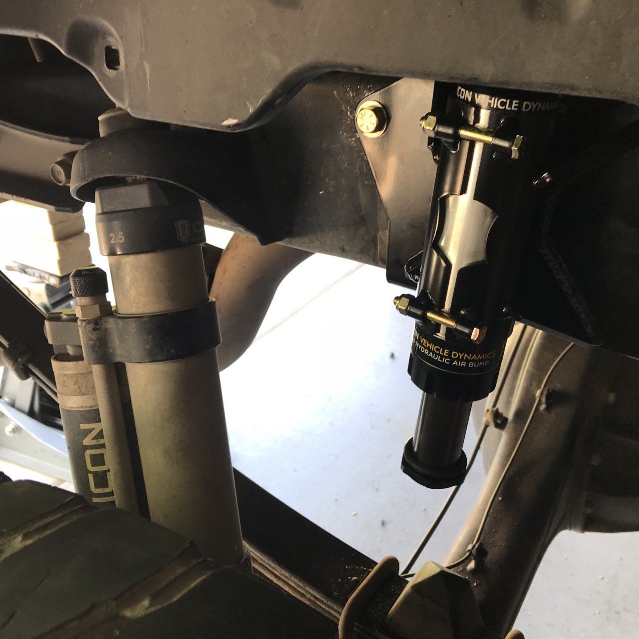

    I haven't read through the whole thread, @papasmurf tagged me in earlier today and I haven't had time to read through everything.
    I'll assume most everyone has described how much each major manufacturer is pretty similar, which is largely true.
    For us it came down to ride quality and flexibility of use. Our Tundra is my wife's daily driver and our part-time high speed overlanding rig, so we needed comfort on the road and control off road. That led us to seek a suspension with digressive valving and clickers. Only Icon offers digressive valving off the shelf (most any can be tuned to be more progressive or more digressive, but to completely flip the curve properly requires re-profiling the shock piston face and ports).
    Somewhere on this forum I described the differences between progressive and dogressive, but can’t find it immediately (maybe someone can find the link?).
    anyway, long story short (I did months of research) we went with Icon to get the digressive valving and we got bypasses with clickers so they're adjustable. All parts and some of the install done by SDHQ.
    Front
    3.0 coilovers (with your bumper you probably want stiffer springs)
    2.5 bypass
    Adjustable upper control arm (to help us clear 37s)
    Rear
    2.5 bypasses
    Bumps
    3/4” shackle
    1” block (to clear 37s)

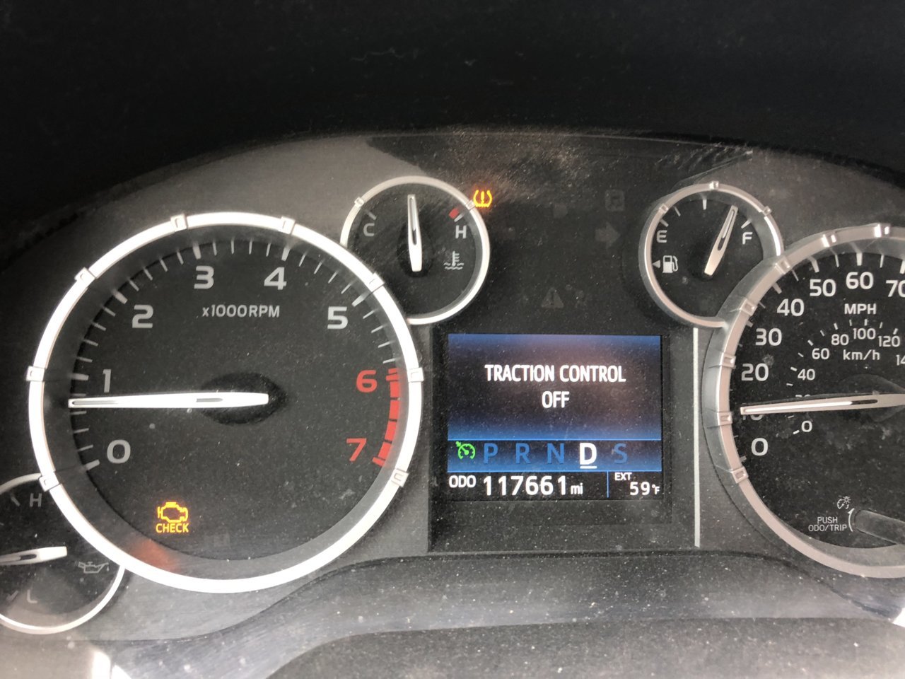

    Thanks for the suggestions! I’m excited to get a setup. My check engine light just came on and traction control OFF

    Save this on your phone in a special album so you can get to it easily. I haven’t looked through it yet for your combination.

    This has happened once before and I could not figure out what it was, so I disconnected battery overnight and reconnected the next morning. It was cleared. That was about 3 months ago.

    I gotta copy that chart. LOL I just learned from it that I've got a damaged TPMS sensor. Kinda knew that already but confirmation is nice.
