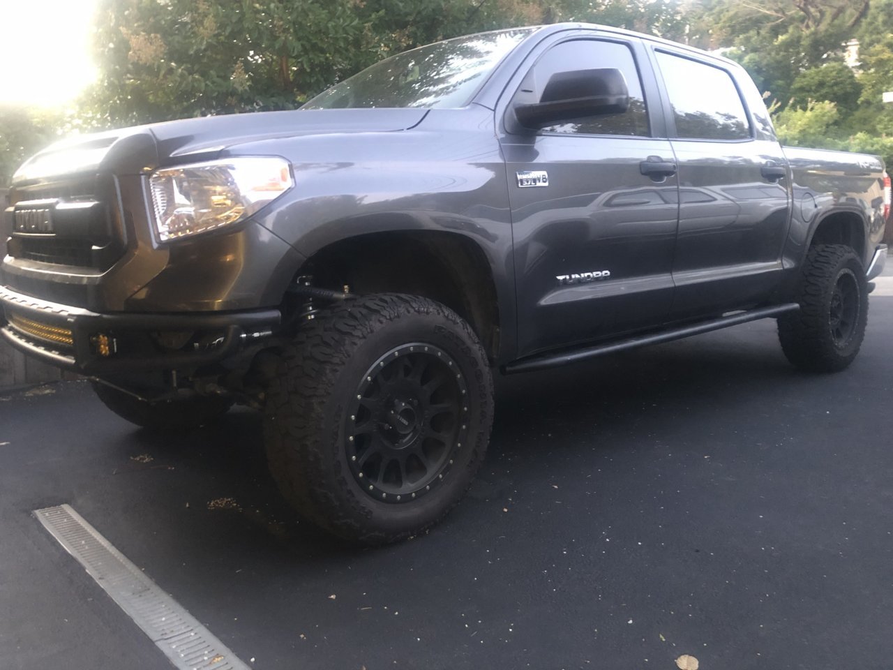

    63A83CDD-2576-4B81-AFCC-5ADE70D64B98.jpg I was in the same boat as you were, all went down to buy once, cry once. I choose the Kings, no RAGRETS here, lol.
