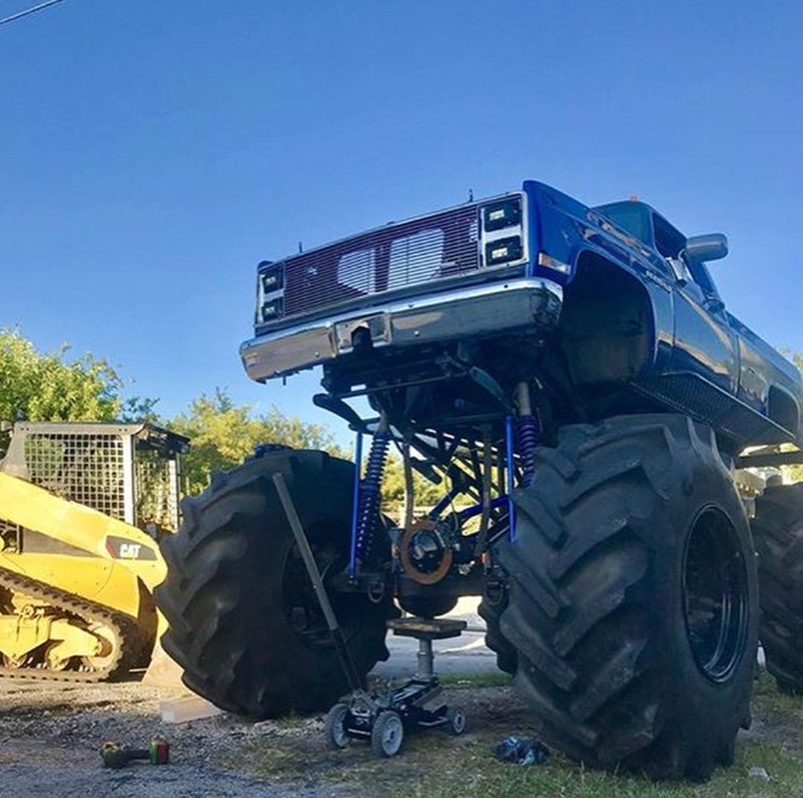

    2D63AB08-1FF8-4358-B348-B4776939A25A.jpg @TheBeast negative, they are pretty dang strong!!!

    Did the mud flaps rub on that setup.:D
    TheBeast[OP] likes this.

    @Tacotundra hahaha no clue I took that pic from the pro eagle Instagram page.
    Tacotundra likes this.

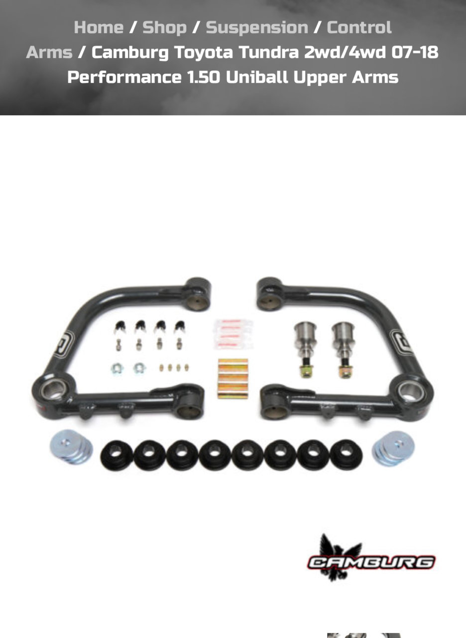

    9F3A7AC7-F9A3-4EB9-BC36-00901FFD0474.jpg I have the camburg tube UCAs with 1.5” uniball. There’s adjustments for those?

    Not really man just what you can get off the lower cam bolts. Flipping the tie rods will work or take it to a good alignment shop and see if they can get the clearance you need.

    Oh no!! That's no bueno. Might have to clearance the inside of those uppers they are huge. Or might be able change angle on fitting on the coilover for resi tube and move hose aft to get clearance also .

    Swapping tie rods left to right is the dumbest thing I’ve ever heard of, don’t bother. Your arms run too much caster, fight it all you want, or change arms.
