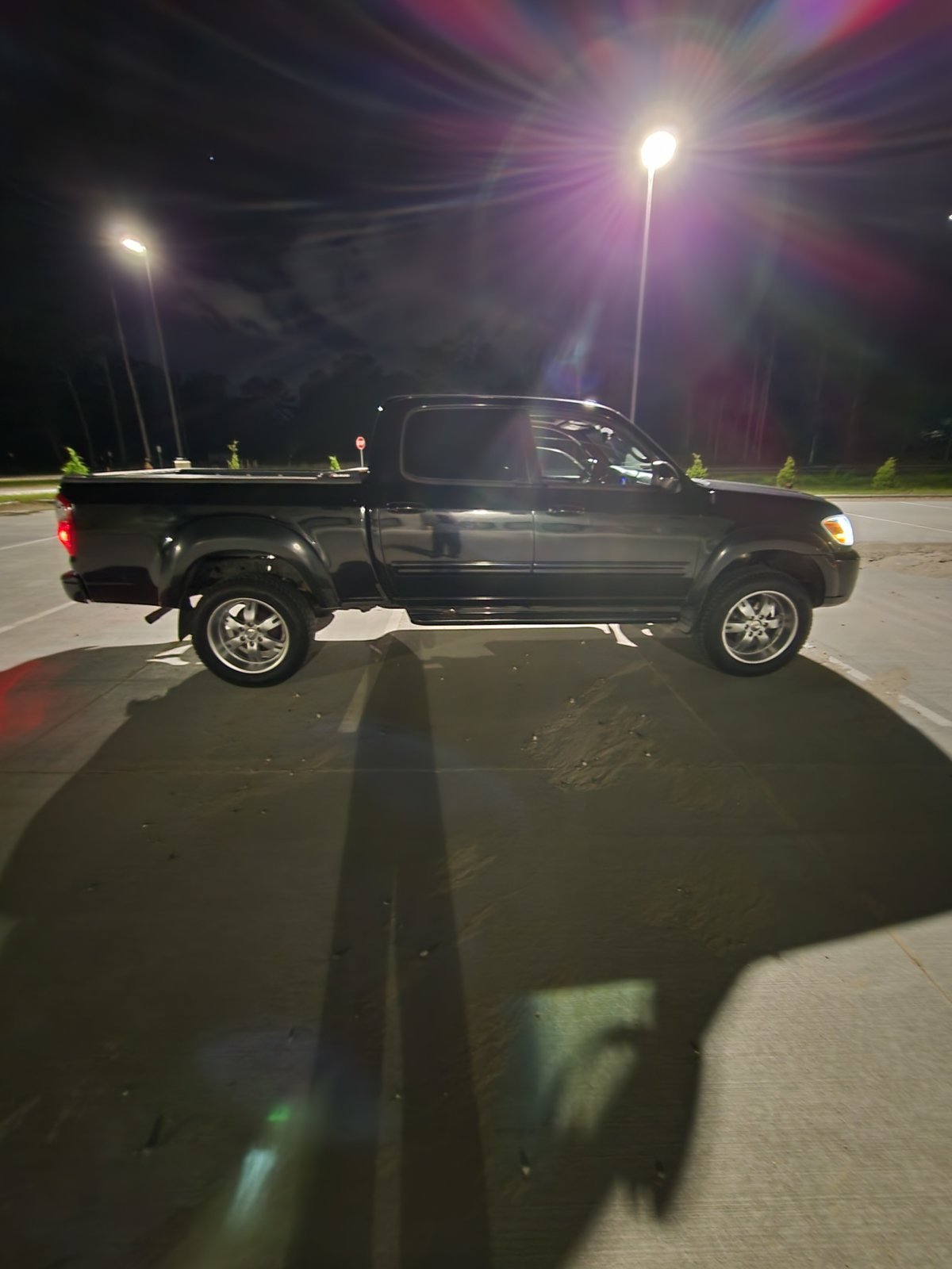

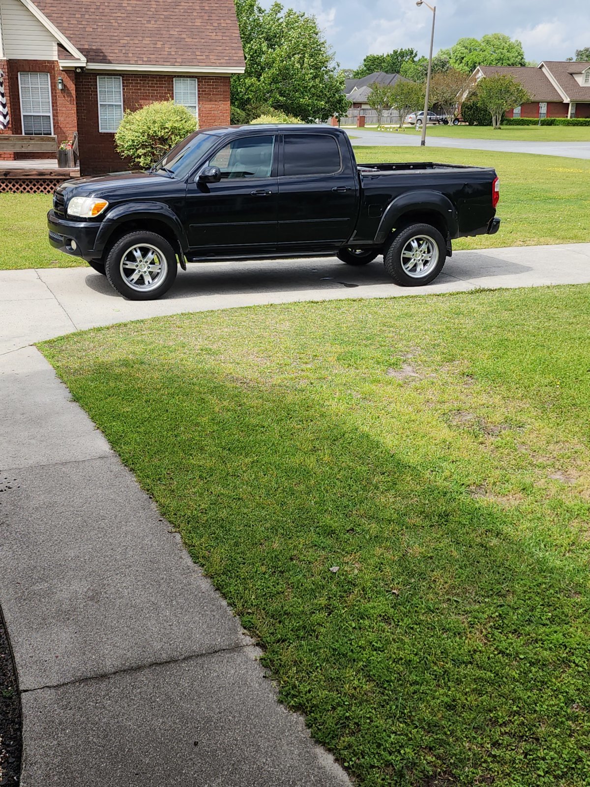

    Completed the timing belt and waterpump over the weekend, readjusted the rear brakes and lifted the rear 2 inches. The brakes when I purchased were mushy and went to the floor. I knew I had some work cut out for me. I didn't take any pictures but this forum helped out a lot. First I had to bleed all 4 corners with my brake bleeder and there were better but when I came to a stop I had to do the first pump of the brakes then the second was firm and engaged the brakes. The thing that's most important about these trucks IS the back brake shoes have to be adjusted properly and the e brake has to be adjusted as well to actuate the rear brake shoe adjuster and engage the rear brake cylinders. Plus you have to adjust the bolt on the back plate of the outer brake shoe assembly. Everything on mine were out of spec, the parking brake cable for the e brake was routed wrong and the brake shoes were not even adjusted close to the drum. So I had some issues and fixed them all and brakes work as advertised and e brake works within the first 4 clicks.
    I write all this to say make sure your trusted mechanic whether dealer or independent shops make sure they know what they are doing on your truck. Its our investment and safety that's at stake. Have a good weekend!!

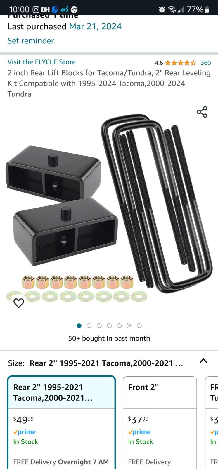

    Scamazon, pretty nice kit

    I will say, the pics make those u-bolts look pretty anemic.

    Same size as the original just longer

    With a longer bolt, I'd expect something fatter. Longer = more susceptable to bends. But you can't beat that price for everything. I just worry about quality, knowing bad crap can happen if one of those u-bolts fails. Maybe worse than what could happen if your brakes crapped out.
    This is why I don't buy parts on scAmazon. If something bad did actually happen, who are you going to sue? FLYCLE probably isn't even a real company.

    I can say with 1000% certainty that those are poorly advertised and will not fit the 2022-2024 Tundra.

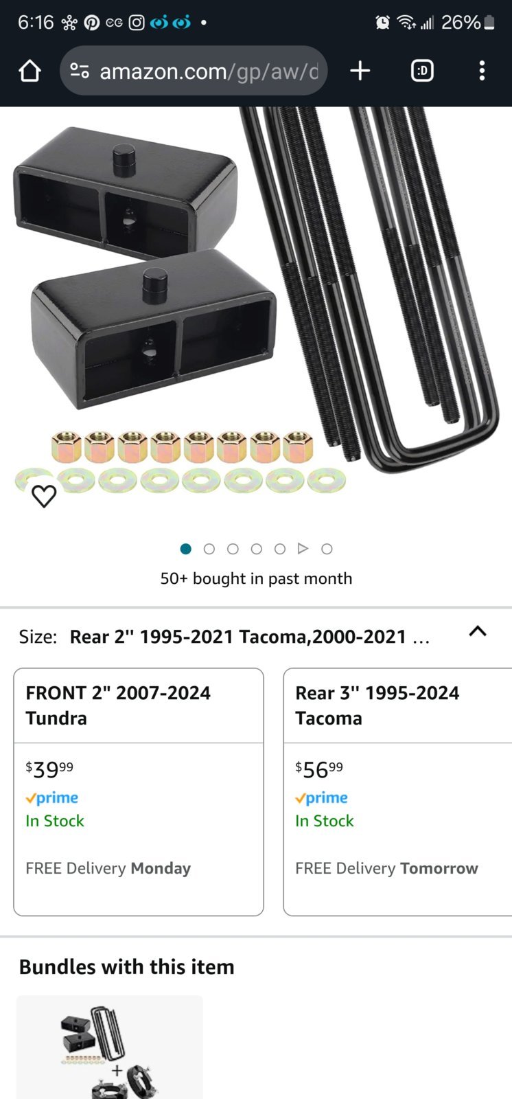

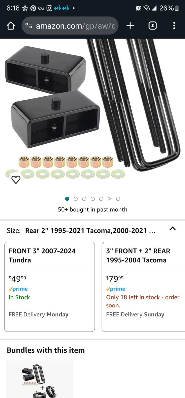

    You are 2000 percent right about not fitting 2024 tundra. But you also didn't scroll through the applications for the fit. We all know newer tundra don't have leaf springs for blocks. But maybe they have coils and shocks like 2.5 gen? I don't know but they list them for the fronts only.
    You can see where they bundle them at the bottom for fronts. Just do your research for your year and applications geez
