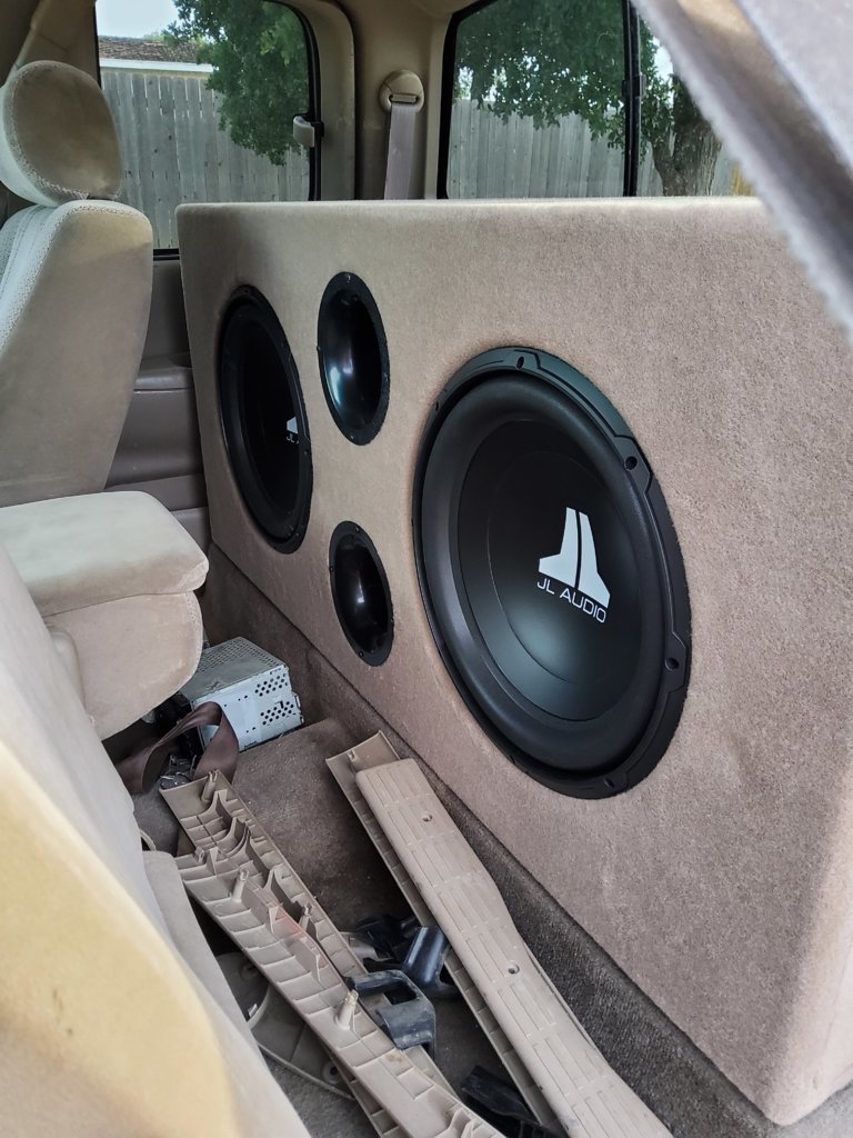

    Fuck that back seat.
    Also, 33 posts and nobody asked for pics? What's wrong with y'all? We need pics of the truck asap! We like pics. Like, a lot.

    Imma keep it stock
    I may or may not have done that back in 2006 :anonymous:
