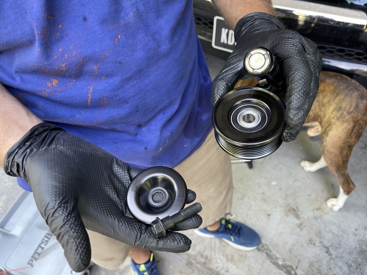

    Erik had noticed previously that the accessory belt should be replaced, which made me start paying more attention to the noises up front. There certainly was a bit of a "squeal" on a cold start, and there seemed to be a "pop bottle blowing down the gravel road" kind of noise when idling.
    When poking around the engine bay previously noticed that the bolt on the idler pulley was sticking out a bit, and the plate was missing.
    So, got a big 'ol list of stuff:
    Except I failed to order the hoses, clamps and thermostat from Rusty Wallace and had to buy local which meant rounding this off before Saturday cost me an extra $100.
    We started by draining the coolant, fan shroud, radiator, belt, idler pulley, power steering & tensioner pulley. I turned my back for a second and Erik was knuckle deep in half a can of Fluid Film already.
    Pulled the airbox so we could get better access to everything, plugged the intake manifold with some fancy blue paper Shop Towels, and pulled the old thermostat.
    The idler pulley looks had a fantastic looking bolt, don't know if I really needed to buy the new one. o_O
    We had to get some covers off the timing belt to get the alternator out, but we were able to get the new alternator in place, as well as the new tensioner.
    During all this we discovered a screw hanging out inside some hose keeping it plugged, and the nipple where it seems to belong, busted off. Gonna need to figure out what this...was...under the air intake, and add it to my "should be replaced" list.
    We broke for some Chick-fil-A, then got everything buttoned up. Put about a gallon and a half in it, and took it for a test drive. About a block or so further I realized that I needed to put my seat belt on, noticed the check engine light, and subsequently couldn't get any power out of the gas pedal.
    Coasted it to a stop off the main road and gave @FirstGenVol a call to come rescue me. He grabbed some tools, the OBDII scanner and headed my way.
    I popped the hood and started retracing our steps to make sure we had everything connected. I didn't see anything leaking, the temp hadn't skyrocketed...then it hit me just as Erik pulled up behind me. I didn't pull the blue shop towels out of the intake. I asked him if he had, he didn't recall doing it. I very clearly knew I had pulled two new squares and jammed them in there. So, we cracked everything open and there they were. Sitting right up against the butterfly, in perfect shape. No bits and pieces missing. The OBDII scanner showed the codes matched up.
    Did some more test driving with the heat cranked, and topped it off a bit. The squeal is gone, the random idle noises are gone. Not to mention it just feels better in my brain. Pulled the battery cable while Erik polished off 3 cans of Fluid Film while rolling around underneath the Tundra on his fancy roller.
    Put the battery cable back on and checked for codes, no codes. No lights. Was able to drive home without issue and the coolant is right at the hot "Full" line.
    Could've been a lot worse.... @FirstGenVol ;) but we got a good story out of the deal.
