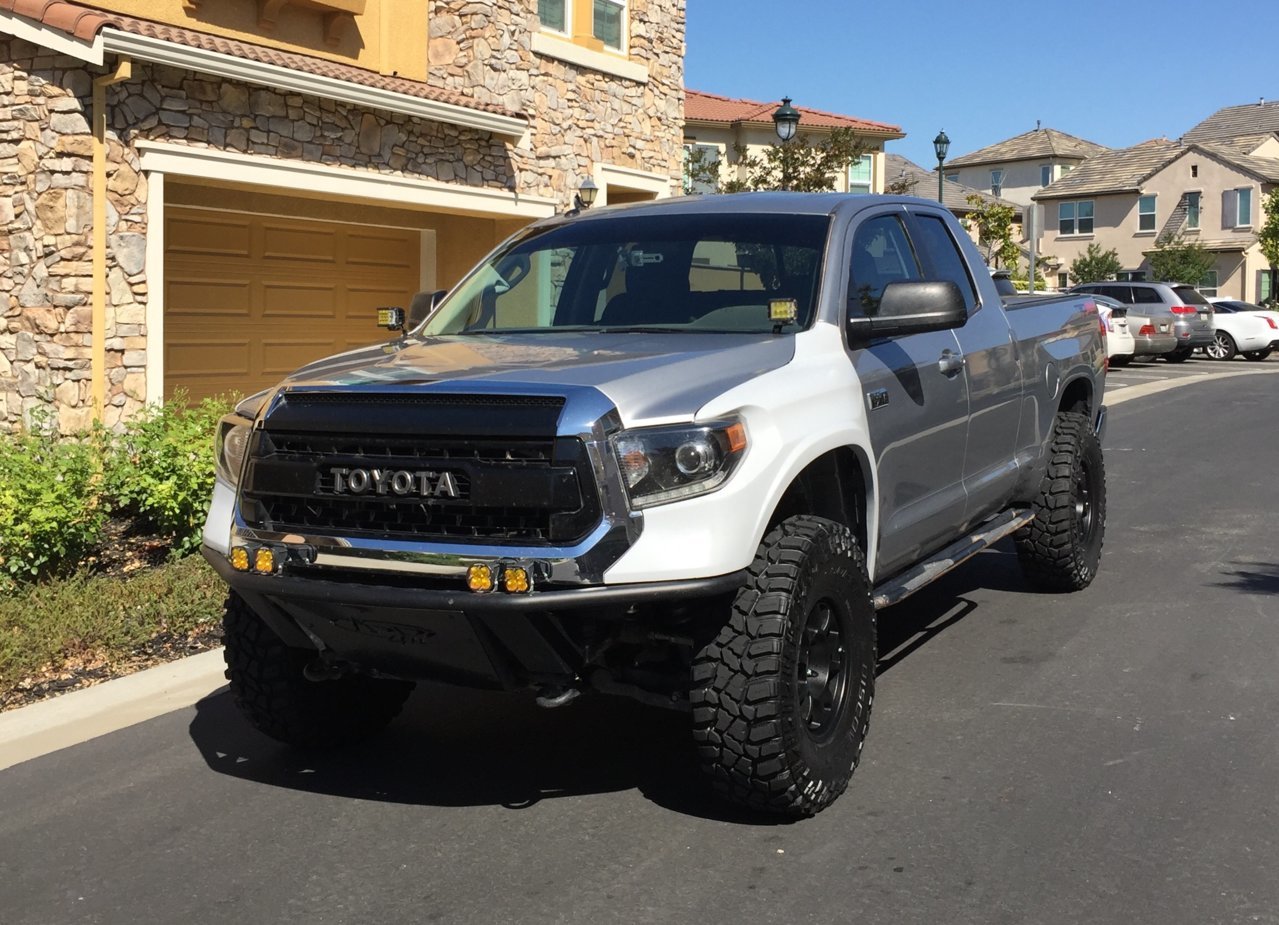

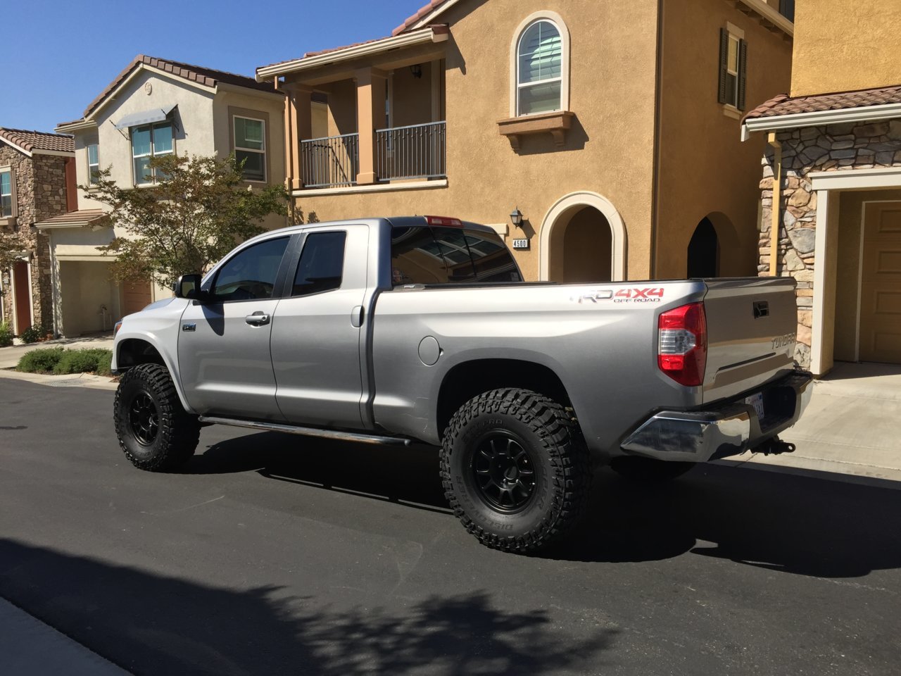

    Annual car wash and wax. :D Literally been over a year since I’ve washed the truck with soap. :eek: Tire dressing put on by the tire shop.
  14. Jul 28, 2019 at 11:26 AM
    #1694
    jc153
    jc153 Speed-ish Glamper
    Apr 20, 2017
    #7328
    609
    John
    San Diego
    2009 Tundra Ltd CM 4x4
    TC Front Long Travel, ADV Glass Fenders & Bedsides, TC Spindle Gussets & King LT Coilovers, RCV Axles, DuroBumps, CB Steering & Carrier Bearing Drop Kit, SDHQ ABS Sensor Shields, Rear 3.0 ADS Triple Bypasses w/MCM Fab Under Bed Shock Mount Relocation, SUA Deaver I96HD Springs & TC Shackles, MCM Fab Rear Hydro Bumpstop Kit, Solid Offroad Engine Mounts, 17" Method Standards, 37/12.5/17 Toyo RT's, Nitro 488 Gears w/Auburn LSD, Evil Off Road Bumpers, RCI Skid Plates, White Knuckle Sliders, Dirty Deeds Ind. BAMuffler 8" Catback, Baja Designs Lighting, SwitchPros Controller, Custom PS Cooler Relocation Kit, Custom Dual Battery Setup
    Looks good Joon! Washing your truck is underrated. Nothing wrong with keeping it clean brother. Although I should practice what I preach. Hahaha
