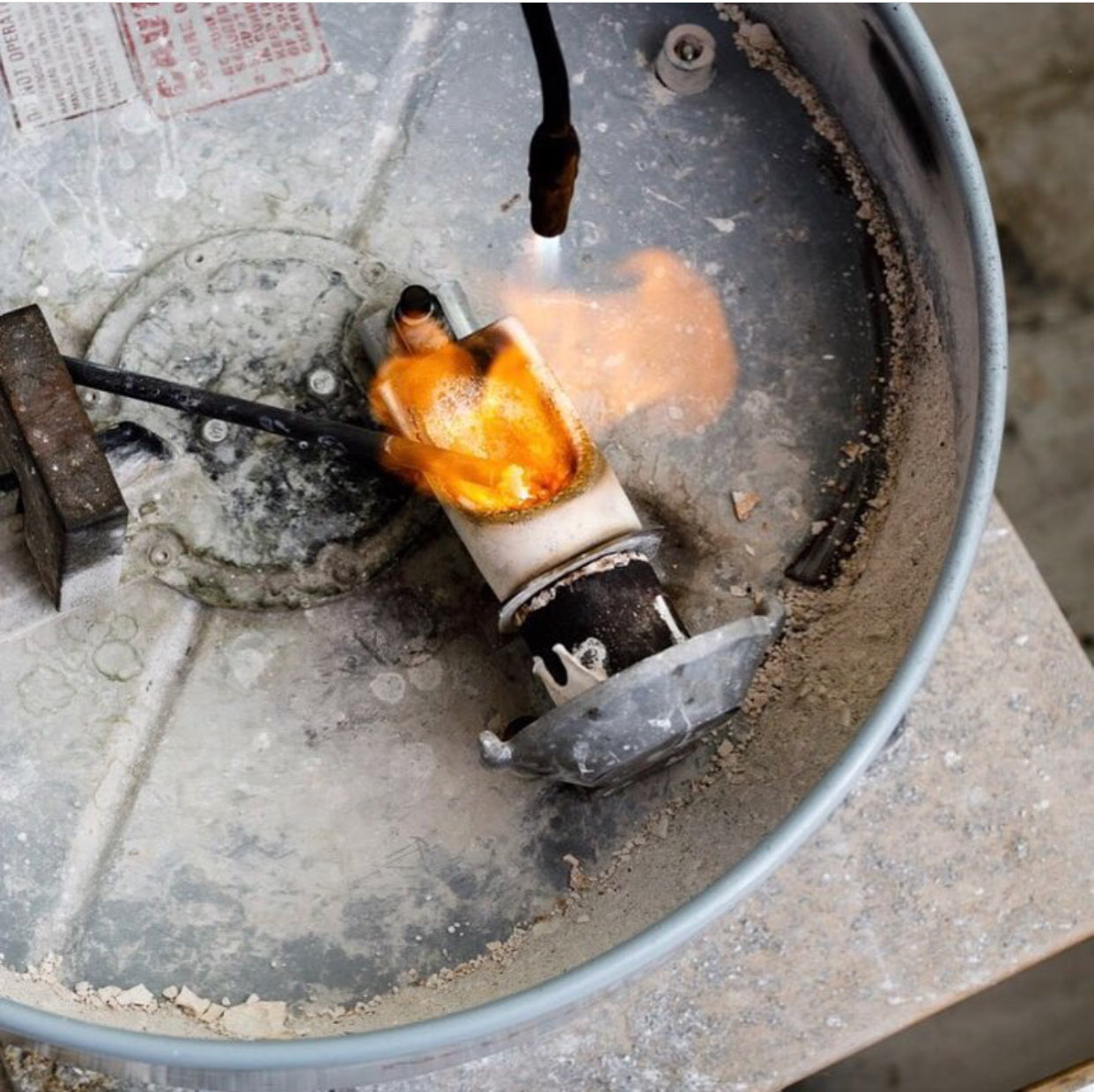

    Like this. This is my friend’s torch.
  2. Feb 25, 2019 at 2:56 AM
    #1382
    29,679
    That is definitely not @ARamirez73 .

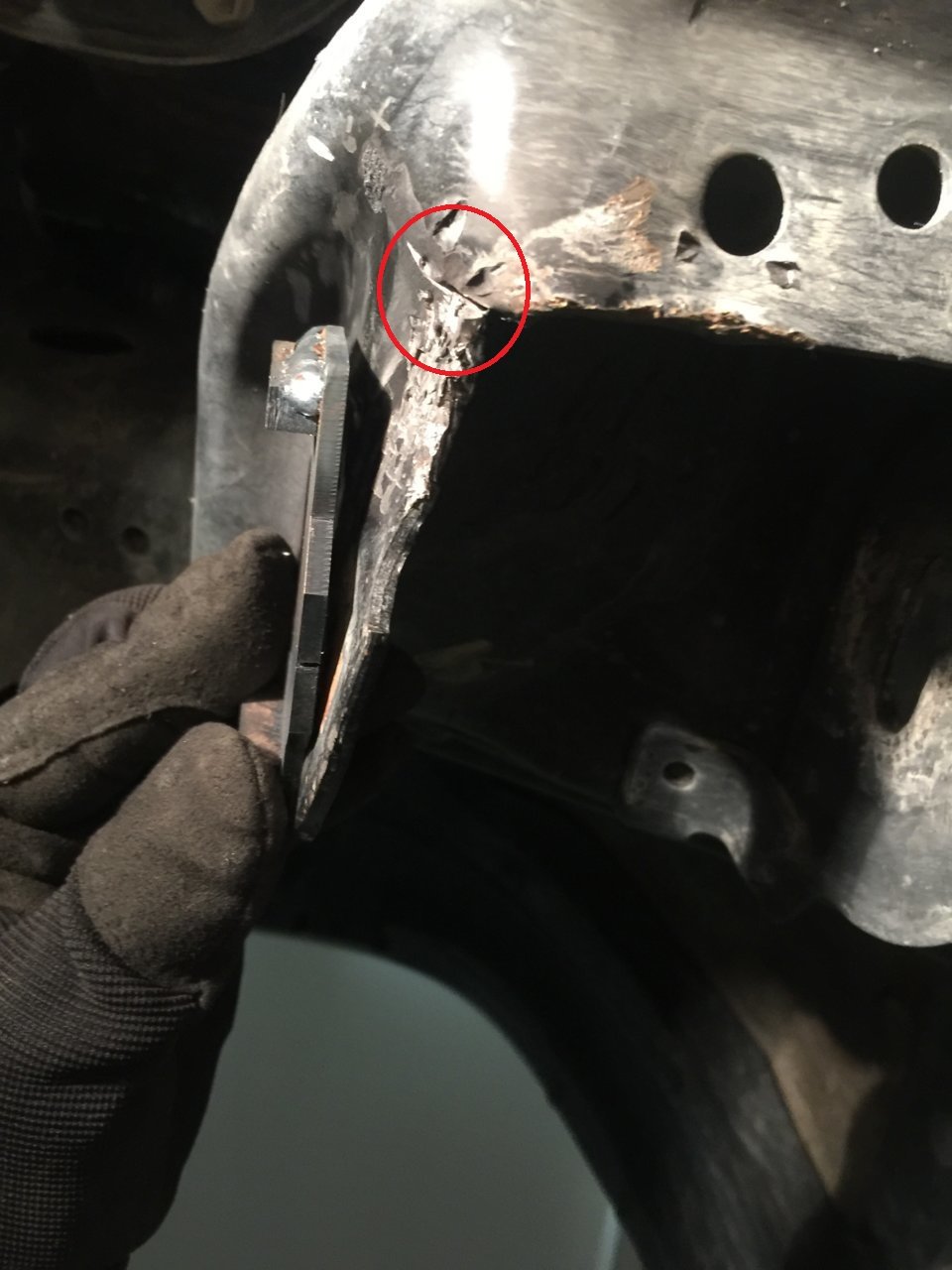

    Did you tighten the ring attached to the skid before or after you put it on?

    yup. Literally tried every combo of install order before finally just manhandling it

    Damn yall need to drive better - those are some beat up Cam Tabs. I only had one side bent a little on the drivers. Or maybe I need to drive harder. LOL

    Is the mount cracked also?

    It's our damn terrain up here in Norcal. We're constantly sitting on boulders. I got a lot of that damage on one trail. Niagara Rim. It was pretty rough and I didn't have anyone spotting me up front. It took us 3-4 hours to go the first 1/4 mile. It was ridiculous... I can't wait to go back there.

    No, it wasn't cracked, I cut that line there to try to pull it out. I welded it back together, I hope it holds.

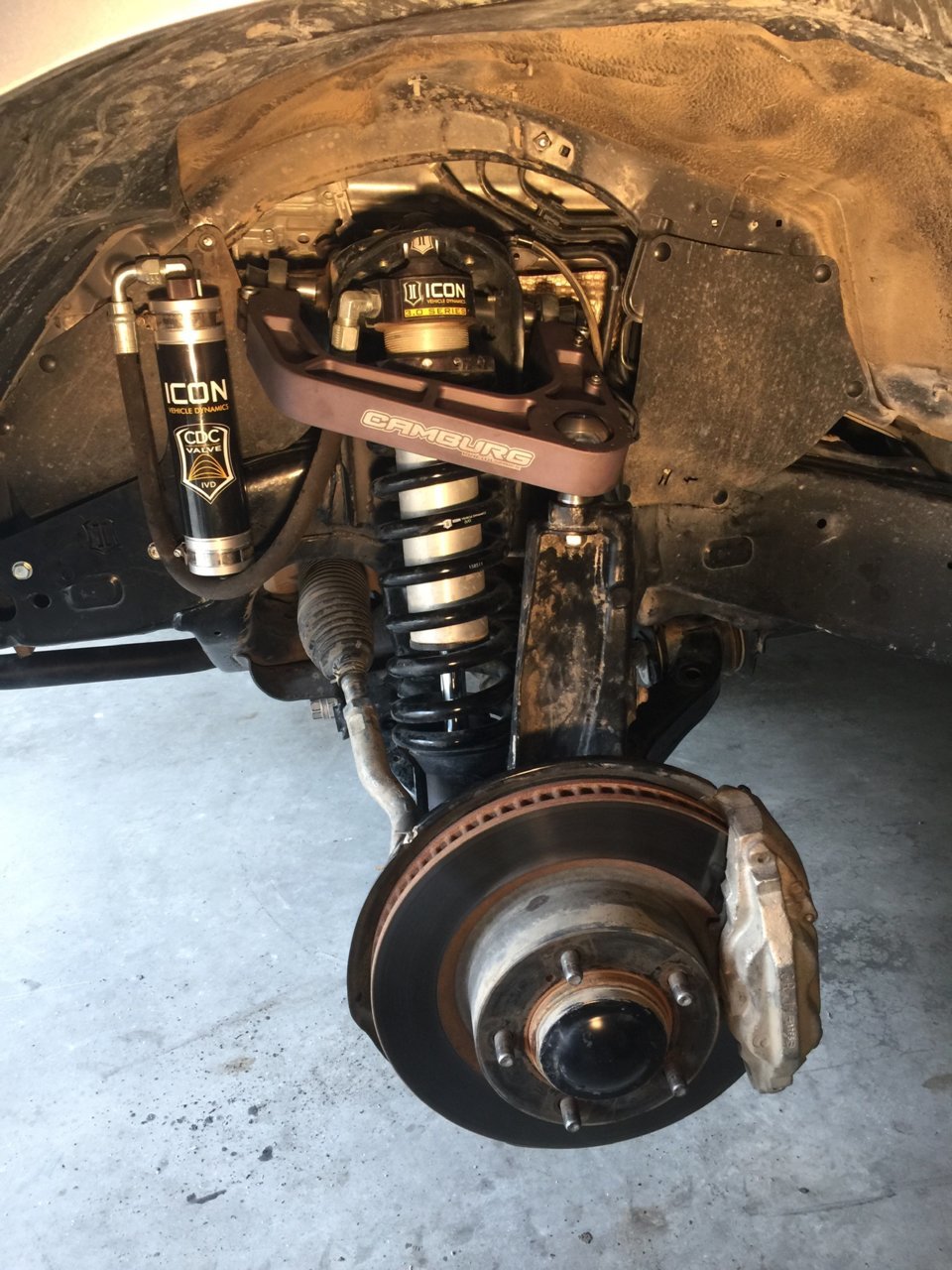

    Camburg Billet UCAs installed. Had to drill a couple new holes to relocate the resi mounts as the new arms are way beefier. Put it on the rack and caster was way too high and couldn’t get the toe in spec. So had to remove it again and take in the heims a bit and got a 2nd alignment. Finally got some decent caster... I’m in the 5’s now and can go even higher. Alignment also straightened my steering wheel which was pointing to 10 o’clock ever since hitting a big rock in Death Valley.

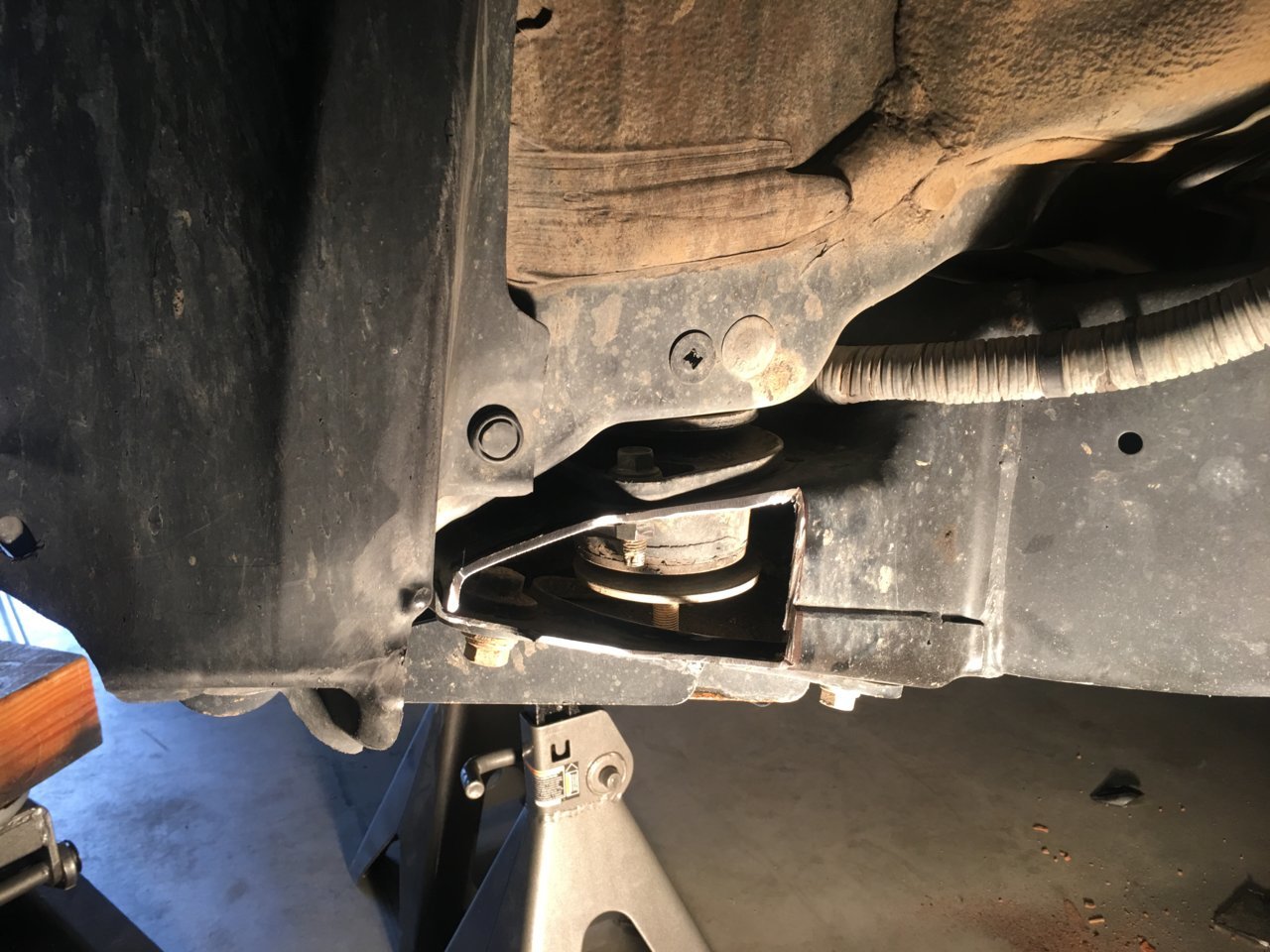

    But now I’m rubbing the cab mount in reverse so it’s finally time to do a CMC. The welder is still set up in the garage so I’ll try to tackle that next weekend before our trip in a couple of weeks.

    why the camburgs over the icons? just curious?

    Or... why Camburgs over Total Chaos, which have heims...?

    well the icons actually have a sealed delta joint. but the perk of the icons is you can actually make all adjustments on the truck vs. removing the uca bolt every time. Hes got icon suspension, just curious as to why camburg over the icon?

    It's a shame because I really like the delta joints. Just wasn't pulling enough camber nor caster with the Icons. Total Chaos doesn't have enough room for the resi hose on the 3.0's without swapping the driver and passenger side coilovers. And even then, the hose makes contact with the springs. Icon billets would've been my top choice, but my buddy @TRD15559 sold these to me at a price I couldn't refuse. Pulling the arms to adjust is a pain in the ass but luckily it only has to be done once. I'm actually very happy with these, I can already feel less jolting on small bumps.

    yea sorry I didn't specify the billet icons lol.. that's what I meant. and yea you cant beat a good deal. especially as hands on as you are,thats a pretty easy in and out process for you. good deal I was just curious but that makes perfect sense. and yea ive heard a lot about the caster on the tubulars... glad I didn't go that route. looks nice tho man! good find.

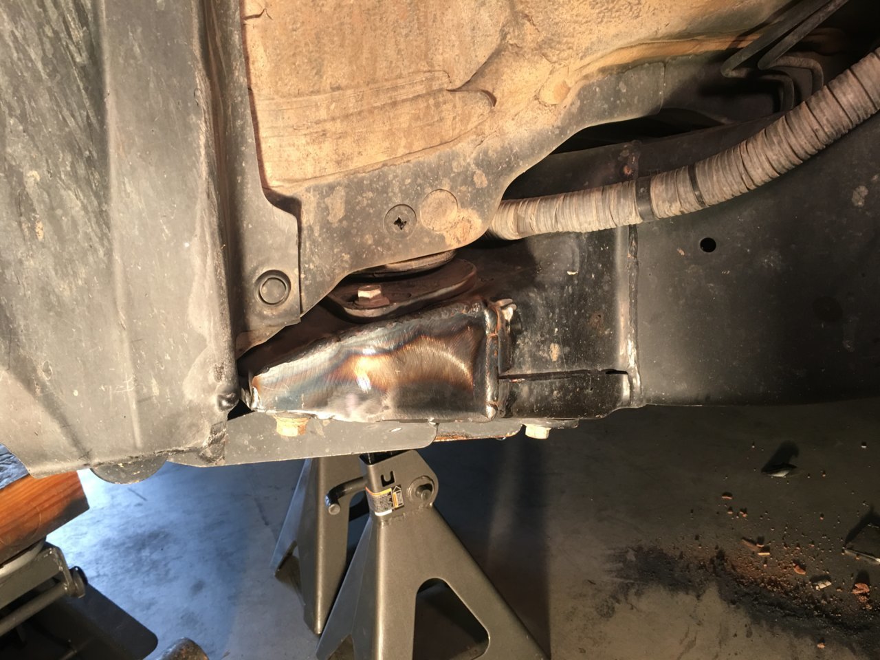

  21. Mar 9, 2019 at 5:29 PM
    #1401
    joonbug
    joonbug [OP] °°°°°°°°°°
    Oct 13, 2015
    #1948
    16,870
    Joon
    NorCal - Dublin
    2020 LT DC
    I contemplated leaving it like that until after the trip. Then I downed two energy drinks. :goingcrazy:
    Got one side done.

  23. Mar 9, 2019 at 5:33 PM
    #1403
    TheBeast
    TheBeast The Beach
    Apr 27, 2016
    #3246
    12,576
    SoCal
    2012
    damn all that time and adventures and you didn't have the CMC done ? :eek2::D
  24. Mar 9, 2019 at 6:17 PM
    #1404
    joonbug
    Oct 13, 2015
    #1948
    16,870
    Joon
    NorCal - Dublin
    2020 LT DC
    It never rubbed before. :notsure: Wasn’t even close. The UCAs and the last alignment really moved my wheel back a lot. It’s still really close with the CMC. I’m going to redo my alignment before I chop the other side. If I can’t move the wheel forward, I think I need more aggressive plates.

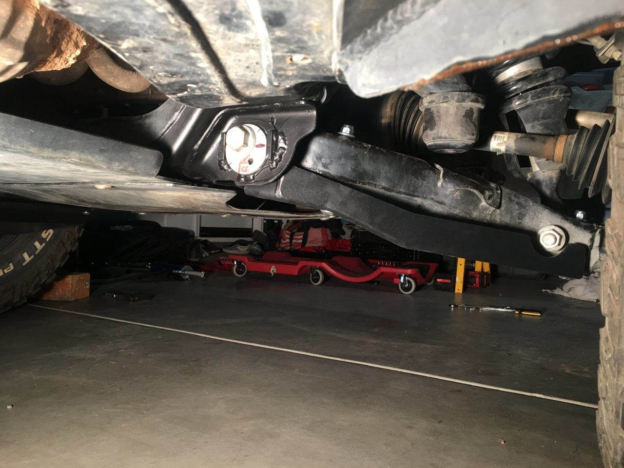

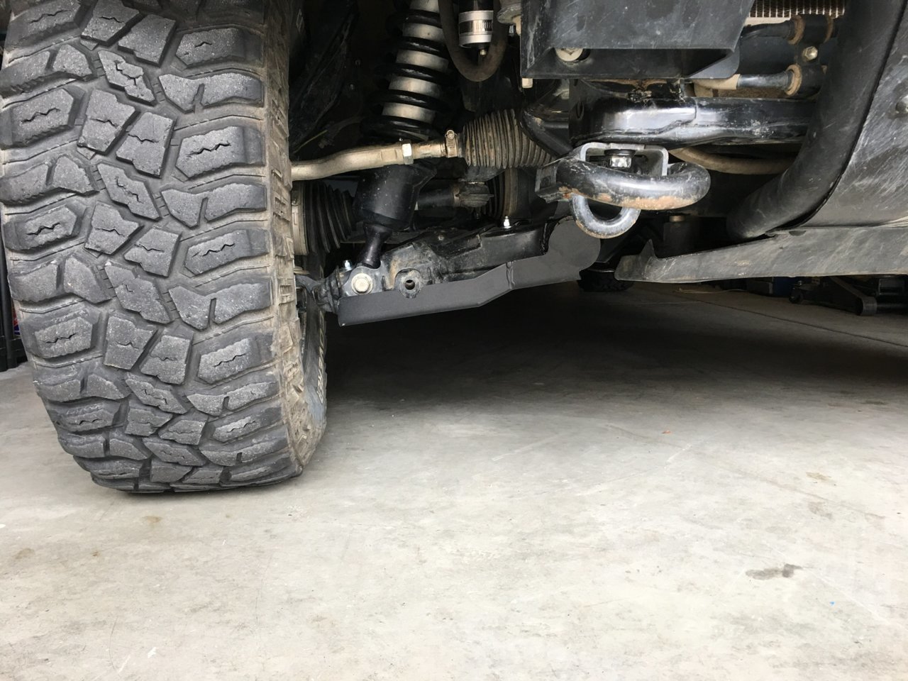

    3-19

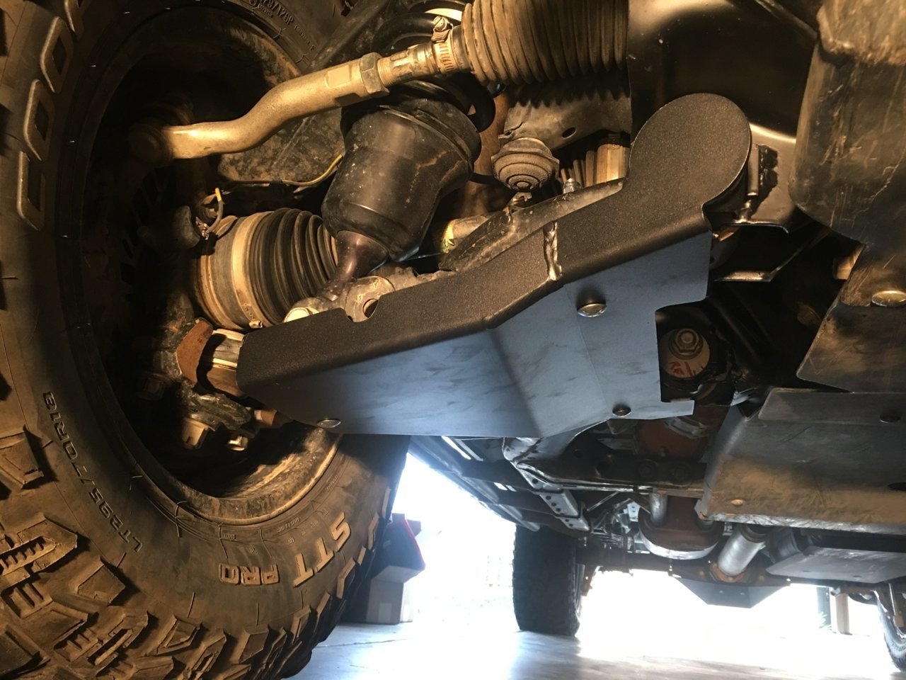

    Installed @Victory4x4 LCA skids. Really like these and they literally took 10 minutes to install. Came powdercoated too. I didn’t really get these to protect the LCAs, I got them to protect the cam tab mounts.
    The front cam tabs are completely shielded.
    And on the rear, the skid is just a bit lower than the mounts that I should just slide off rocks and avoid touching the mounts. These are perfect.

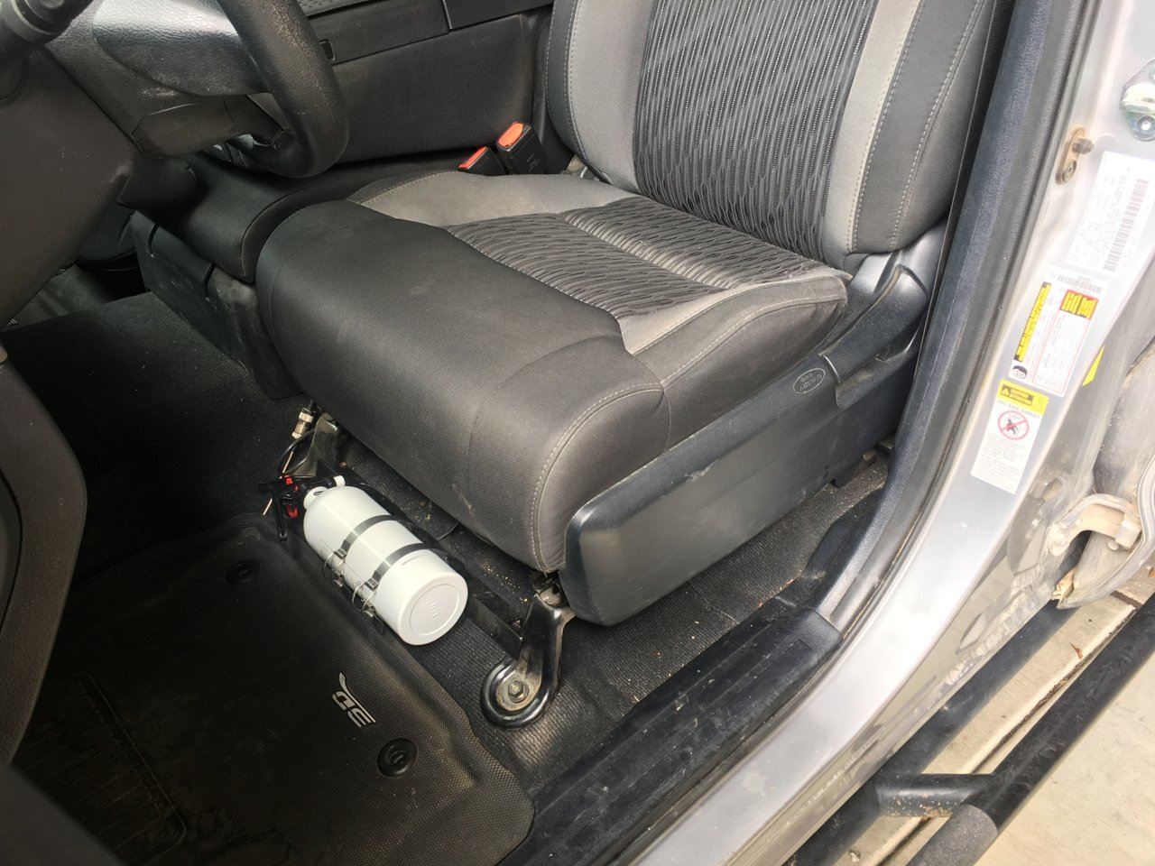

    @Vizsla Fire Extinguisher Mount
    I really kicked myself for missing the chance to buy this when I had the chance. Well, @dcsleeper408 gave me his. Very well made and now that I know David, it’s pretty cool having something he created in my truck.
