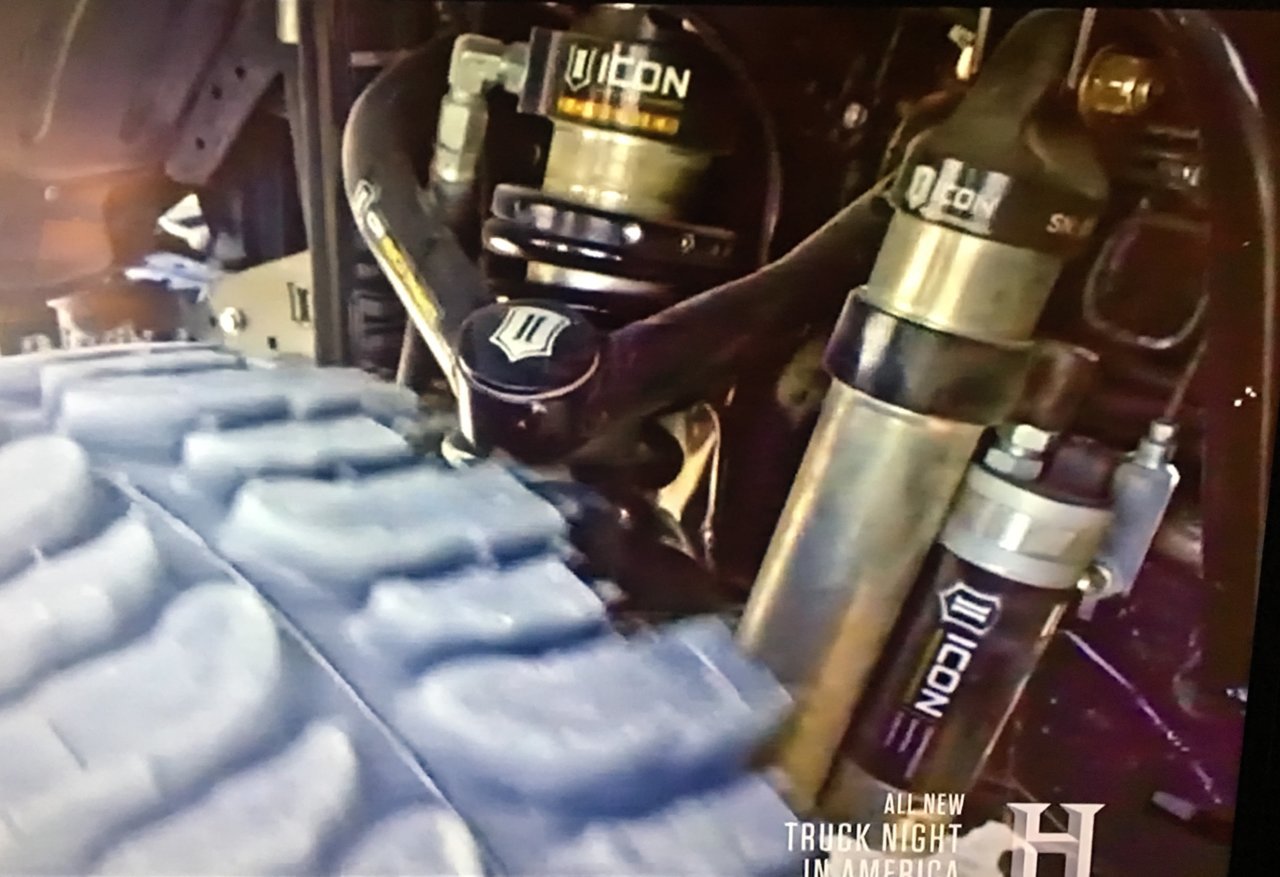

    Closing your eyes doesn’t help with callouses. Lol. Kevin, did you watch Truck Night in America? Kyle Busch had Icons with secondaries.

    I just watched it this morning! That was bad ass. He should have listened to his coach about water through. :rolleyes:
    I’d be interested in seeing how the truck is after that huge huck. We’ve only been maybe half that high in ours.

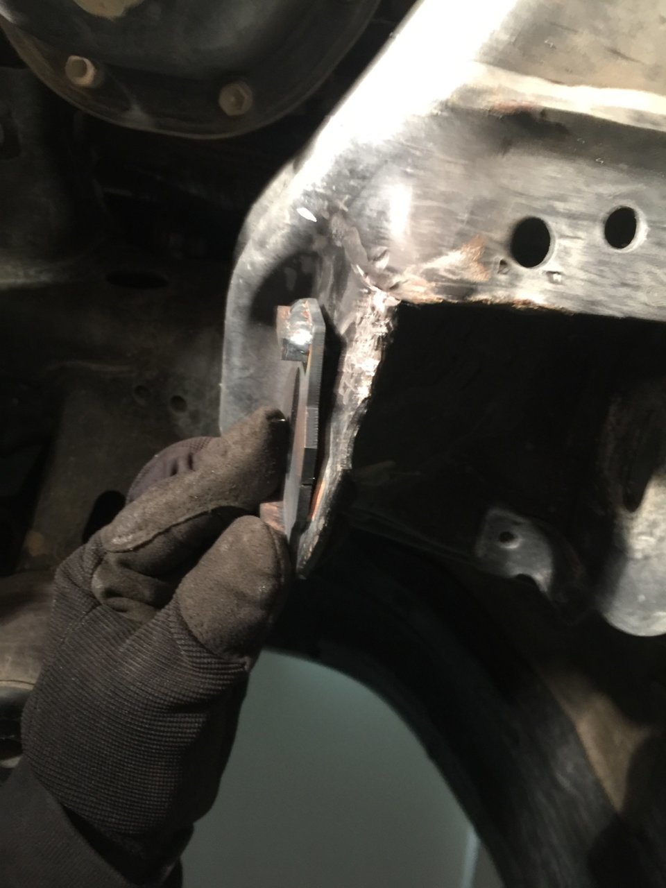

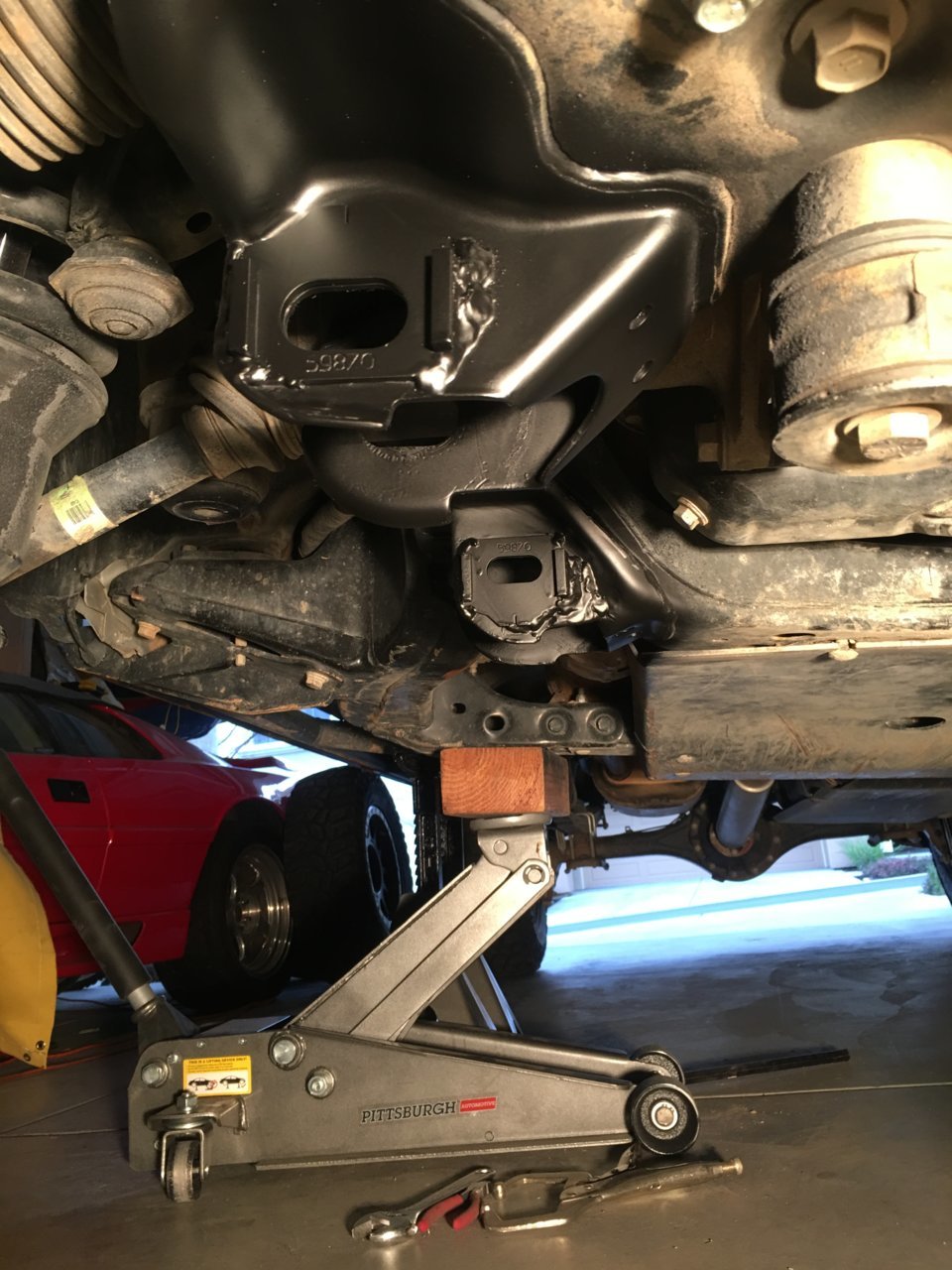

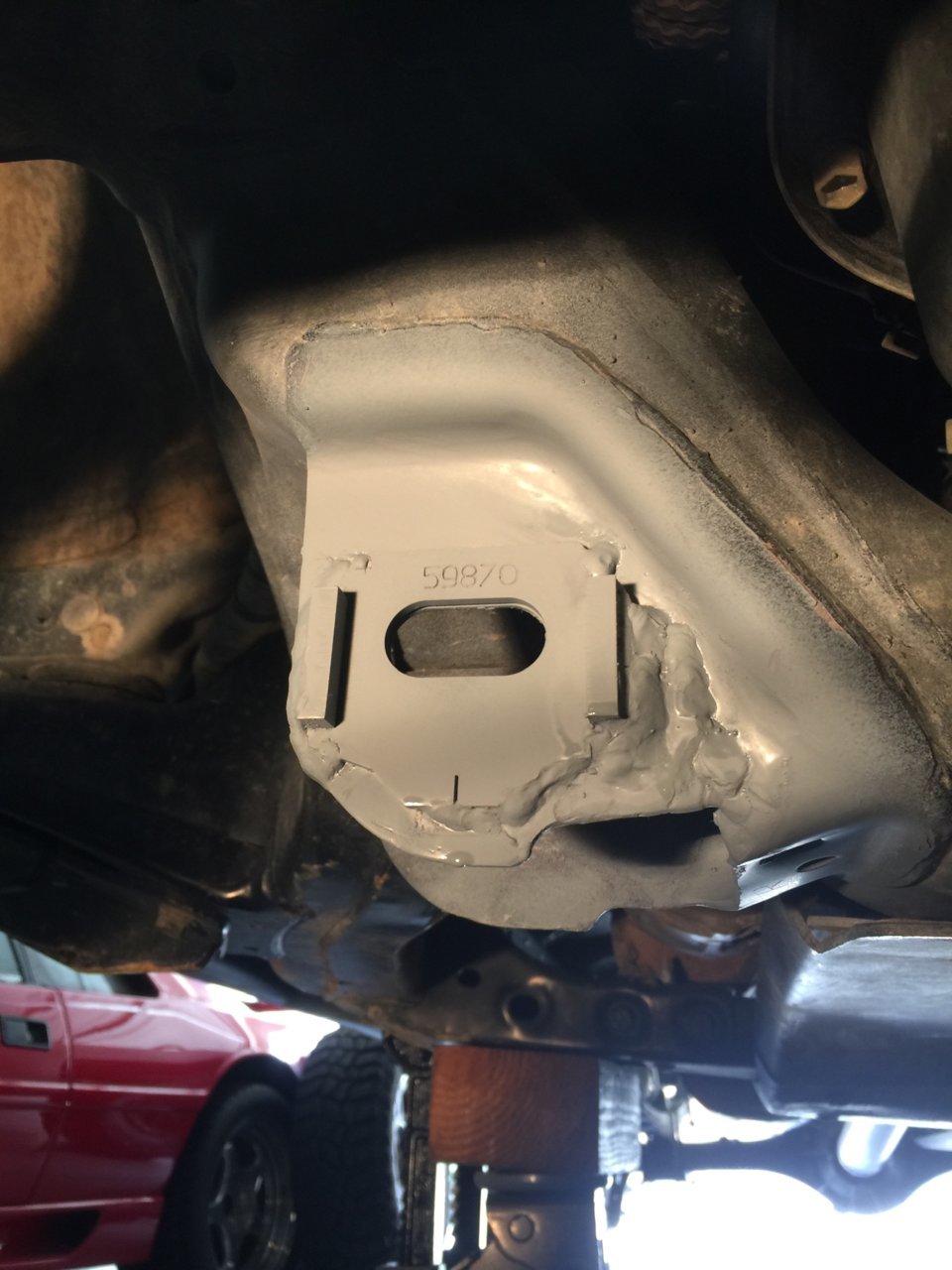

    Finished up the passenger side cam tabs today. Last night I left off with one of the mounts being bent really bad. It needed to be bent back this much.
    Tried a BFH... pffftt... no chance in hell. I think it needs some serious machinery to bend it back, which I don’t have. So I decided my only option was to add more metal under the tab. So I just welded on a little piece there.

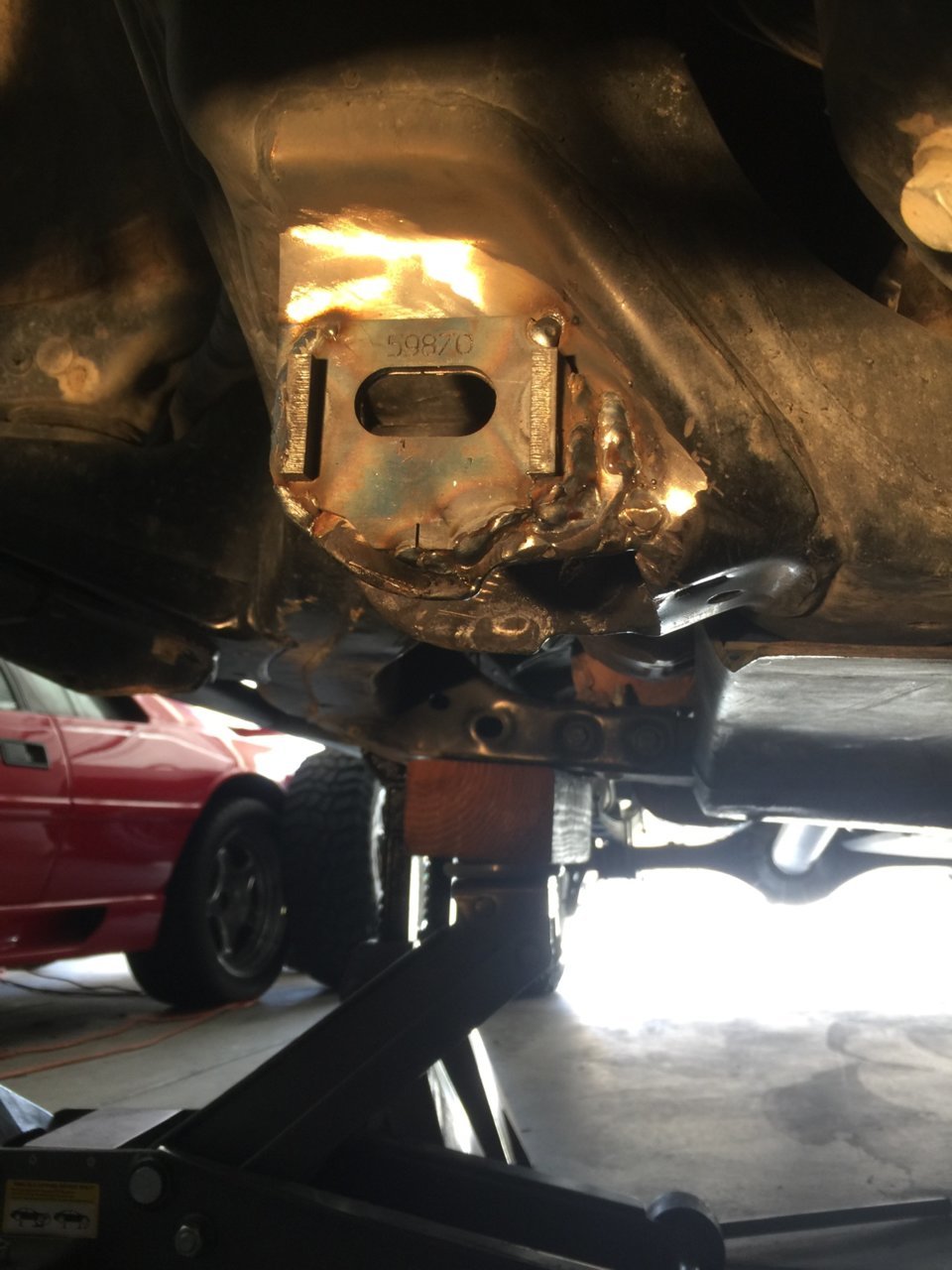

    Sanded it down until the tab sat flush and welded the tab on.
    It’s on there pretty good. It’s so thick now I think it’s stronger than the original mount.
    Then got the other 3 welded on and painted.
    Put the LCA back on and I’m done. Never want to do that again unless I have a lift.

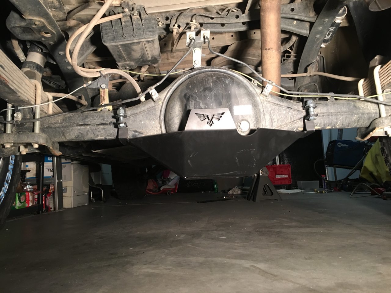

    Victory Rear Diff Skid
    Slapped this on while waiting for paint to dry. Fits good and looks solid. Can’t wait to go test it out.

    Any pics of the third member coverage?
    Oh, and @ARamirez73 for general purpose..

    NorCal - Dublin
    2020 LT DC
    Sorry. Only pic I took. I’ll try to take one next weekend. I don’t even want to look at my truck right now. Lol

    A little rosebud action, and we could have bent the mount back. I'm only 18 hours away....hop, skip, and a long vacation away..:D

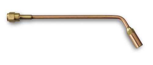

    What’s a rosebud?
  17. Feb 24, 2019 at 8:18 PM
    #1367
    ColoradoTJ
    Feb 24, 2016
    #2766
    41,090
    It's a tip for oxy/acetylene torches. Heats the metal up nicely.....

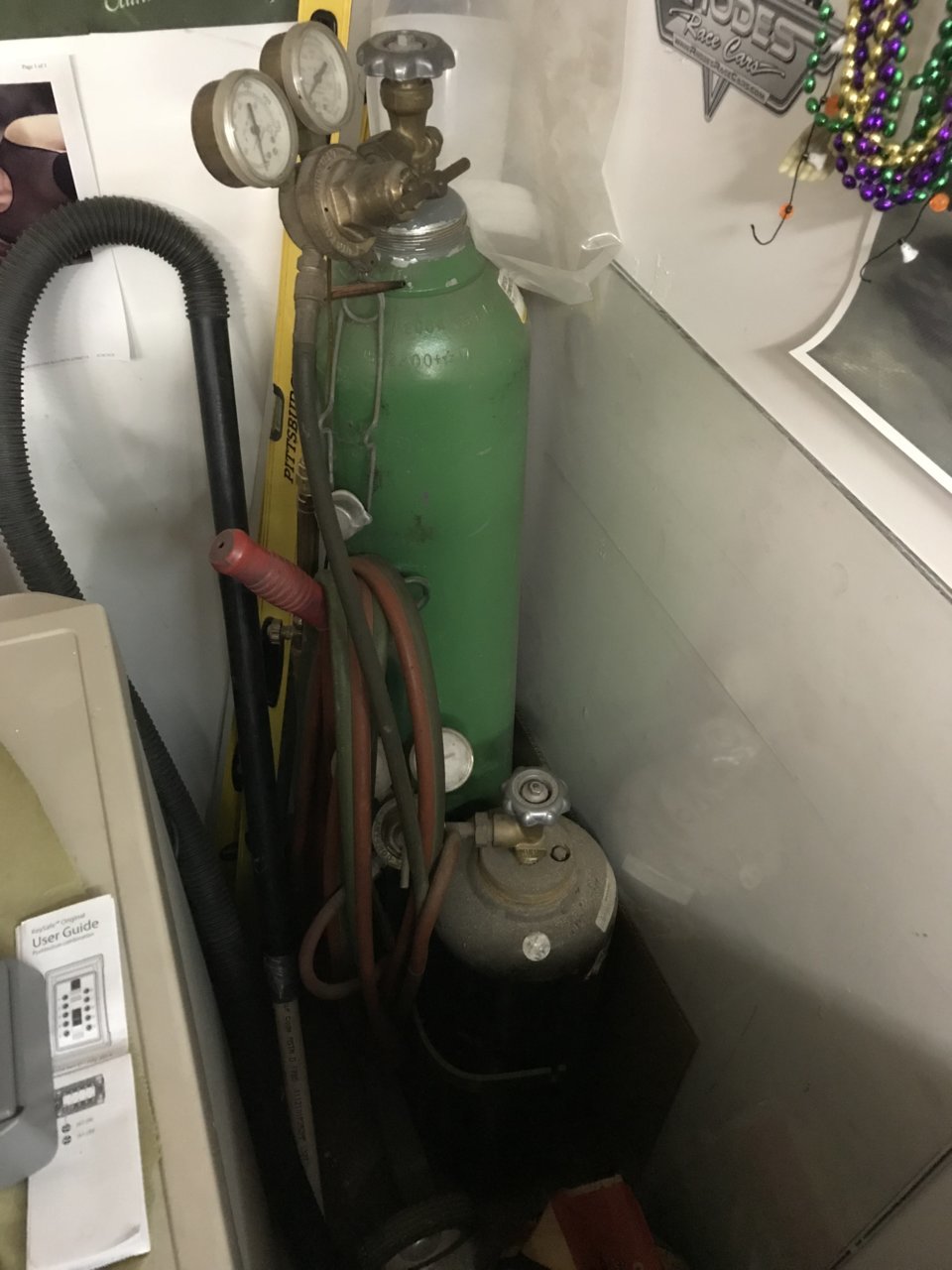

    After reading The latest thread, Joon you need a oxy/acetylene torch set up in your garage for steel re structuring. Great job on the repair you had to do.
    Now I know why you were asking for lower control arm bushing guards from Victory
    I have the torch set up to borrow next time.... If needed...:popcorn:

    Jewelers....your being funny right...
    My set up is for heating 1/4 - 1/2 inch thick steel ( aka rosebud tip) and smaller welding tips for mild steel rod welding.
    (old school)
    A nice set up will come with a few tips pressure gauges, lines, possible a cart for the tanks. Oh and tip cleaner device.

    Man urs looks like it fits great. I had bend the piss out of those axle brackets to get mine on.
