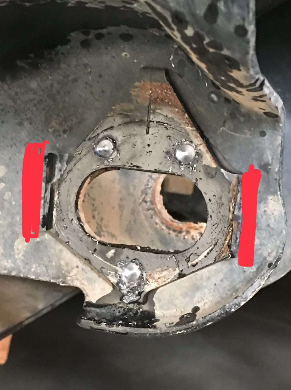

    While under the truck I snapped a pic of my sliders. I think they may need to be touched up a little bit.

    Those tabs are really thin. Mine didn't break, they just bent and flattened.

    gotcha. so basically your saying to almost add another gusset on top of it?

    The TC parts look to be adding more material in addition to the bars on the side. Do you think that is a big deal or is the majority of the benefit the bars?

    Yeah, I would just get a 1/4" square bar and weld it right behind the stock tabs like in the pic I posted earlier.

    Are you talking about the weld behind the bars? I'm sure they'll strengthen them some, but it's probably more to weld them in place.

    I would just weld 'em like @n2deep did if I had it to do over. When I welded the new tabs in I welded around the entire gusset, the thought being that I'm trying to reinforce the entire mounting tab and not just the alignment tab.:notsure:

    Comparing your pictures side by side, in addition to the bars, it looks like the TC parts are bigger.

    Yes, they're thicker. In the video I watched they welded all the way around.

    They're definitely beefier in every way. And they'll definitely be stronger than adding support to the factory tabs. But I just think welding a piece behind the stock tabs will be good enough and will take 5% of the effort. If that fails, then you can always do the TC tabs.

    100% agree.

    LCA's still gotta be removed to do the bead behind the oem tabs.
    other than that the TC ones are beefy!
