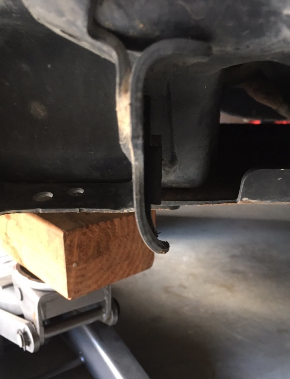

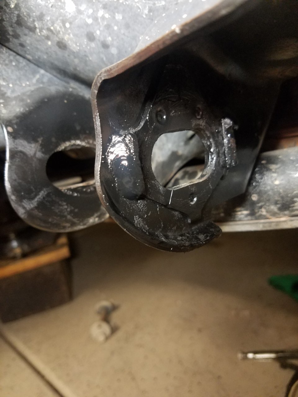

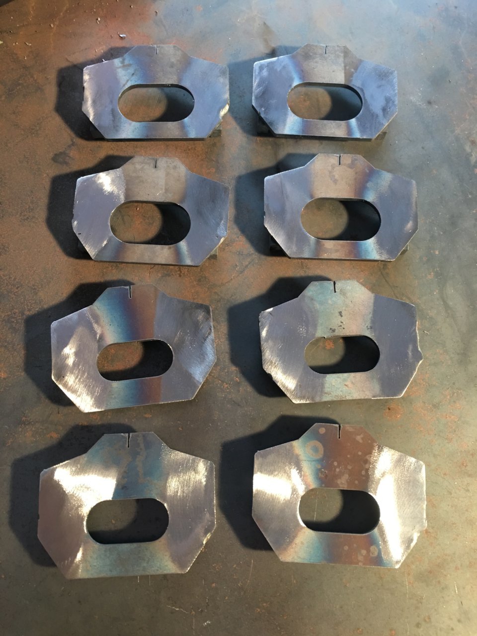

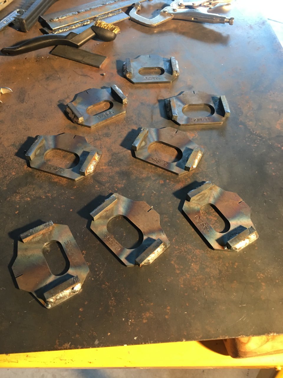

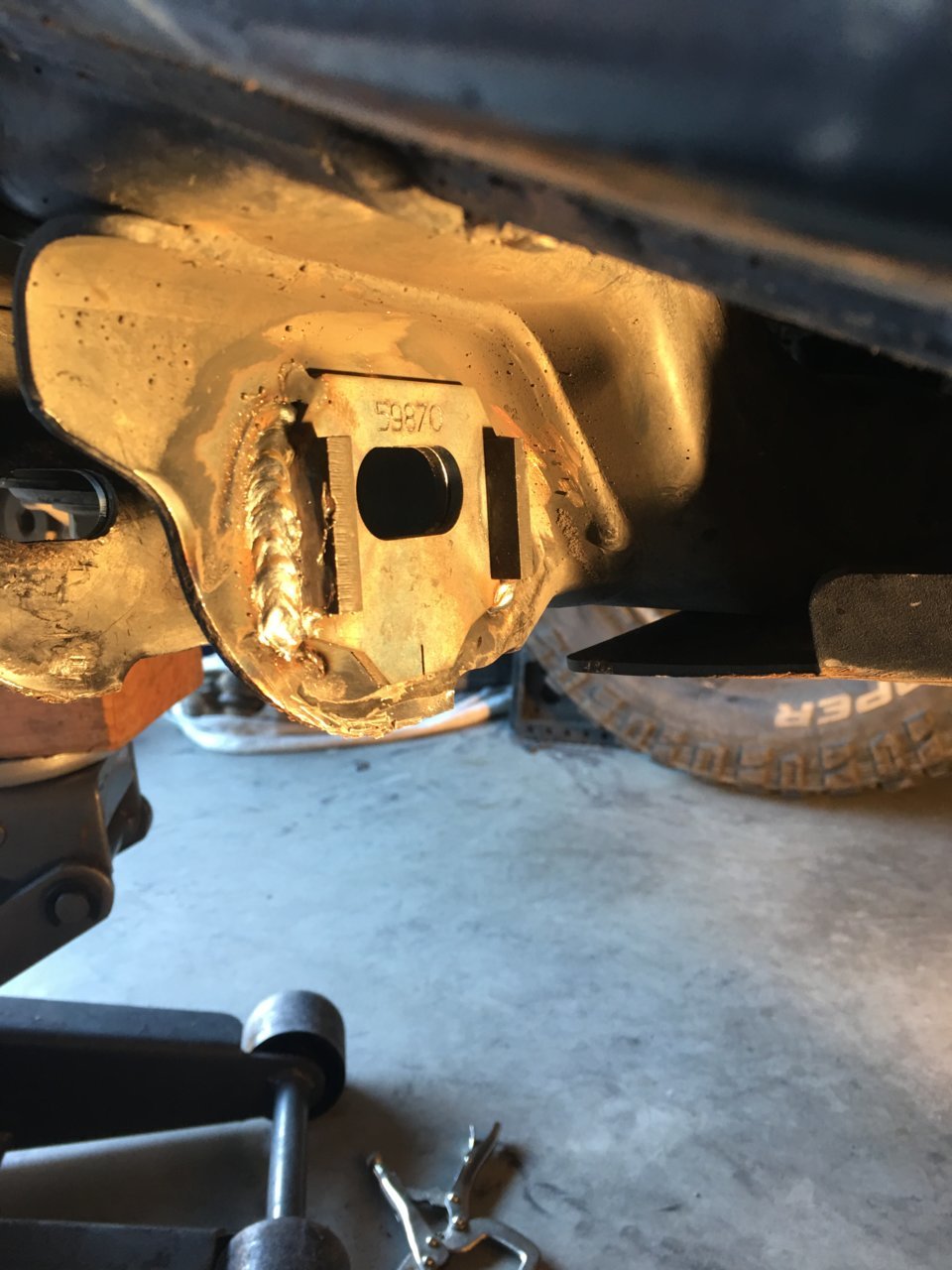

    2-19

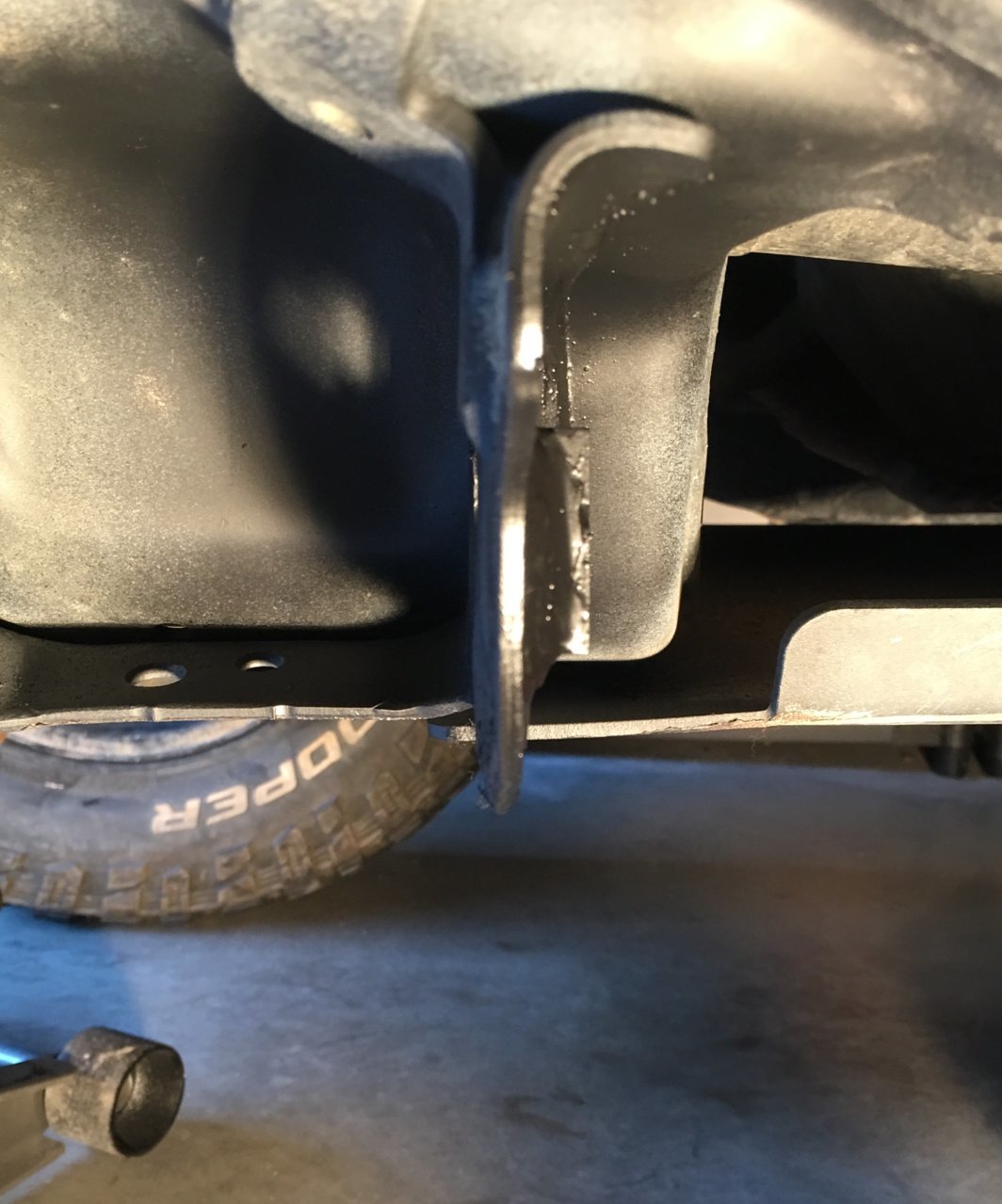

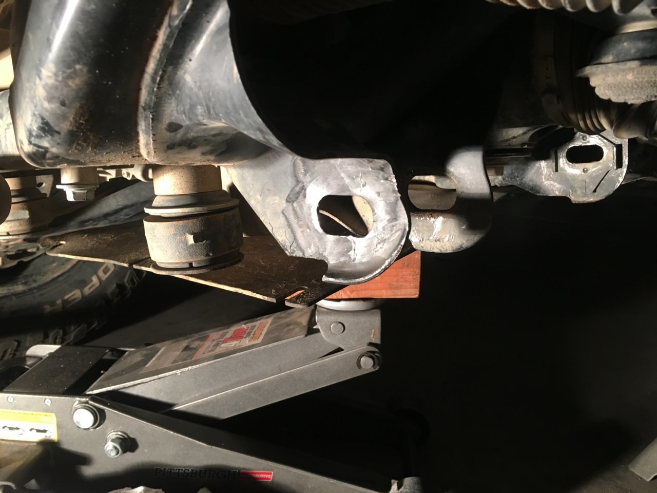

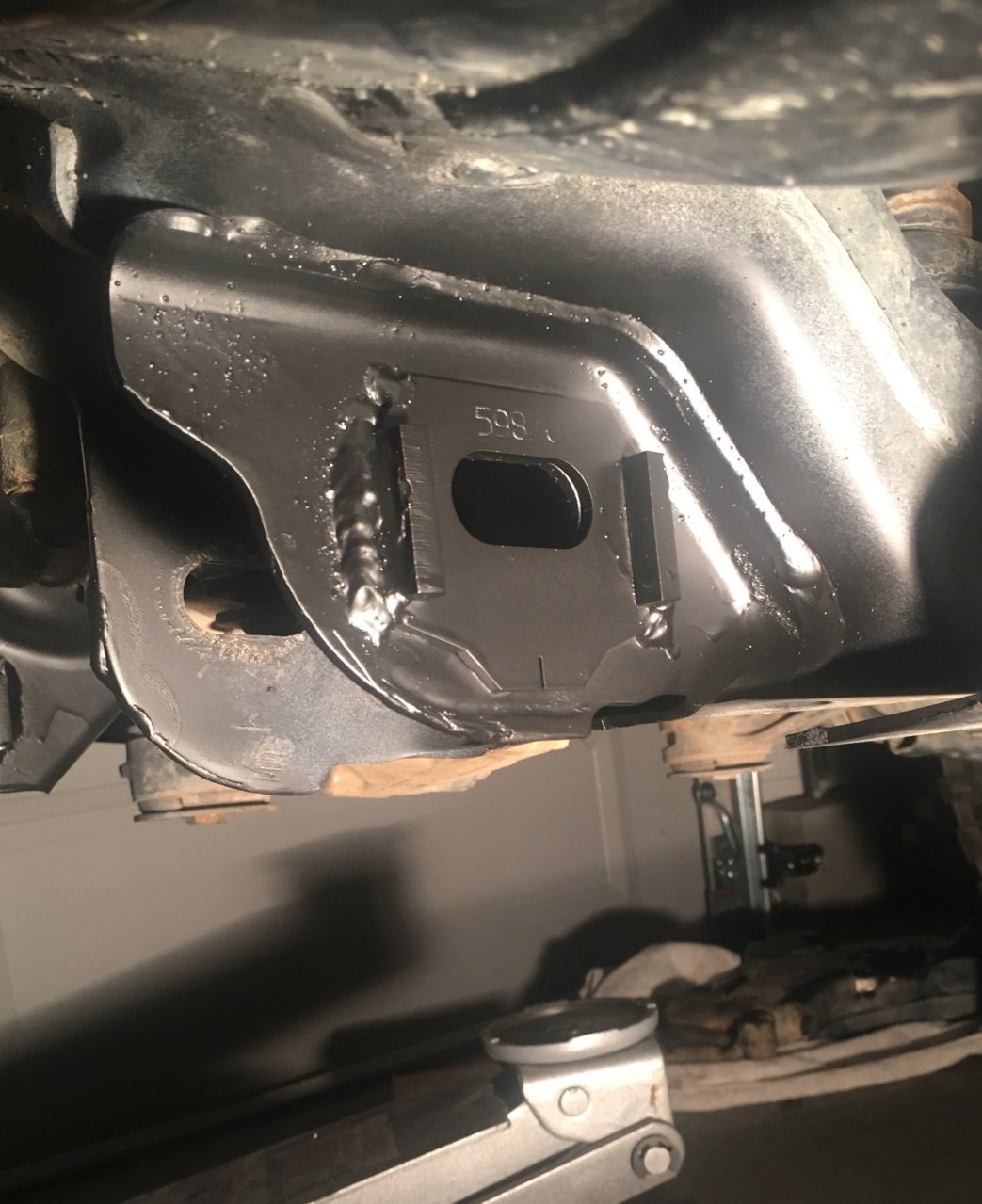

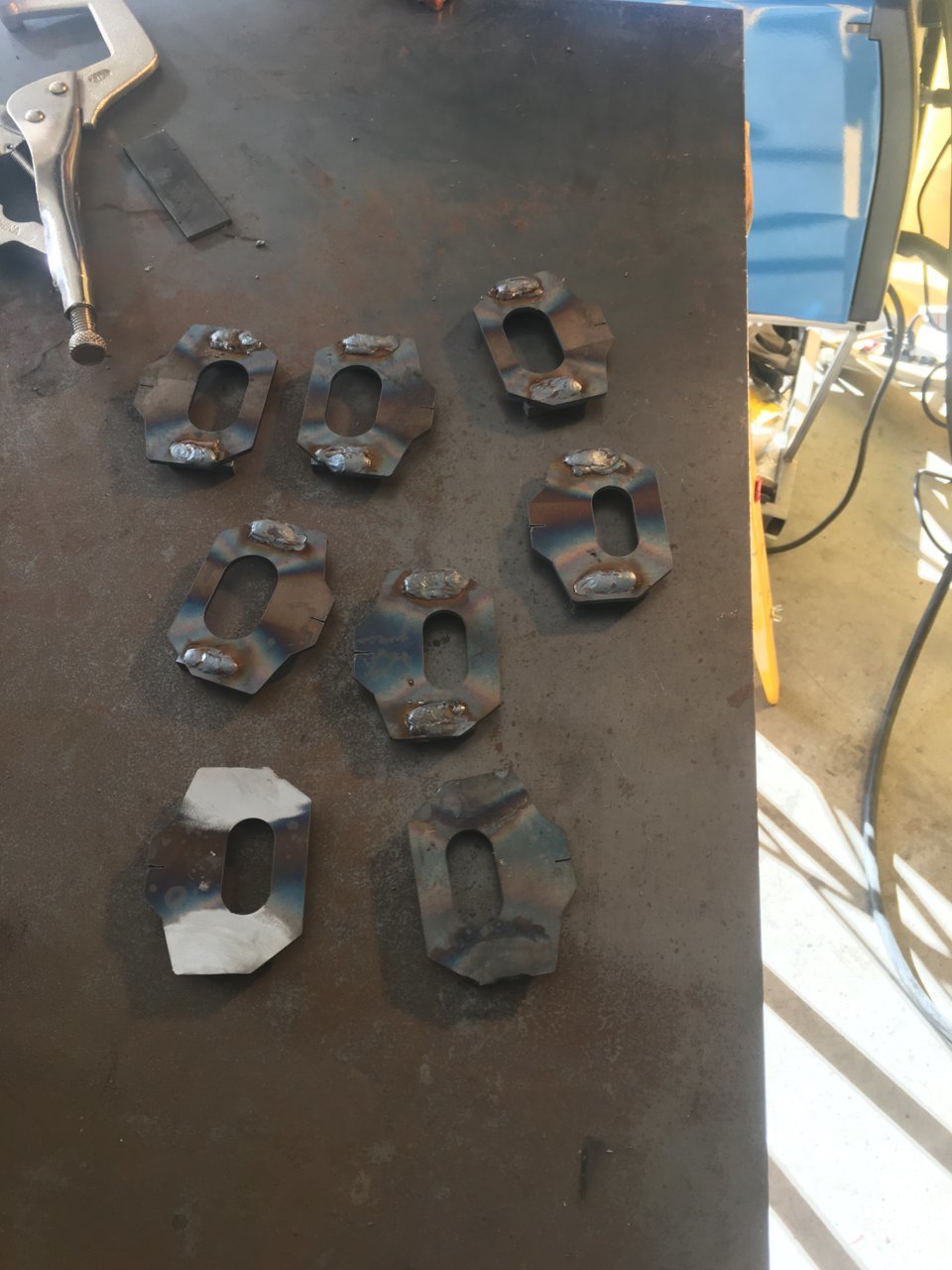

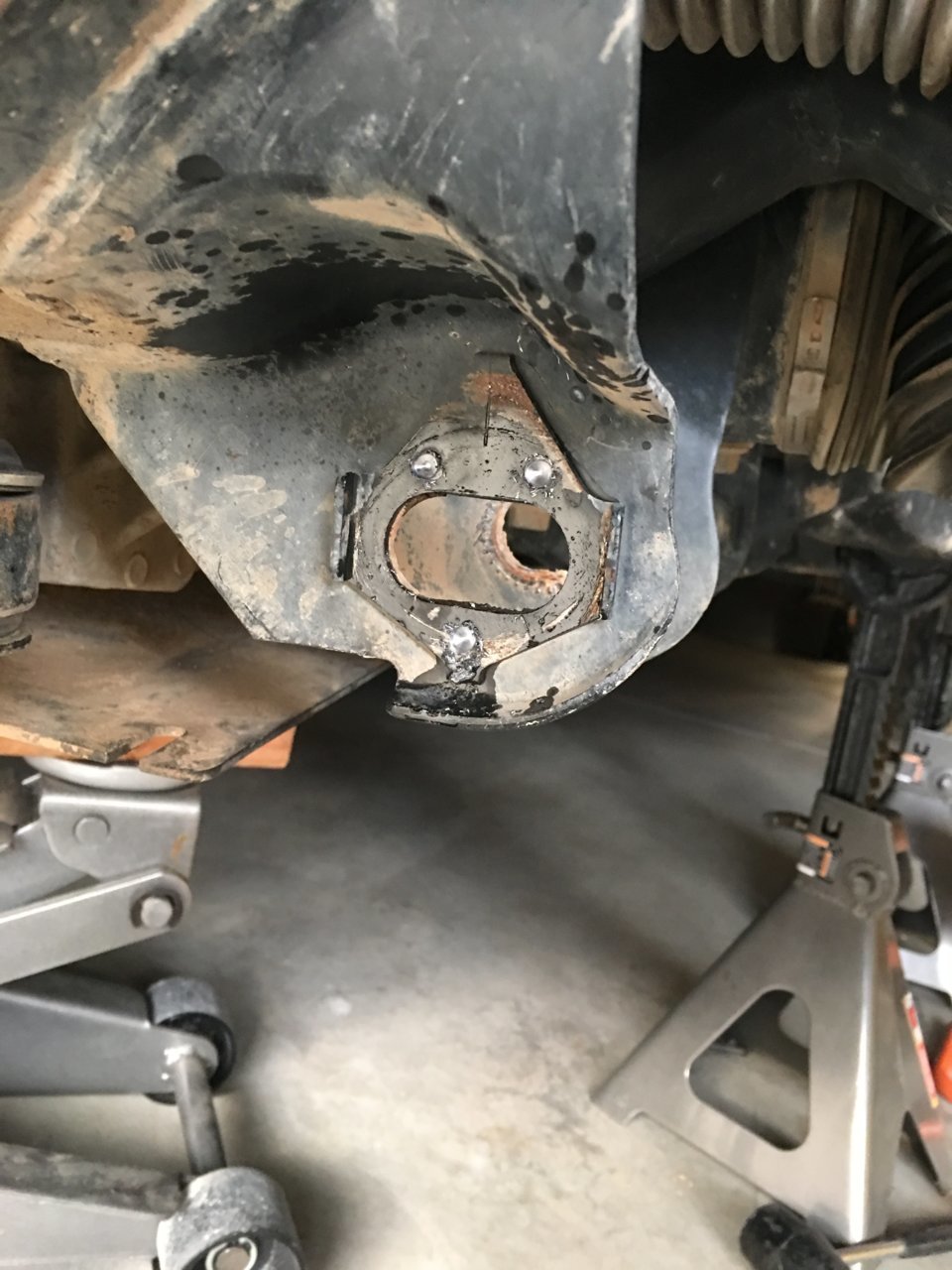

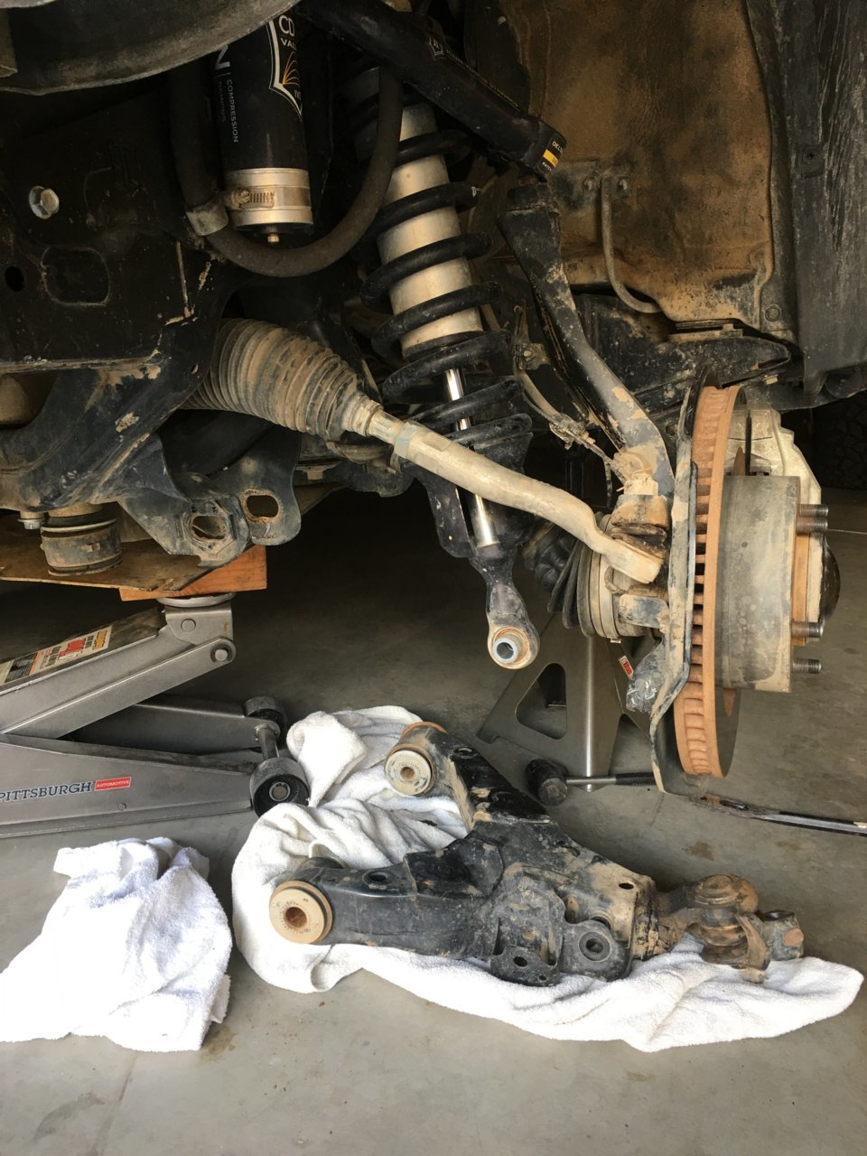

    Total Chaos Cam Tab Gussets
    Last trip to Death Valley I flattened a couple cam tabs and bent the LCA mounts. If you want to go fast, these cam tab gussets are a requirement. Been putting this off for a few weeks so I finally got out the welder and did it this weekend.
    Anyone thinking about doing this yourself, here’s what you’re in for.
    First, you have to weld the tabs together. Start by welding the backside of the bars to the plate. Wasn’t expecting this, thought they would’ve come already put together.
    Welds don’t need to be pretty since you’re going to sand them flat. Good thing because I haven’t welded in over 10 years and I was a little rusty.
    Then you have to weld the sides of the bars in front. My welding was slowly coming back to me but still not the prettiest.
    Then get the LCA off and remove the skid plates. All it takes is removing the 2 bolts on the LBJ cradle, the 2 alignment bolts, and the lower shock mount. Be sure to mark your cams. Mark a line to get it back to where it was when you’re done, and label fronts and rears.
    Now comes the sucky part. Removing the old tabs. This royally sucked.
    I drilled out the spot welds and tried prying them off with chisels and crowbars as it said to on the instructions. After about an hour I gave up on that and just started grinding them off. I used a 36 grit flap wheel on my 4.5” grinder and grinded them really thin. Once they were thin enough, I just bent them up and cut them off. Then sanded the spot welds off. This seemed to work a lot better, as I was bending the mounts trying to pry them off. Took about 20 minutes each once I got it down.
    Next I had to address the bent mounts. That bend at the bottom doesn’t belong there. I’m hoping my new LCA skids will prevent this in the future.
    Just used a vise grip plier and had to pull with all my weight for about 15 minutes until I got it straight. Hammering it wouldn’t even make a dent.
    After getting off all 4 stock tabs and straightening the mounts, time to weld on the new tabs. Don’t forget to disconnect the battery before welding on your truck.
    I just lined up the opening on the new tabs and the mounts and tacked them in place. The holes are exactly the same size so it’s easy to line up. Once I got them tacked, I put the bolts back in to make sure the cams fit and can rotate in the tabs.
    Next, finish welding them onto the truck. Would’ve been pretty easy on a lift, but on the ground this was pretty difficult. There’s always something in the way. The jack stands, the axle, the coilover and it’s pretty difficult to get into any tight space with the welding helmet on. Couldn’t lay down the prettiest welds because most of them I was either laying on my back, welding left handed, or had my arms fully extended. All things considered, I was happy with the results.
    Next... primer, paint and re-install everything and you’re done.
    Until next week... gotta do it all over again on the other side. Uggghhh.

    Those are a lot of work to install such a small part. I welded a nice bead behind the stock ones before mine got bent. Was a whole lot easier than removing them just to add new ones. But if they are already bent you are kinda screwed. Nice job !!

    If I were to do it over again, I would just weld on a little bar behind the stock tabs to reinforce them before they got bent. It seriously is too much work, I now understand why people charge like $900 to install them.

    Erichudgins
    Erichudgins New Member
    Apr 19, 2018
    #14593
    2,302
    Eric
    Murfreesboro, TN
    2017 Super white Limited DC
    https://www.tundras.com/threads/the-un-limited-build.25949/
    so where would you weld it?? just curious because if I can prevent from havin to do this.. im going to.
    jc153 and Sunnier like this.
  27. Feb 19, 2019 at 10:35 AM
    #1287
    n2deep
    n2deep Pavement Princess
    Oct 18, 2016
    #4910
    1,155
    Just weld it behind the vertical tabs.
  28. Feb 19, 2019 at 10:37 AM
    #1288
    Erichudgins
    Apr 19, 2018
    #14593
    2,302
    Eric
    Murfreesboro, TN
    roger that! thanks sir
    831Tun, GodlessPro and joonbug[OP] like this.
  29. Feb 19, 2019 at 10:54 AM
    #1289
    joonbug
    joonbug [OP] °°°°°°°°°°
    Oct 13, 2015
    #1948
    16,886
    Joon
    NorCal - Dublin
    2020 LT DC
    I think I would just weld on a metal bar, about the size of the TC bars, right up against the stock tabs. Before I bent my stock tabs, I was considering doing this. This would literally take an hour or two. I’m fairly convinced this would hold. 85A7E313-043E-4A4C-8944-5C42A8D5690D.jpg

    where do they usually break? ive read a little about it but never actually saw a broken one.. or do they just wear out around the slots?
