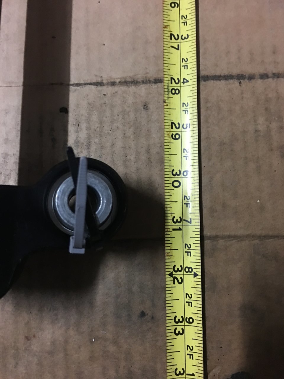

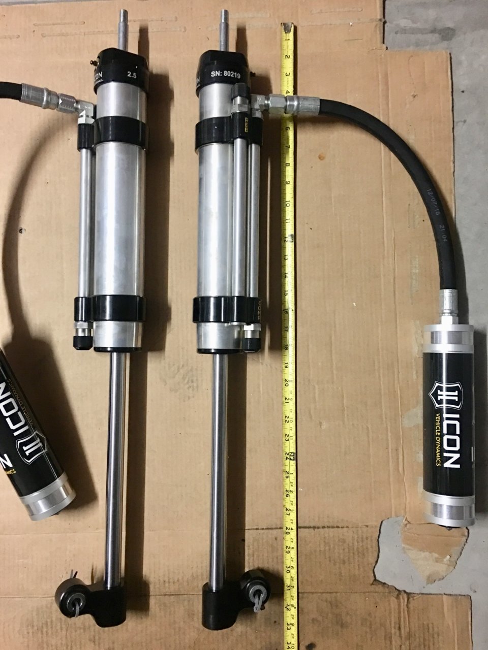

    Joonbug, can you measure the rear shocks for me please... I want from top mount down to the center of the bottom mount (hole), and then the body of the shock, from top mount. and the length of the exposed shaft, ( I know sounds kinky! keep it clean fellas! ) Thanks! How much lift will you be getting out of that leaf pack?

    The Icons are digressive and I believe Fox is linear. Don’t think you should mix them. Still need a measurement?

    Yes please, how about just 1, top to center of lower mount, thanks.

    From the very top of the threads to center of the mount is about 30.5”.

    Thanks Joon!! so, if you hook the top of the shock body, I am assuming that is the bottom of the top mounting position to the center of bottom mount, whats thats measurement? Looks like from photo its 2" down to that position.... so its like 28 1/2"....
