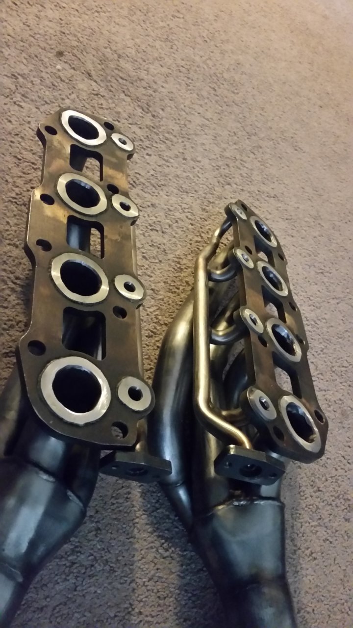

    So far JBA is being helpful, but there is not a scenario where I don't have to fully remove these headers again unfortunately. Basically they want me to send them back to CA for inspection. I have asked them to give me their inspection criteria so I can assess if its even worthwhile to send them back. I've also asked them to send me new gaskets. If I cannot detect any defects per their criteria, i may just give it one more shot. I suspect it will be either warped or not flat though.
    If that is the case i really need to have it back up and running ASAP. My truck was down for a month with the trans build. I cant wait 3 weeks without headers. In that case, i would really need to have replacement headers at that point. And I cant see any scenario where i am buying another set of JBA. So in that case i would have the ARH on hand ready to go if needed. Its a tough scenario and decision to make.
    The big risk would be trusting that the JBA are true/straight and could seal after the third time and not having the backup headers ready to go.(ARH are built to order from what I understand)

    Those look like a fucking 12 year old made them compared to the ARH's. What a Joke!

    That's pretty tough to look at for sure. I asked JBA about this and they said its perfectly normal. They really should invest in automated welding or throw these things in a CNC mill for finishing. Theres no reason finished welds should look like that.

    I’ve honestly never been impressed with JBA. I put them on my Silverado years ago and had nothing but problems. I had to replace header gaskets probably once a year due to leaks and had both of them crack at the collector at different times. The warranty was kind of a joke also. They discounted cost of retail which ended up being a couple bucks less than just buying new. Literally saved about $6 through “warranty” purchase.
    I told myself never again and the build quality hasn’t changed looking at the pics.
    The ARH’s look much better at the flange though.

    It’s crazy to see all these issues with JBA.
    I’ve personally installed over 40 sets. ZERO leaks. Zero need to redo.
    My shop foreman has personally installed over 2p sets. Same as above. Zero leaks. Zero issues.
    That said, when we started contracting headers installs to other shops, reputable shops in my area, nearly every set came back with issues.
    When you don’t tighten them down properly, they leak. Plain and simple. And every set that had the issues AFTER they weren’t installed by me or my shop foreman personally were thought to be a header quality problem by the third party shops that we use to contract with.
    That said, the raised port flange design is actually superior. Not inferior. It adds extra force specifically to the sealing face of the gasket. And having it thicker in some spots than in others doesn’t change that. The picture of the header which leaked, it was either a low spot. Or it wasn’t tightened down enough. And if it was a low spot, it would have to be a really bad low spot for it to leak because the raised flange design helps to seal up flawed flanges too.
    I wouldn’t sell JbA if their quality was poor. Hand built, yes. And they look hand built too. At least the part up against the head where you never see after they’re installed.
    Not only has my shop installed many many headers. But I’ve sold hundreds of pair of 6010 headers around the world since their inception. And my truck was their test/prototype set. I still run the very first set ever built on my truck with almost 100k miles on them. Same headers. Same gaskets. And never once re-torqued them, because it tightened them properly in the first place.
    I’m not posting to get into a technical argument over the internet. I’m just presenting my experience of having a major role in putting these headers in a massive amount of people’s hands. If there was issues I would be the first to tell people so my name isn’t attached to crap.
    These headers and their quality aren’t bad by any means. Matter of fact they’re very consistent and of great quality.

    I know you said you dont want to get in a tech argument, but things need to be addressed here:
    -Only if it is properly designed. This is not properly designed. Furthermore, in order to maintain evenly applied pressure, there needs to be an equal distribution of force. Each primary only has 2 studs, so there are only 2 direct points of applied pressure, not a uniform distributed load. in between those applied forces you will see (by calculation) that there is a variation in the stress in the flange due to strain in the material. This is the same principle behind why you see multiple studs surrounding pressure containing flanges. You have to properly design flanges to seal evenly. Have you ever utilized the extra holes in the header? I thought about that, but didnt want to add to an already painful install.
    And, superior to what? I would argue that MLS gaskets and flat flanges are superior. You hardly ever hear of OEM gaskets blowing out or leaking unless a stud has broken or backed off. There has to be a reason OEM uses this. It doesn't take long to pull up literally 100's of people having issues with JBA gaskets and quality issues.
    - This statement is not correct. Pressures is a function of force over area. This is a law of physics. Variation in area necessarily changes the applied pressure. Think of it this way. If a 100# lady steps on your back wearing tennis shoes, you prob wouldn't notice much. Now take the same 100# lady in high heels to do the same. You are def going to feel that more. This design would be improved greatly if the weld profiles were machined to a uniform thickness and radius.
    - We will find out shortly when i get these out. I would also point out that this is the port closest to the cab and also the most accessible. tightening was not the issue. Out of all these PITA studs to tighten, this was by far the easiest to get to.
    Finally, i would also add that the leaks are not terrible. They were only were detectable by low pressure testing the system for leaks. I just know that they will get worse over time and dont want to deal with it.

    Sorry, that JBA flange looks like an abomination. I haven't seen a header flange like that in forever. If the flange thickness has enough meat and it's flat/true post production there is no reason to to make a raised flange, it's a band-aid design.
    Side note, has anyone checked port match on these?
