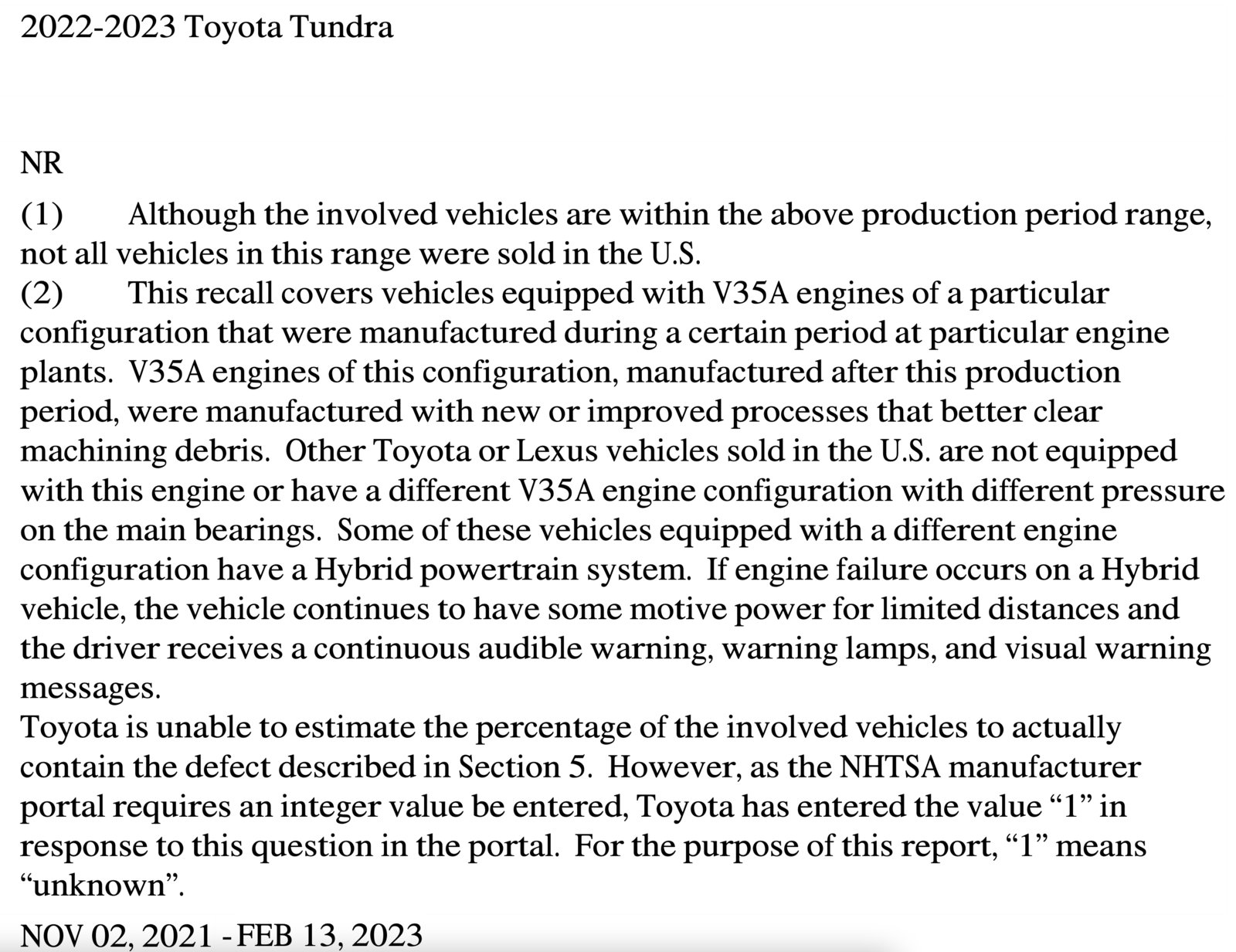

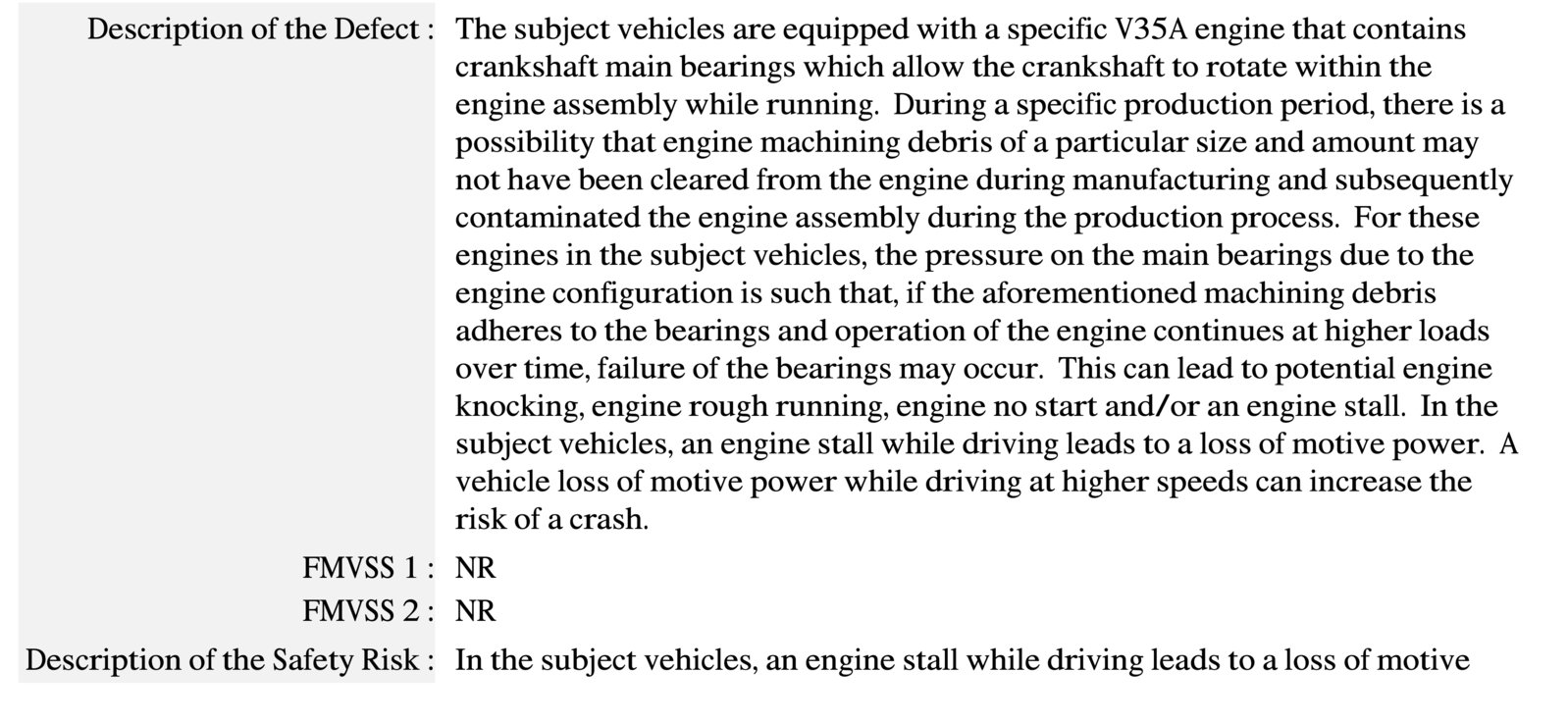

    o_O
    Cool man, it's been said so many times why Hybrids are not included in the recall - spoiler alert, not because they're immune.
    Or maybe I am misinformed and TRD Off Road PROs Hybrids like yours won't be affected.
    https://static.nhtsa.gov/odi/rcl/2024/RCLRPT-24V381-6004.PDF

    That little device is the anti-kaboom device they only added to the Hybrids.
