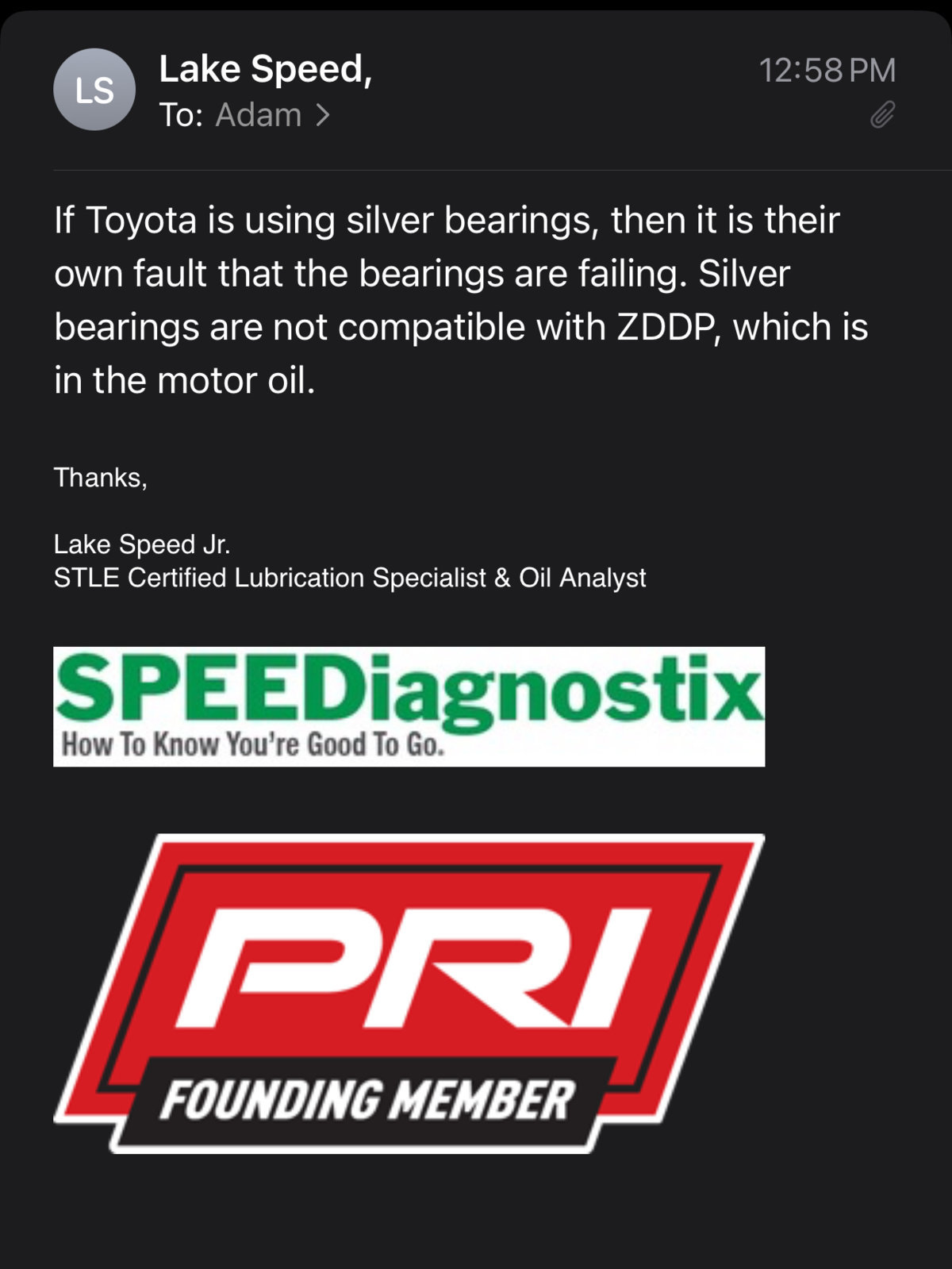

    Exactly the point I was making to AZ. ZZDP is an anti-wear agent and the zinc levels we see are normal based on the oils we use, as noted in the analysis reports.

    You would think ZDDP having an issue with silver bearings would cause the problem with the other bearings as well and just not #1 bearing and to a lesser extent #3 bearing.
