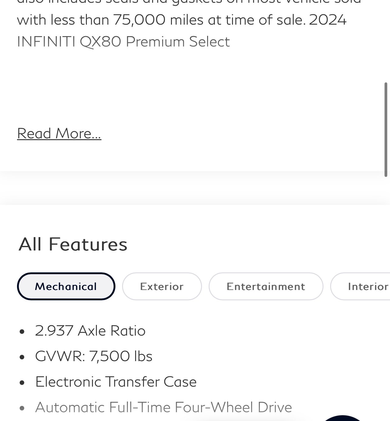

    They still using 2.55 axle ratio?

    2.937
