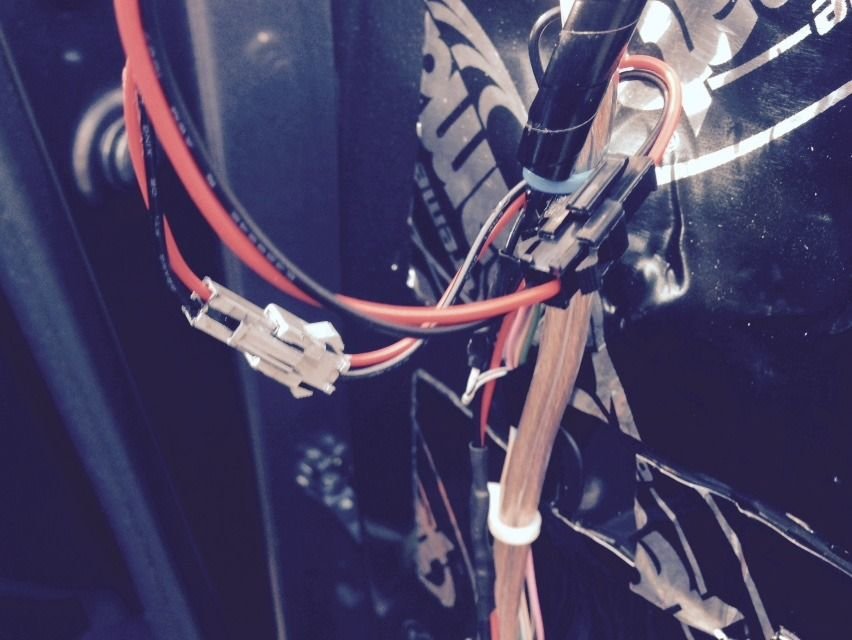

    Do you fellas also have push button start? I just realized you mentioned they’ll come on as you approach the truck with the key in your pocket.
  18. Mar 19, 2021 at 8:58 PM
    #78
    1lowlife
    May 4, 2016
    #3296
    11,134
    DADA
    THE GREAT STATE OF TEXAS
    2014 MGM DC SR5
    Same for my 2014 SR5 custom puddle lights that I tapped into the footwell light.
    Unlock doors with the key fob, puddle lights dim up.
    Get in the truck and close the door, they time out and dim off.
    Open the door to get out, dim on, close and lock the door with key fob, they dim out..
    VLEDs are the way to go.

  19. Mar 20, 2021 at 6:26 AM

    You can pull one end off the grommet, I pulled the one to the body, and put it back in when you're done.
    Pull the end off, try to compress it, and shove a long stiff ziptie thru it.
    I used an HVAC zip tie.
    Once you get the ziptie thru, securely tape your wire to it and pull it back thru..
    I would go in from the truck under the dash to the door, then pull the wire back from the door to the under the dash.
    Going from the door to the dash is harder..
    Also you can use the 3 foot HVAC zip tie to pull the wire from the passenger side to the drivers side in the dash.
    Run it thru from the driver's side, secure the wire, and pull it back thru.
    It might take a little bit of poking here and there to get it thru...
    These are nice to have around, I use them for different stuff all the time..

    I also put connectors inline at the mirror plug in case I, or anyone, ever have to pull the mirror off..
    One connector for the puddle light and one for my Muth signal mirrors
