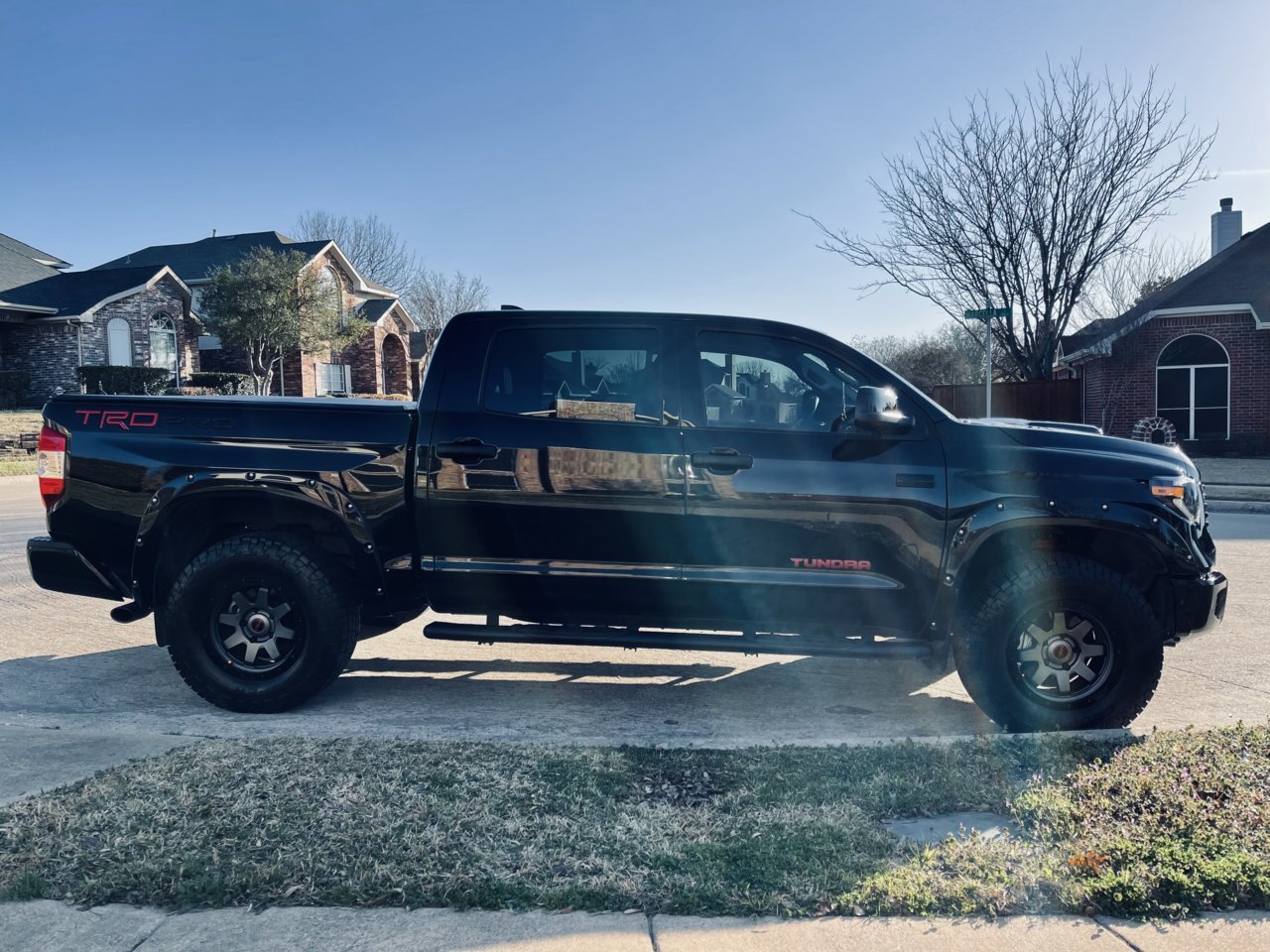

    Just installed the shackles and the ride is improved, but bed bounce on the freeway remains. Only thing that has ever made it go away was if I towed my boat. I will get new tires eventually, either D or maybe E in a better manufacturer. If that doesn’t help the bed bounce then I’ll just live with it.

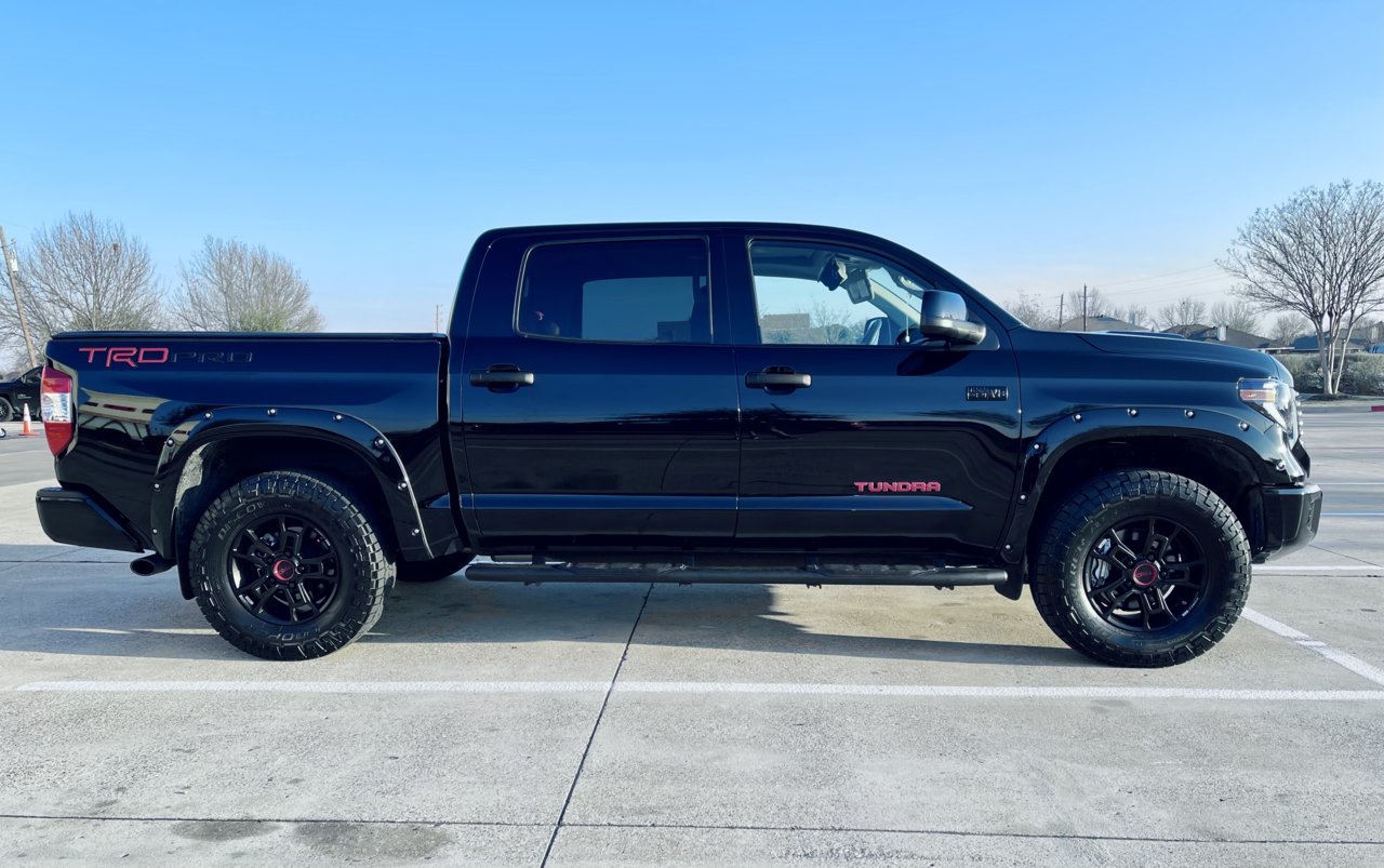

  4. Mar 6, 2021 at 4:52 PM
    #64
    DadduMan
    DadduMan New Member
    Jan 8, 2021
    #57323
    68
    2021 Black Tundra TRD Pro

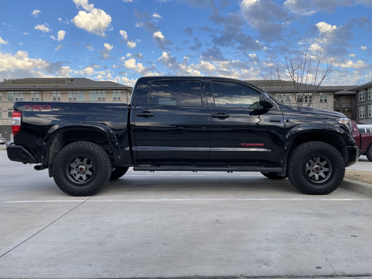

    Perhaps a better shot of the rake. ;):thumbsup::rolleyes:
    I lie. Just wanted to share another shot! :D
  5. Mar 6, 2021 at 7:16 PM
    #65
    R0CKETMAN
    R0CKETMAN IG: @rocketmanmtb
    Mar 24, 2017
    #6931
    540
    NGAMTNS
    '17 TUNDRA TRD PRO CEMENT ‘15 TUNDRA SR-5 WHITE
    You’ll get a lot of hate with that rake around here. They prefer front rearward rake when you put a six pack in the bed:rofl:
    Pbed85 likes this.

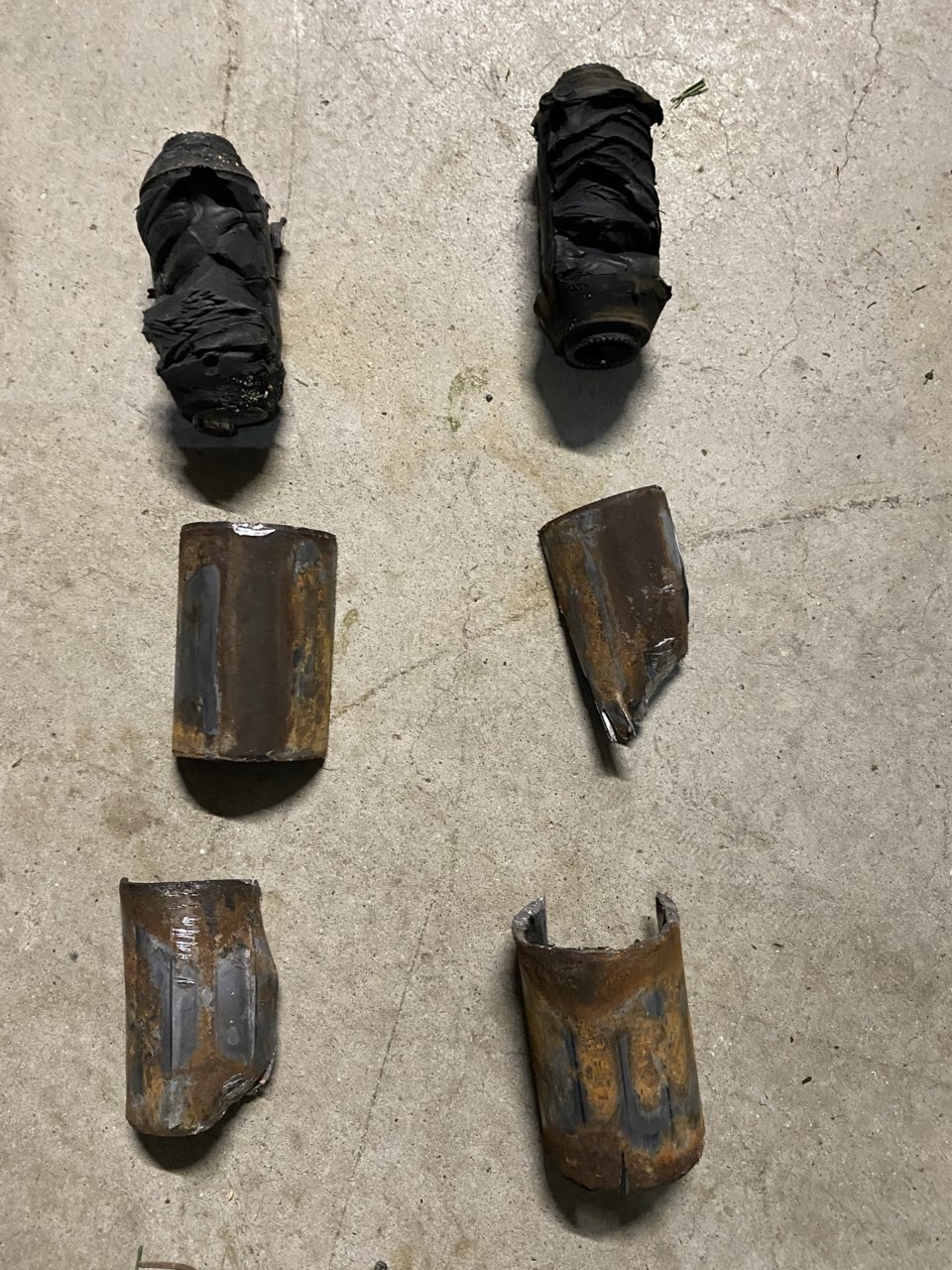

    I need help team! I bought +2 shackles, and can’t get the bolt out where the passenger side shackle connects to the leaf spring. All the other bolts came out fine, but this one seems seized in the bushing. I’ve jacked it up in different directions, pounded with a sledgehammer, took a torch to it to try and heat up the outer part. I tried to cut both ends of the bolt/shackle off, but my sawzall blades died. My plan is to get better blades and see if I can cut them off. I live in Colorado, so not a ton of salt/corrosion. It’s a 2016 with 96k, so a little older. I’m at a loss at this point. I can’t wait to try and press out the OEM bushings... any help is greatly appreciated! Thanks, John

    Thanks for the reply! It’s the bolt, the nut came off no problem. I’ve taken the top nut off the shackle and pried at it, and it comes out no problem. So the top nut/bolt are loose. I’ve had the nut off and also retightened the nut on the top shackle just to see what happened. Just trying any option. Thoughts? Thanks?

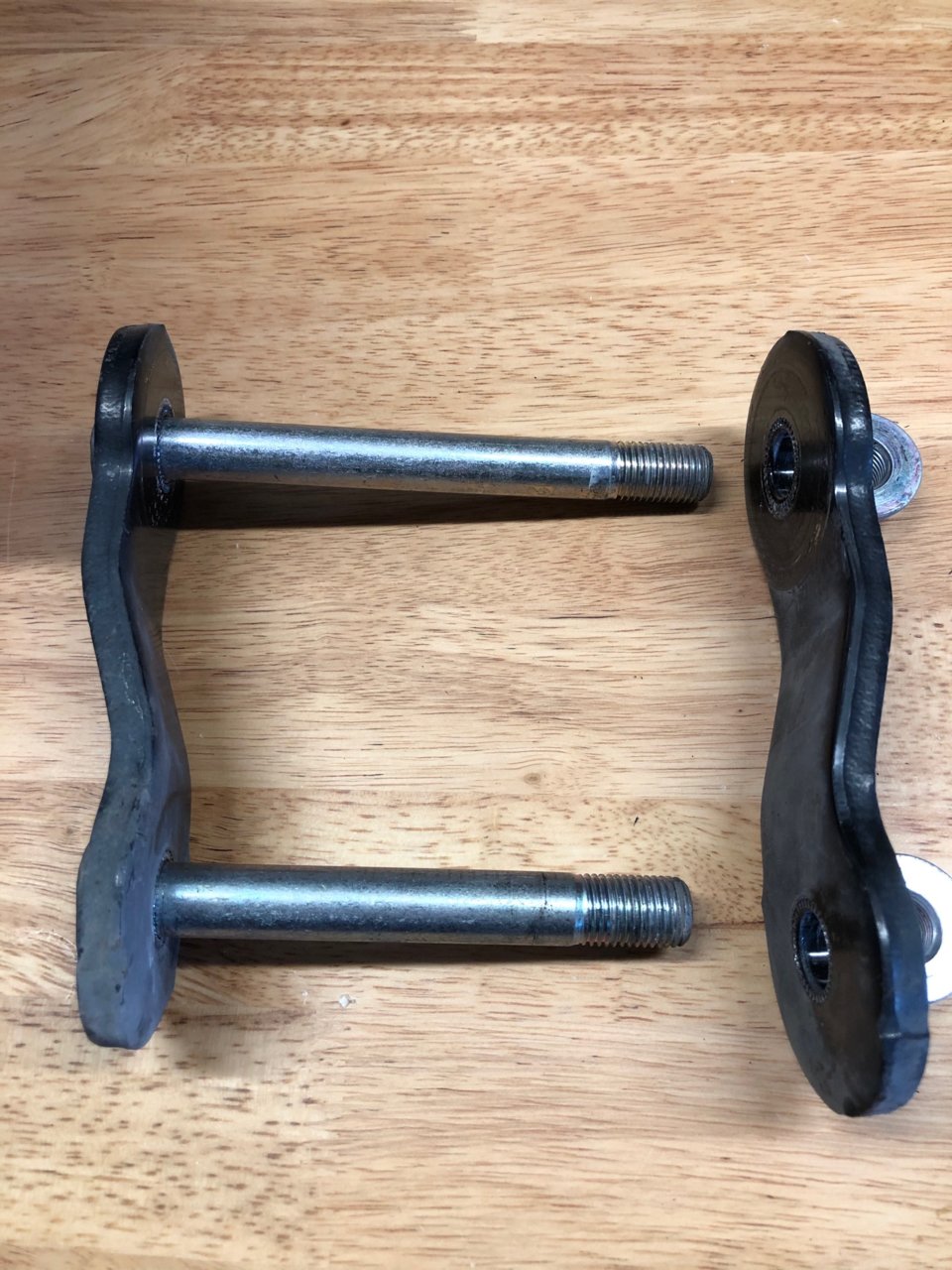

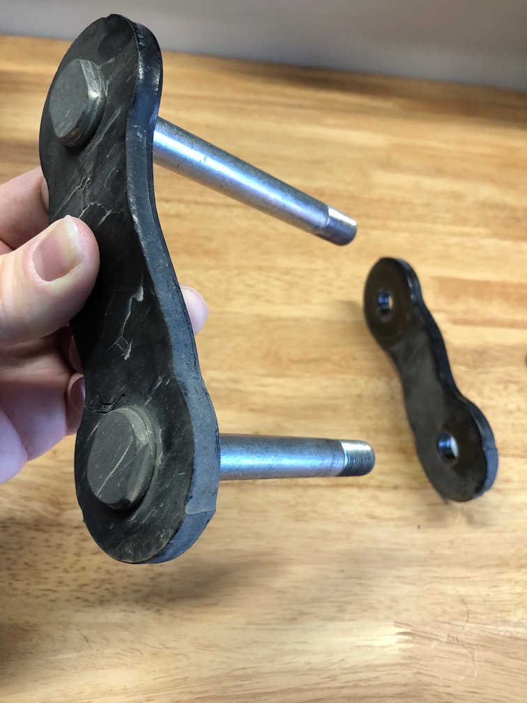

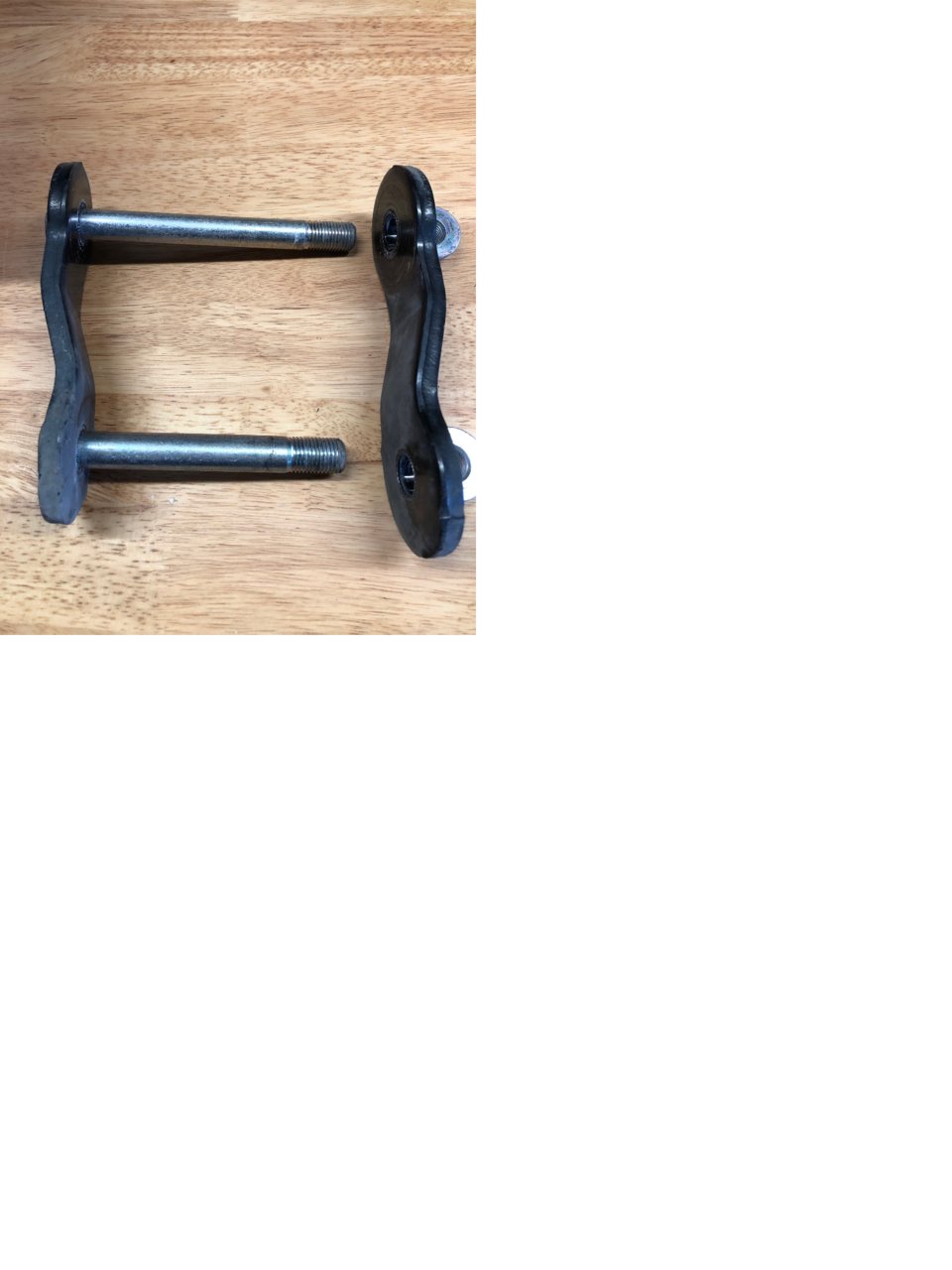

    So, the OEM shackle is a 2 piece part. One piece is a single side plate and the other piece has the bolts attached to it:
    Were you able to get the side plate off as shown in this pic?
    In order for the EOM shackle to come off, you will need to take the load off of the leaf springs and the shackle. You will need to drop the axle to full droop. Watch your brake lines when you do. If necessary, you can remove the small bolts holding the brake line to the axle. This will give you more room to drop the axle.
    Once the side plate if off and the axle is at full droop, you can tap on that bottom bolt with a hammer. For me, the bolt side of the shackle came right out.
    If necessary, you can pull or pry on the bolt side of the shackle while you are banging on the other side with a hammer:
    Let me know how it goes.

  13. May 19, 2021 at 6:18 AM
    #73
    Netmonkey
    Netmonkey [OP] Don't be a Dumbass
    Mar 21, 2016
    #2971
    1,473
    Georgetown, TX
    2016 Texas Edition, 5.7, CM, MGM
    Icon stage 2 lift, 295 60 20 nitto ridge grapplers, fuel kranks, TRD dual exhaust, TRD rear sway bar
    I am not sure how a ball joint press would work in this case. The back side of the bolt is plate where the press would be sitting.

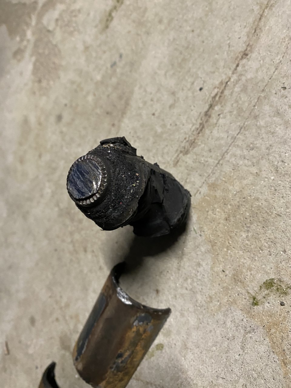

    Well that was fun. The bolt was completely seized in the bushing. The bushing was completely seized in the leaf spring. If your truck is a little older and has some miles on it, pay someone else to do it! Tonight the new shackles go in!

    wow... that is crazy. now you can actually do the install :)
