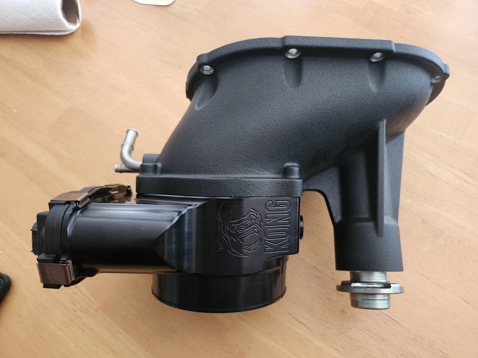

    Now I need to make a new intake!

    Grab a nice 5 inch intake and weld a few bungs and your good to go.
    Do it! :D

    I've already got most of the supplies I need, but I wasn't sure about the throttle body coupler size, got that ordered yesterday.

    OH MY! What size TB did you go with? Kong makes good stuff.

    It's a 103mm, just blaaaaack
