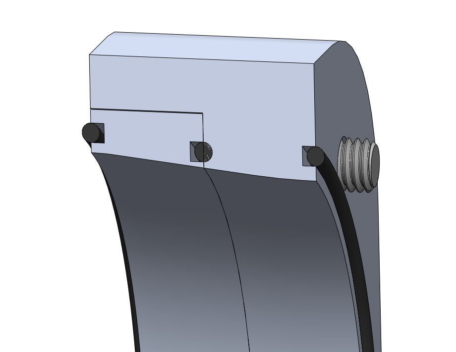

    Sent this to the machine shop today: custom TB adapter for @reywcms Whipple
    This one required a little creativity since Rey wanted to run a 103mm GM throttle body, and that diameter ends up overlapping where the bolt heads for the supercharger interface are. To fix that I sunk the bolt heads deeper into the spacer where there's clearance because it necks down for the Whipple slightly. An insert plate then seals where the Whipple bolts go so the transition can remain smooth and keep a normal O-ring seal with the throttle body. And as with all my throttle body adapters there's a gentle transition where the airflow enters straight and exits straight with a radiused change to attempt to keep the airflow as laminar as possible compared to a straight cone shape.

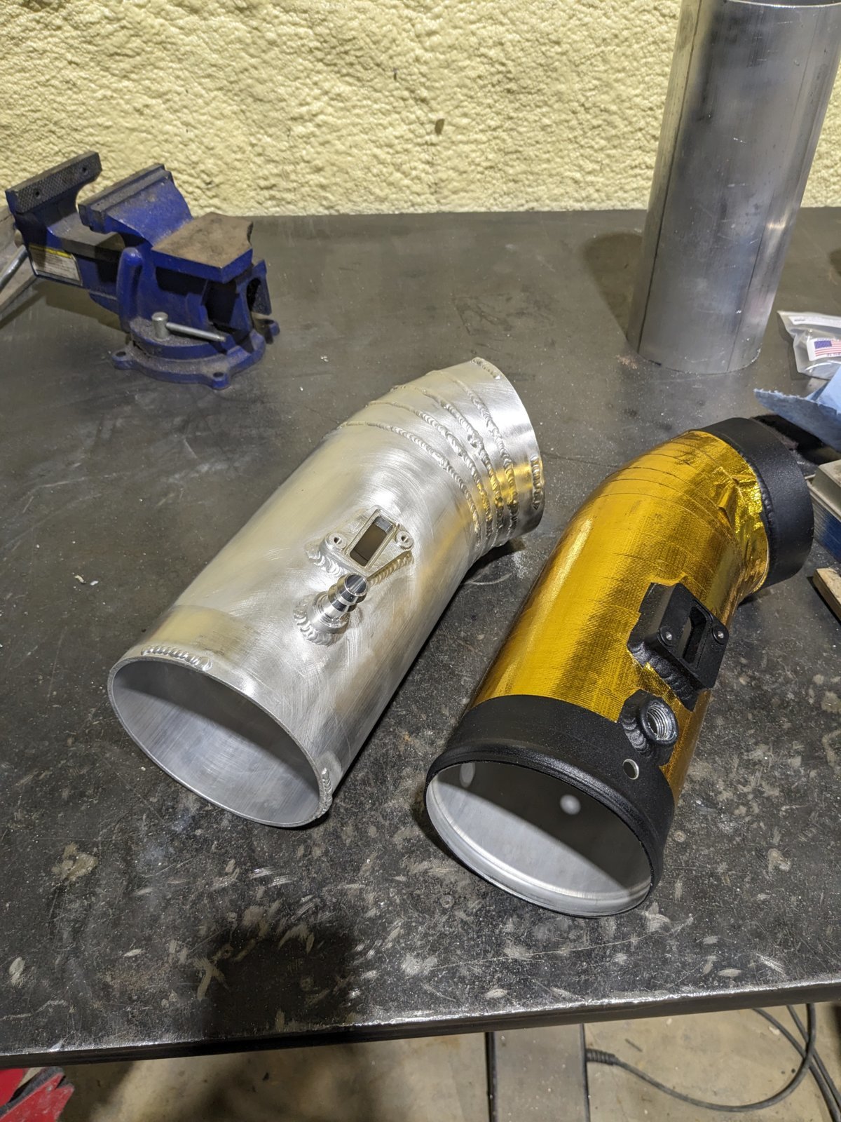

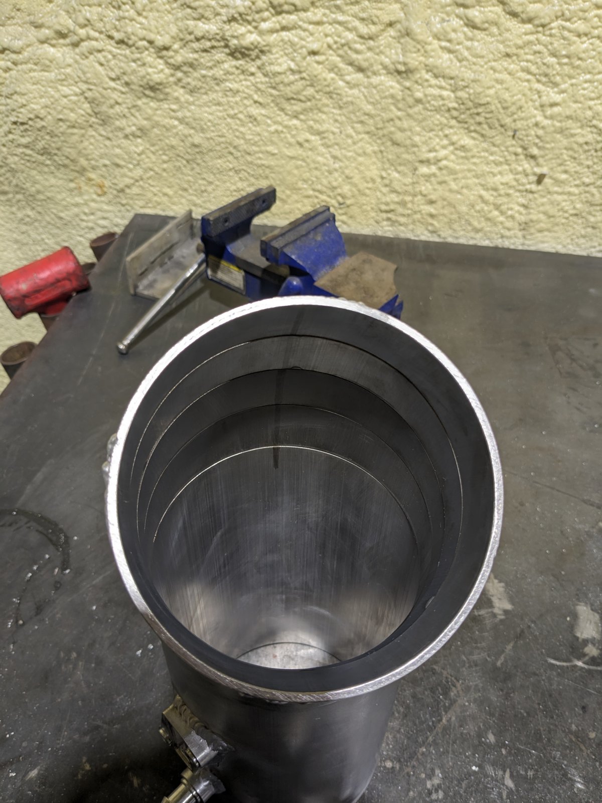

    Finally got @reywcms 5" intake tube made! $100 of materials between the aluminum and the MAF bung, and a couple hours cutting/prepping/welding. It actually turned out really nice I think, I wasn't sure how I was gonna go about the 40deg angle initially, and decided to do 5deg cuts on the band saw which was the perfect idea. Each cut is 5deg, so the main body and the initial stub where the hose clamps to only have a single 5deg cut, and then the middle pizza pie sections have a 5deg cut in each face for 10deg total. That ends up being an even number of cuts total to reach 40deg, and since each cut is the same angle it means each cross section is the same so everything lines up exactly. The seams inside the tube are extremely flush considering I didn't post process them at all.
    I then drilled a hole for the crank vent hose, as well as four holes and then used the jig saw to make a slot for the MAF and cleaned those up and welded the bungs on which went great! Finally I welded 4x pretty blobby welds on the ends of the tube to act as a lip for the hose clamps to grab onto since I don't have a way to flare the ends.
    Rey sent me his old tube for reference and we talked about what features and changes he wanted to incorporate. Pretty simple overall since this doesn't include the intake box, but cool to be able to make a custom component like this and get an excuse to weld aluminum which is one of my favorites!
